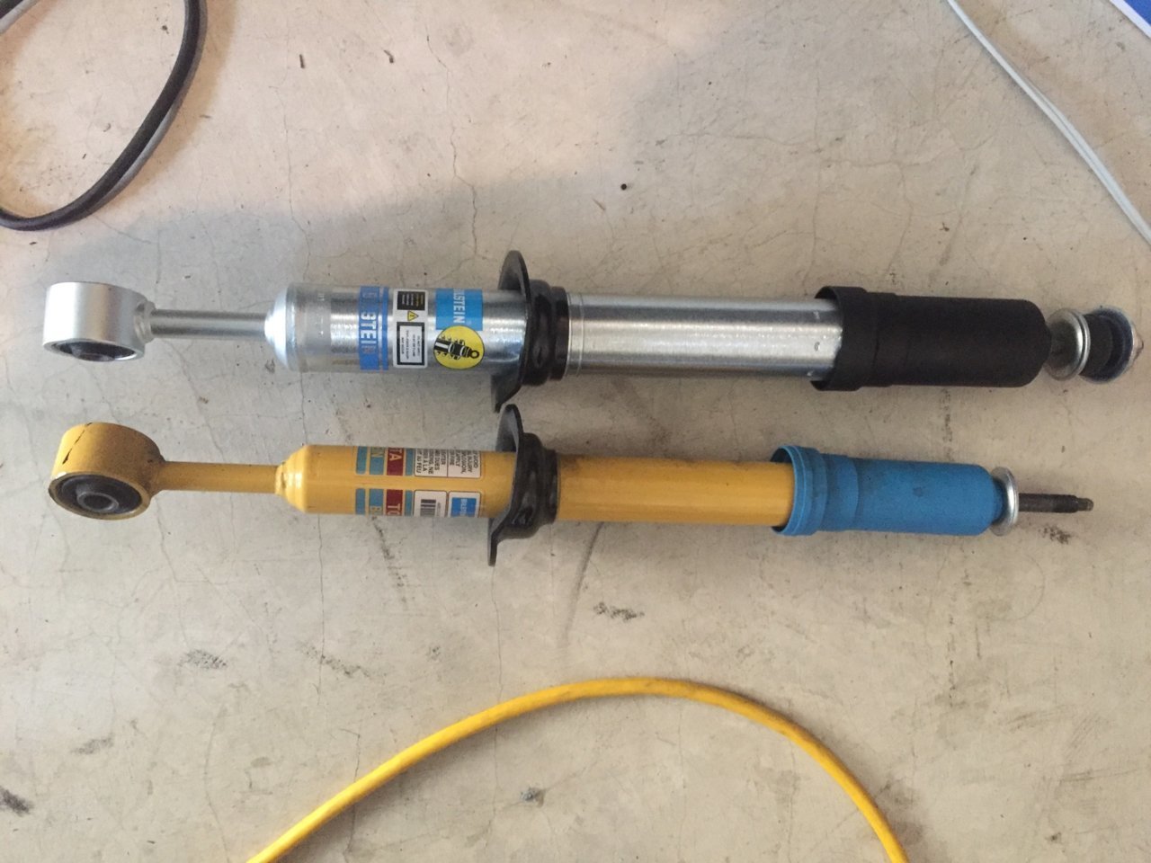

    ok so there is a hiccup with the Eibach springs... the top hat ID for the tundra is 3.5" vs the eibach spring is 3.0"...
    TUNDRA spring ID is 3.0" on the bottom and ID 3.5 on the top.

    You are talking about your 6112 springs right (not the same as stock Tundras)? Bilstein recommended Eibach springs but didn't mention this? Have you looked into getting tophat bushings that will fit?

    yeah the 6112. though the 6112 reuses the stock top hats
