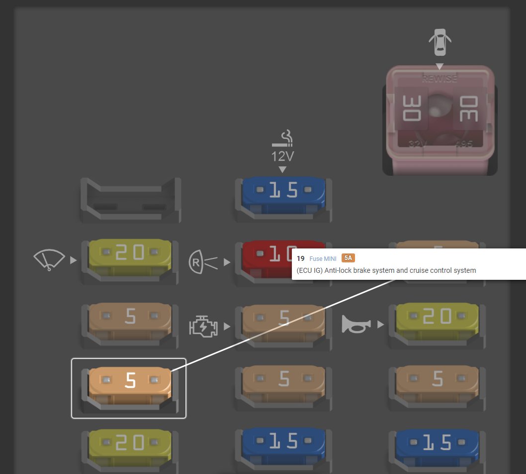

    ... or a blown fuse?
    I guess the vehicle wouldn't run, but I was digging and it looks like his vehicle has an "ECU-IG" fuse in the dash, and maybe an "ECU-A" and "ECU-B" fuse. Pic below from interwebs. I'm too lazy to look at EWD.
    But I gotta ask also @Yota02, if you live in the rust belt, or if you've ever had a cracked windshield, have you looked INSIDE the ECU to confirm there's no water damage inside? I'm not asking you this for no reason, let's just say it's happened once or twice.

    Fuse for sure too. I tend to forget to mention them since it’s just habit for me to start there

    I did check for power per the FSM ECM power check, but it did not have me check grounds. I'll do that next. I'll get back on that.
    I did remove and open the ECM and there is no obvious damage or evidence of water intrusion.
