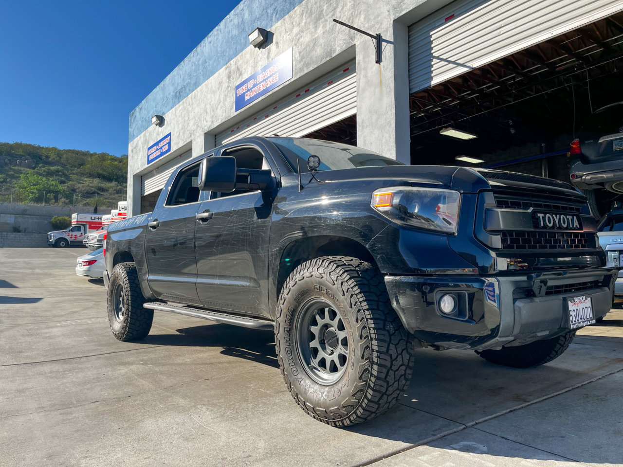

    She rubbed pulling out of the bay haha. Definitely have my work cut out for me.

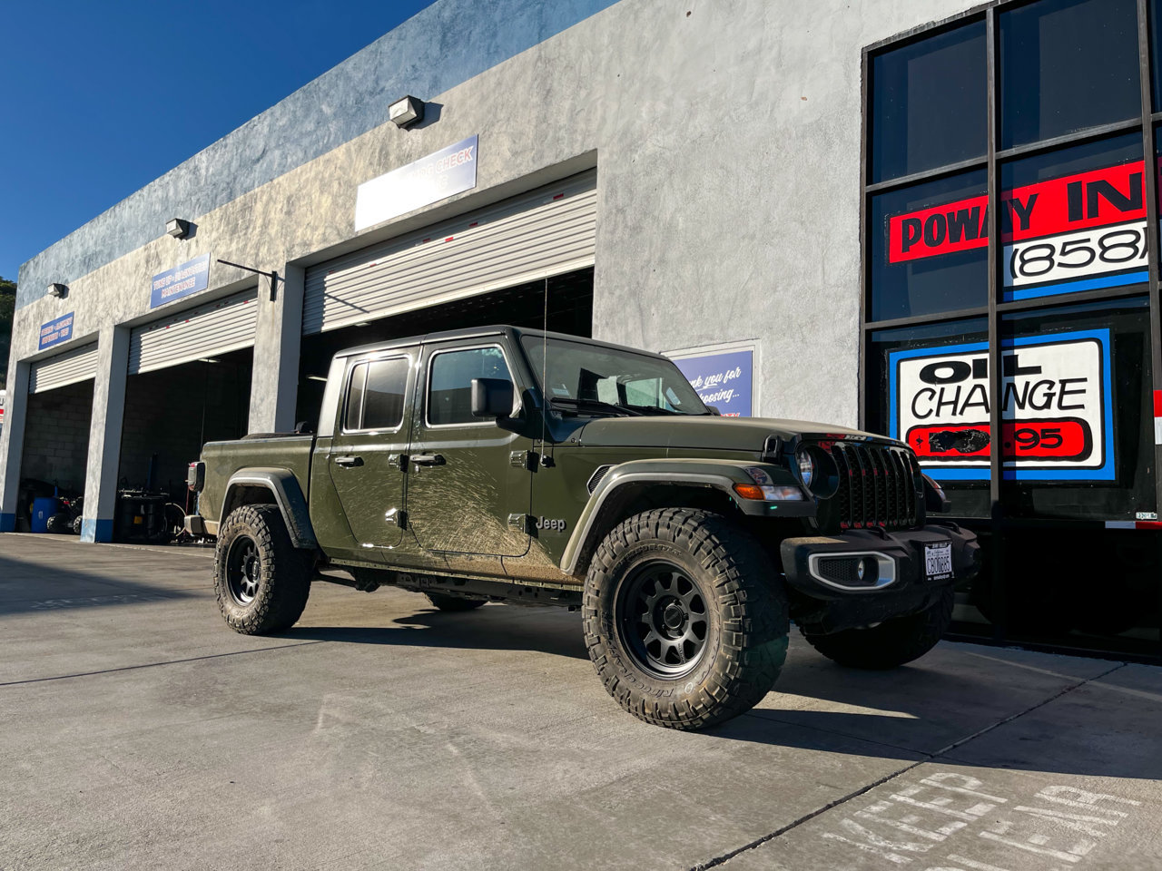

    And my old tires on Bre’s Gladiator.

    Both looking good

    so where are they rubbing?

    Ahh… so naive. The correct question is where aren’t they rubbing :rofl:
    I’ll need to investigate. Been a busy day and now hours behind schedule helping a friend with his truck, so headed there. Then maybe by tomorrow afternoon I can get my head under there.

    lol yeah everywhere... they do look good

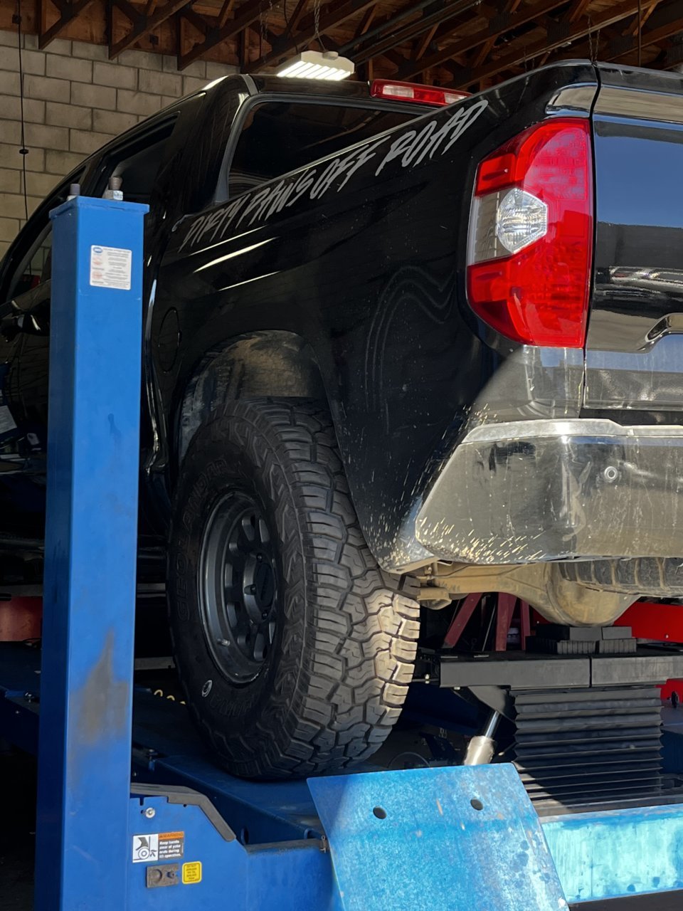

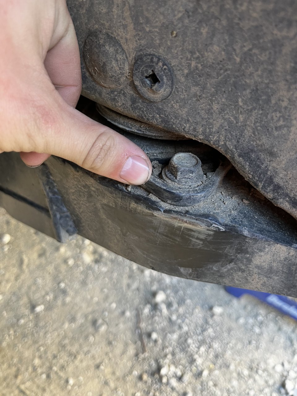

    Alright, current issue is the cab mount. Tire is rubbing all the way to the mount behind the CMC plate.
    Next steps: schedule an alignment and see how much caster I can get for now. Going to need some new UCAs with added caster.
    Cut a lot out up front, but going to need to drive more to see where else I’ll rub up front.
    Also need to hit some dips and see how much of the wheel well rubs under compression.
    :thumbsup:
