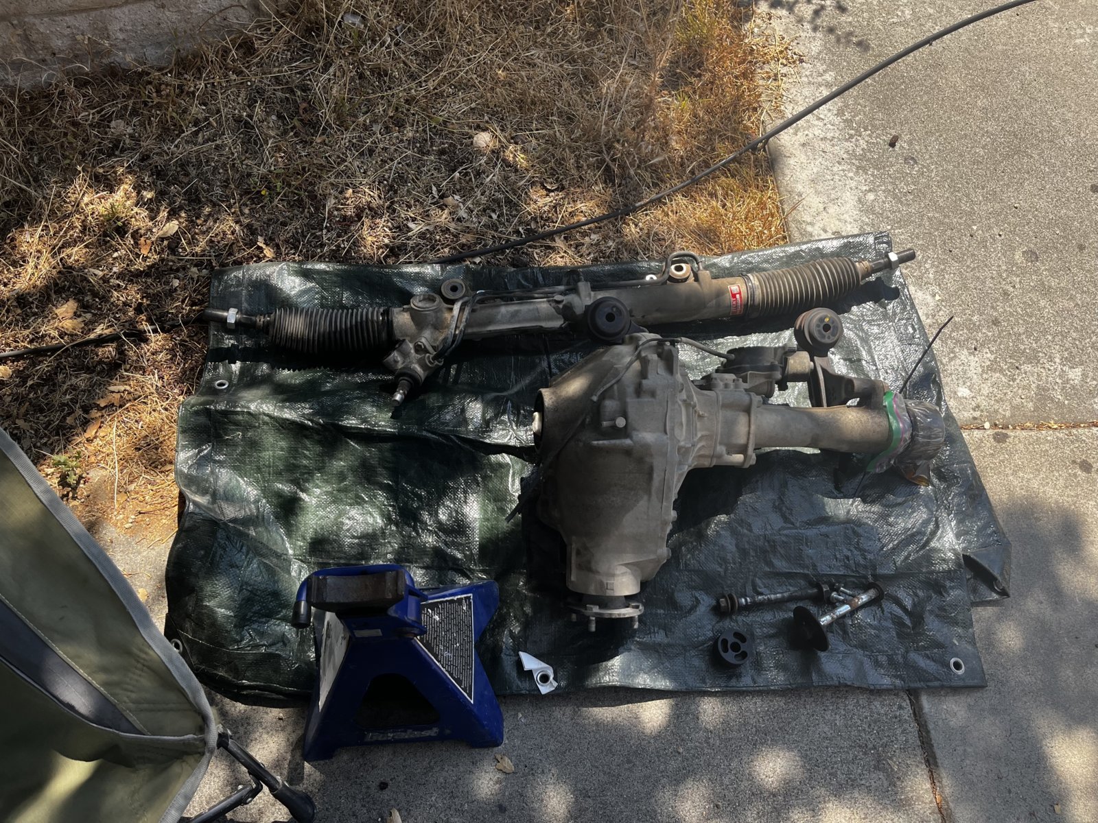

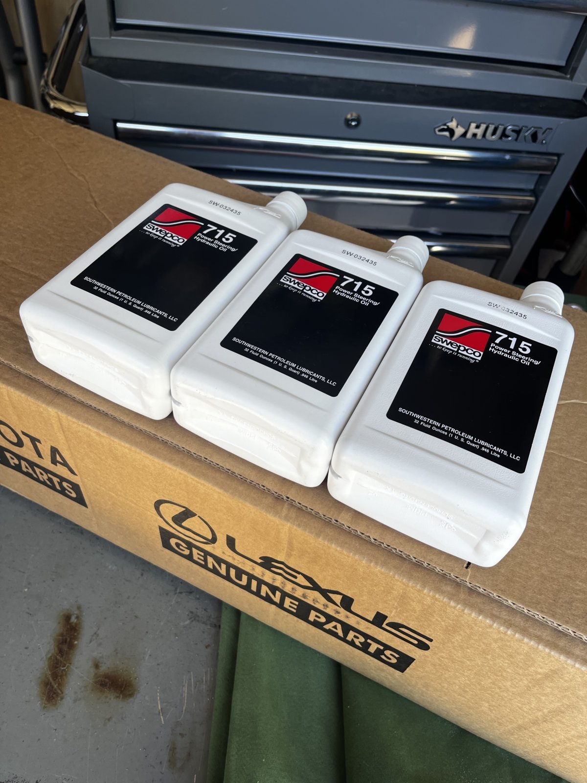

    So my steering rack decided enough was enough and puked its fluid and quit. I’m guessing a late result from my encounter with a boulder. Thankfully was able to find one at Toyota Carlsbad, picked it up this AM. Consulted with the guru, Bruce, and picked up the recommended Swepco PS fluid. Tomorrow @tundra_20 is yet again lending me his help to get this swapped out!
    Moose helped to keep it safe on the drive home haha.

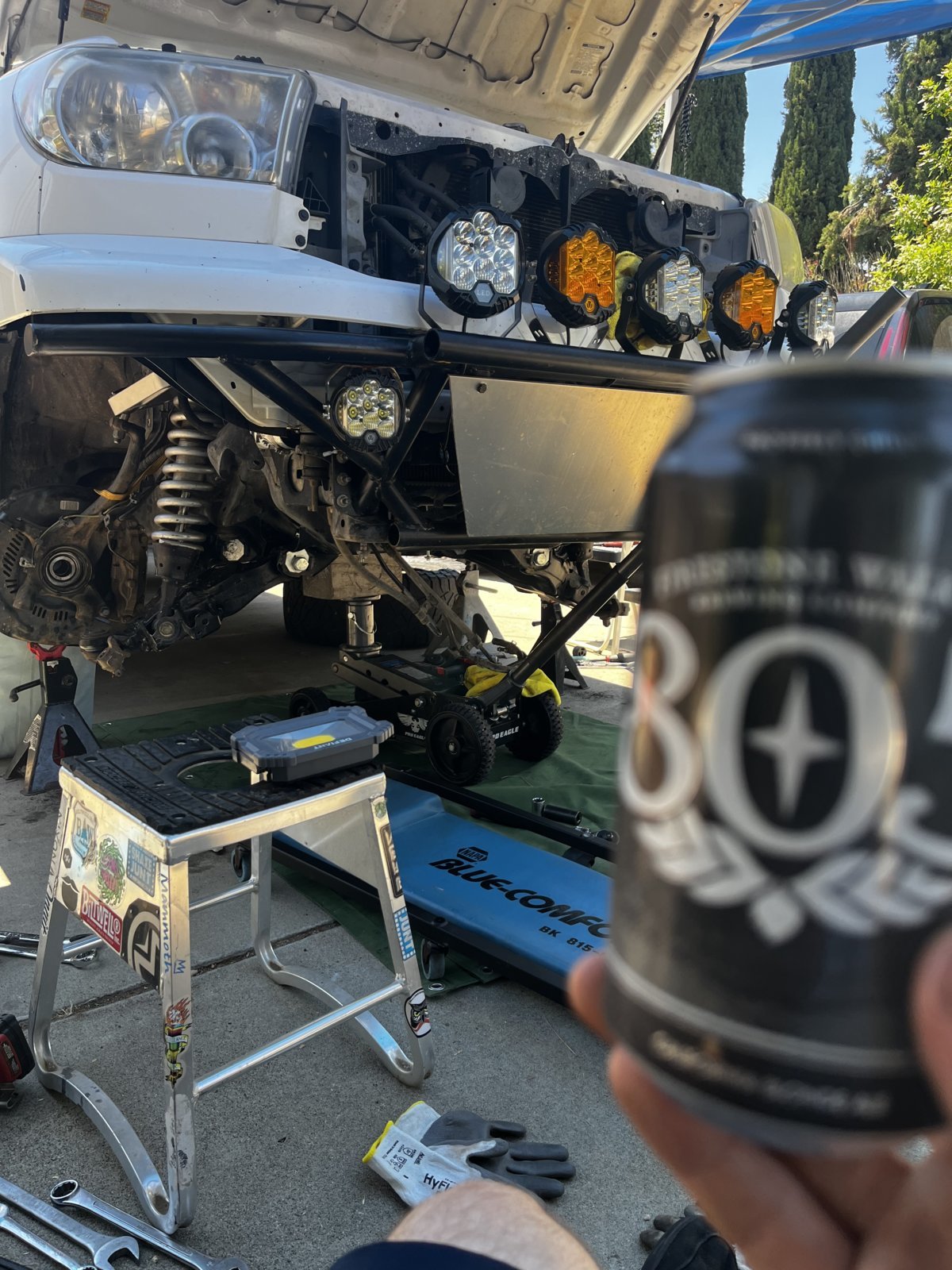

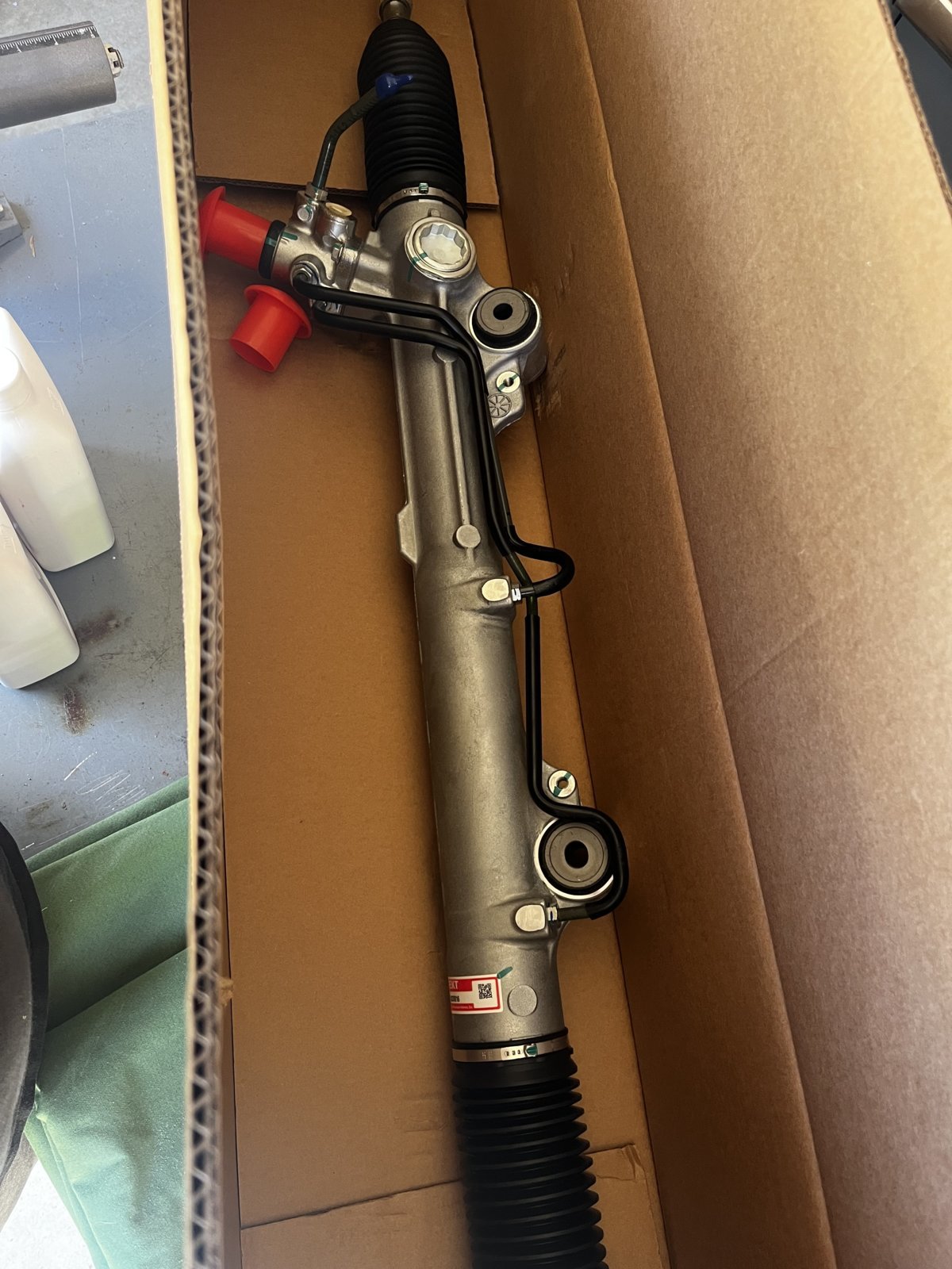

    Made a little progress so far:
    I just knocked the stock bushings out of the new rack. Not bad at all on a table and being new. I’ve read doing this under the truck with worn parts is a nightmare and I can see why. Those things are press fit so they’re awfully snug. But that step is done and prepped for the new poly bushings.

    For real! Every time I had doubt I was like “I watched this get done in the dark in the dirt, we can do this!”
    It was hard! But we got it done. Also while the diff was out we tossed on my Solid motor mounts, so that got done as well. When I get up I’m going to go give it a once over, make sure it’s buttoned up, and then take it for a test drive.

    Test drive successful :woot:
    New 44250-0C160 steering rack installed.
    CB/ES poly rack bushings installed.
    Solid motor mounts installed.
