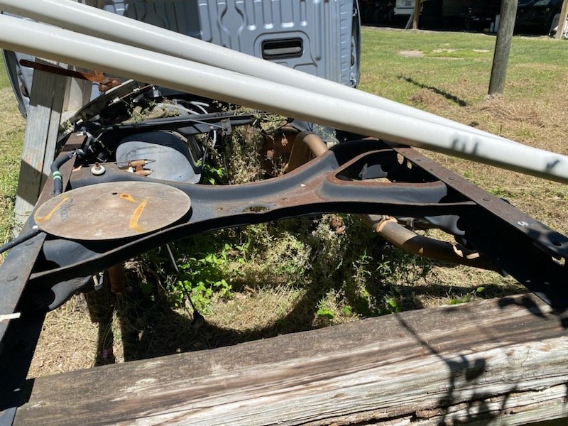

    Just how wrinkled is the crossmember on the replacement frame? The cross' does kinda hang down and can be susceptible to damage, but the frame brackets that it bolts to usually will bend first (but they can easily enough be bent back into shape). Makes me wonder how the cross got damaged. It would be VERY difficult to conclude if a bare frame is bent or not. And if the frame is rusted on the 4wd truck, chances are all the suspension bits will be as well. Does the bare 2wd truck frame come complete with suspension? I don't know where you're located, but if you're east coast/midwest, it might be difficult to find a rust free frame locally. Out here on the west coast (i'm in oregon) clean frames can be found without too much fuss.
    EDIT: when i said that the crossmember is susceptible to damage, i was thinking it was the transmission crossmember, not the engine crossmember. It takes a very hard hit to damage the engine crossmember!

    I'm in Fort Worth but the truck I bought is in Houston.
    Pics of the replacement frame he is trying to sell me...

    So he’s trying to sell you scrap metal then. This is the average price for a 1st gen frame here in oregon.

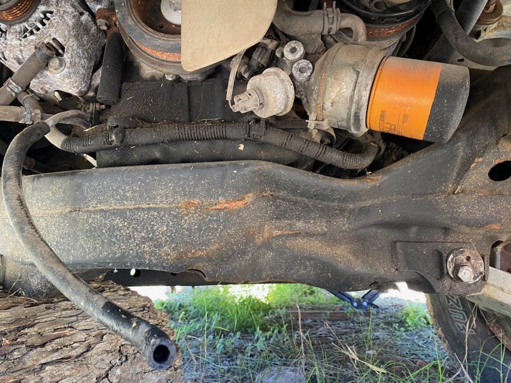

    Recently purchased an 02 AC TRD, thought I'd checked it out pretty good, but found doing UCAs. Look under your splash guards, passenger side. AC drain cause?
    Called dealer, blew me off, expired. Emailed corporate, no 'recalls' outside warranty. Filed NHTSA report. Called corporate, told to take to dealer for evaluation.. guess we'll see from there. Otherwise planning to do the frame cap from autorust.
