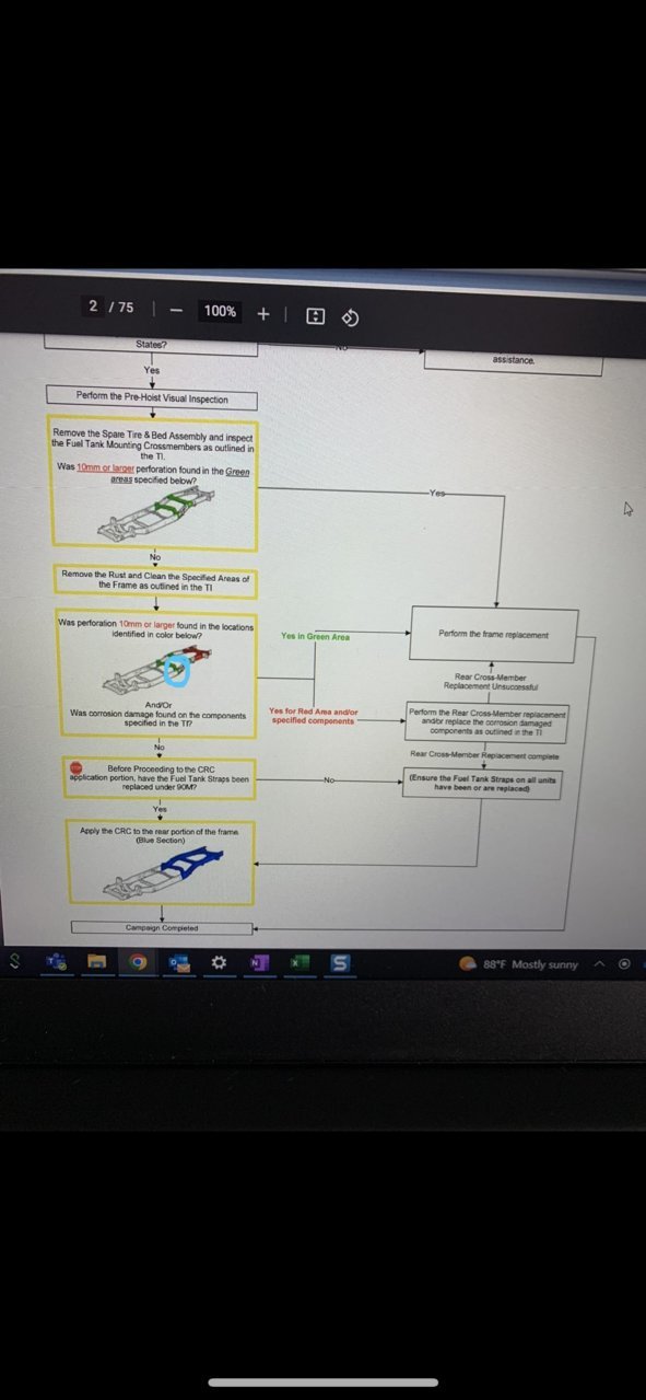

    Alright guys so I got this Tundra from my grandpa for a good price. It’s an 02 with 65k miles on it. Body is completely rust free. Interior immaculate. Everything well taken care of. Only downside you ask? He lived in MN. I’ve started to scrape and treat the rust up front but I haven’t touched the rear frame because it’s never had the CRC applied. The recall is still open on it because grandpa had it serviced in ND which apparently is not a cold weather climate state therefore they never did the CRC.
    My question for the hive mind is the cross members in green and red look great. But the mounting locations on the frame are rough. This spot is the worst of them, and I’m wondering would this constitute a frame replacement? This is the area circled in blue on the diagram.

    One member stated that the frame recall is over but not sure if that is true or not. Get some pics of your spare tire crossmember mounting locations. That's the spot that really matters nowadays. Regardless it would probably be good to just go ahead and take to your dealer and have them inspect.

    So I talked to my friend at Toyota in recalls (which is where I got the diagram) and he talked to a guy who handled some of this major frame recall, and they said the recall never expires because it’s a safety recall.

    I've heard the same thing as well. Recall exists now because of the worry of the spare tire crossmember rotting off and causing a hazard in the road.
