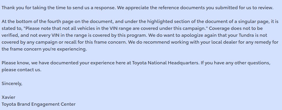

    • YET - when I try to look up recalls by VIN, nothing comes up. This is where the dealer said he couldn't help (said BXD shows as not open, and 90M is not applicable for VIN) and I'd need to get Corporate to figure out if my VIN should be eligible. When I ask corporate, they just say that recalls are "by VIN" and to beat it essentially (even asking multiple times "why" it's not eligible).
    Has anyone ran into this or know how to proceed in getting either Corporate to acknowledge eligibility or a dealer to work on theirs even though it doesn't show as eligible in the Toyota recalls database? I really only planned for this to be short term beater, but I'd LOVE to give this thing a second life if possible - everything else on it is really quite solid. Thanks in advance!

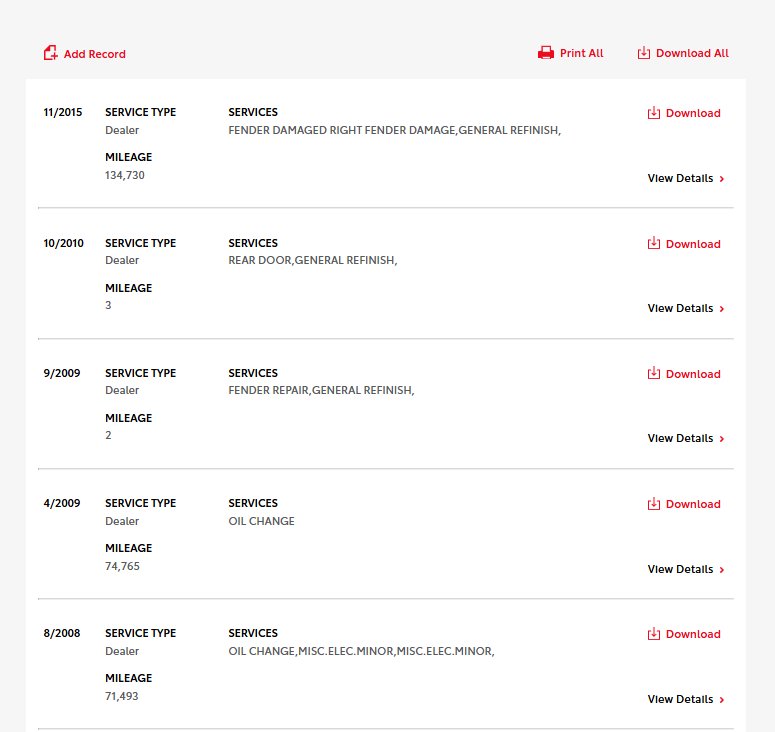

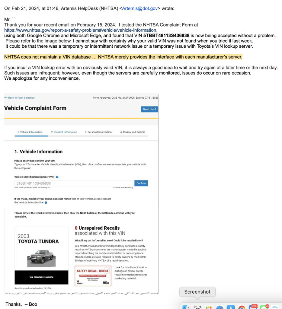

    I've attached a few relevant pieces of information - Toyota owners recent service history (just since ~08 as I couldn't fit anything older on one screen but no frame stuff before), response from corporate

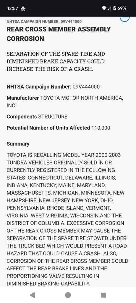

    The reason why you are seeing no recalls on the NHTSA website, is because they are simply a web interface for the auto manufacture. They do not store all Auto Manufacturing Defect Recall Information within their database. They simply regurgitate what the Auto Manufacture shares with them.
    For example as you have read here on this Forum, and within this thread, there are folks that have had the frame coating applied according to the Original Toyota Tundra Frame Recall, and their Defective frames inevitably continued Rotting away.
    And as far as Toyota is concerned, they will Intentionally & Falsely claim they have done their part to remedy the Frame Defect by documenting 0 Unrepaired Recalls for that specific Tundra VIN and that information then gets regurgitated through the NHTSA website.
    Early 1st Gen Tundras (2000-2003) did have a recall and within it gave the directive for Frame Replacement and keep in mind Toyota avoided doing frame replacements because it would’ve cost them millions upon millions of dollars.
    https://static.nhtsa.gov/odi/rcl/2009/RCRIT-09V444-6633.pdf

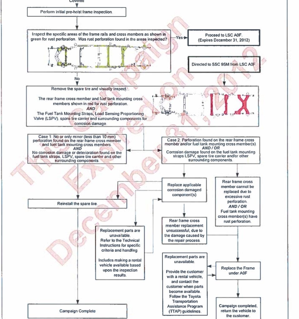

  6. Feb 4, 2025 at 1:02 AM
    #306
    MontanaDoc
    MontanaDoc New Member
    Mar 8, 2019
    #27307
    12

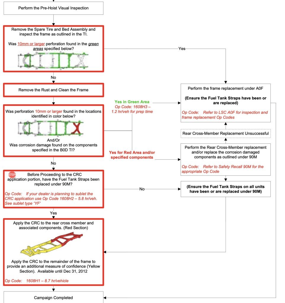

    Greetings Monty @MontysTundra
    Iowa is on the List with regards to the Original Toyota Tundra Frame Recall
    Please be aware of the following: The Safety Recall of the Metallurgically Defective Manufactured Frames by Toyota of the Early 1st Gen (2000-2003) Tundras:
    Had several different names: Limited Service Campaign AOF - Safety Recall 90M - Safety Recall BOD - Safety Recall BXD and perhaps there were more... Link below.
    https://tinyurl.com/mwxc7bu3
    Where the Vehicle was Registered and Where it ends up Does Not Matter as long as you can find a State Listed on one of the Safety Recall Documents pertaining to where the Tundra is currently registered - Feel Free to Verify that with an Attorney

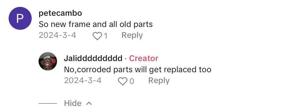

    Notice the following Recent Example of a Dilapidated 2000 Toyota Tundra that was registered in New York for most of its life and then found its way down to North Carolina and recieved a Free Frame Replacement - March 2024 - All Free...
    March 2024 - All Free - Jalid Guerrero - USMC Reservist/ Fred Anderson Toyota Mechanic - Sanford, NC. - posts a Tik Tok Video entitled "Rust Belt Tundra gets its Frame Replaced under Warranty !!!" (link below) taken from the Toyota Dealership Service Bay about a Dilapidated 2000 Tundra that was granted a Free Frame Replacement - All Parts and Labor Free - and in this case as others - A Free Tundra Rental is offered while the work is being done at the Toyota Dealership.
    https://shorturl.at/I7vpX
    Snapshot from comments of that video between Jalid and a Tik Tok Member below/attached.

    Therefore as time allows please review the Toyota/NHTSA Document Screenshots below with Reference to the Safety Recall of the Metallurgically Defective Manufactured Early 1st Gen Tundra Frames that Toyota was ultimately responsible for - which were assigned several different names over the years.
