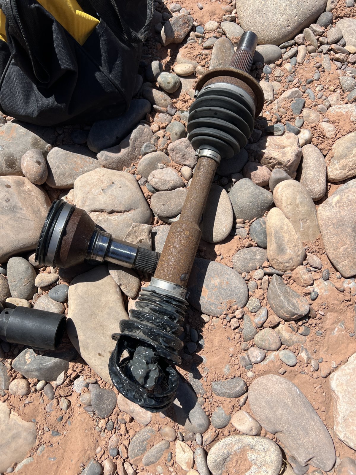

    What’s up, came to check with everyone and let everyone know that my driver CV separated on me. This happened at the beginning of May while running Poison Spider in Moab. As we suspected, the race cage failed and separated at the outer race.
    You’ll be surprised to find that my boots never did fail me nor have they yet. I think it happened when I did a sharp turn locked in 4 low. Because right after I had a straight ascend in shale rock and it kept slipping and quite frankly embarrassing because I tried to move for a good 5 minutes before I asked a buddy to check my wheels and sure enough he confirmed my axle was shot.
    So I backed down the straight in reverse about 100 yards to where I took the sharp turn since it was an open area to pull over. The only oversight I had was that I forgot to pack a prybar so had to get creative with pulling the broken portion of the CV out of the differential. But that aside, a quick 40 min job on the side of the trail and I was back in action with my OEM Toyota axle for the rest of the trip.
    Once back home, I took the broken axle to autozone and they swapped me out for another one, no questions asked. Took it home and 40 minutes later had it swapped back into the truck so I can continue to use my OEM as trail spares.
    As I originally stated in my first post, they served the exact purpose I wanted them for, sacrificial trail axles with a lifetime warranty. My OEM ones will keep getting me home. And what’s 40 minutes, for me not a deal breaker.

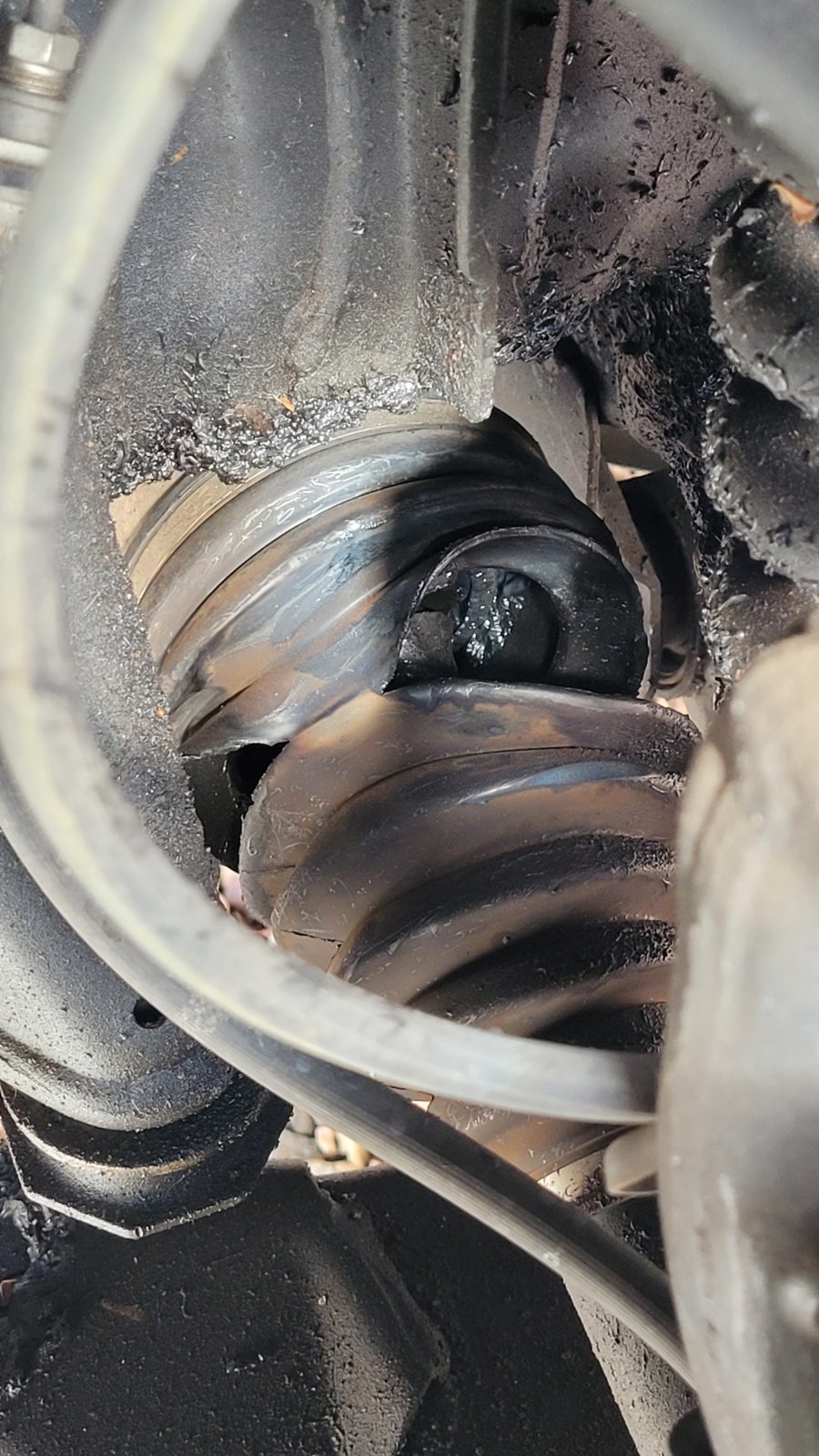

    @beehivetundra, that sucks that it happened out there man. But yours seem to have lasted a lot longer than mine did. My passenger side just went on me again 2 weeks ago. This is crazy. I don't even do any off road driving, just city driving and these things keep going on me every few months. I don't understand what the issue is? Could it be the AZ heat maybe? This time I'm going to try and do it myself since it's only the one side.

    Oh wow, again! what kind of lift are you on? I wonder if you have a more aggressive CV angle than I do and that’s causing them to fail? Is it the boots separating or tearing? Or is it the actual joints separating and losing the bearings?

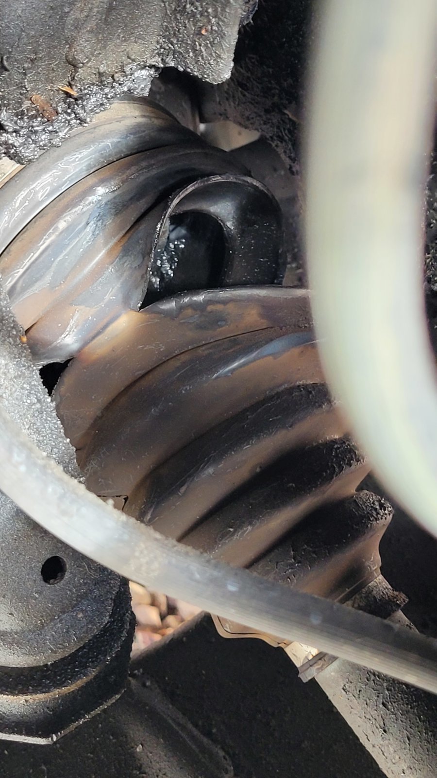

  12. Aug 5, 2024 at 9:06 AM
    #42
    TundraAllDay
    TundraAllDay New Member
    Oct 1, 2023
    #104749
    21
    2014 White Tundra SR5 5.7L V8

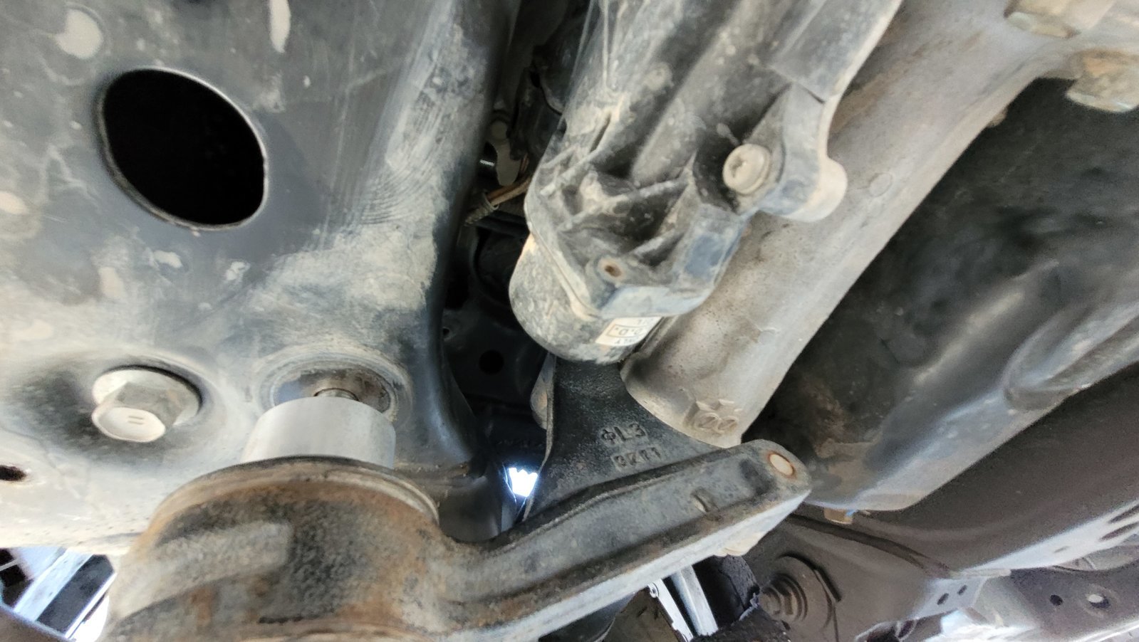

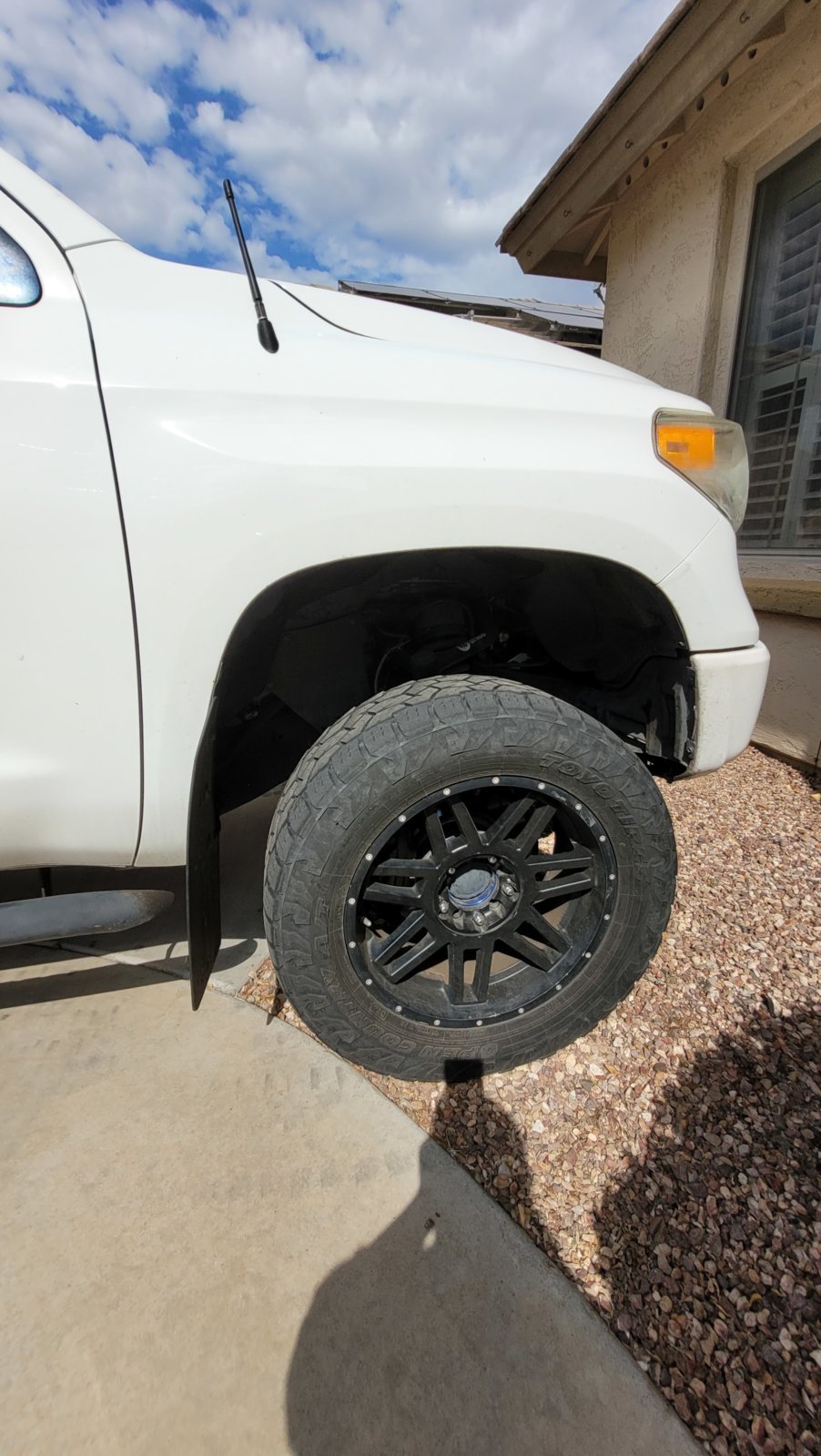

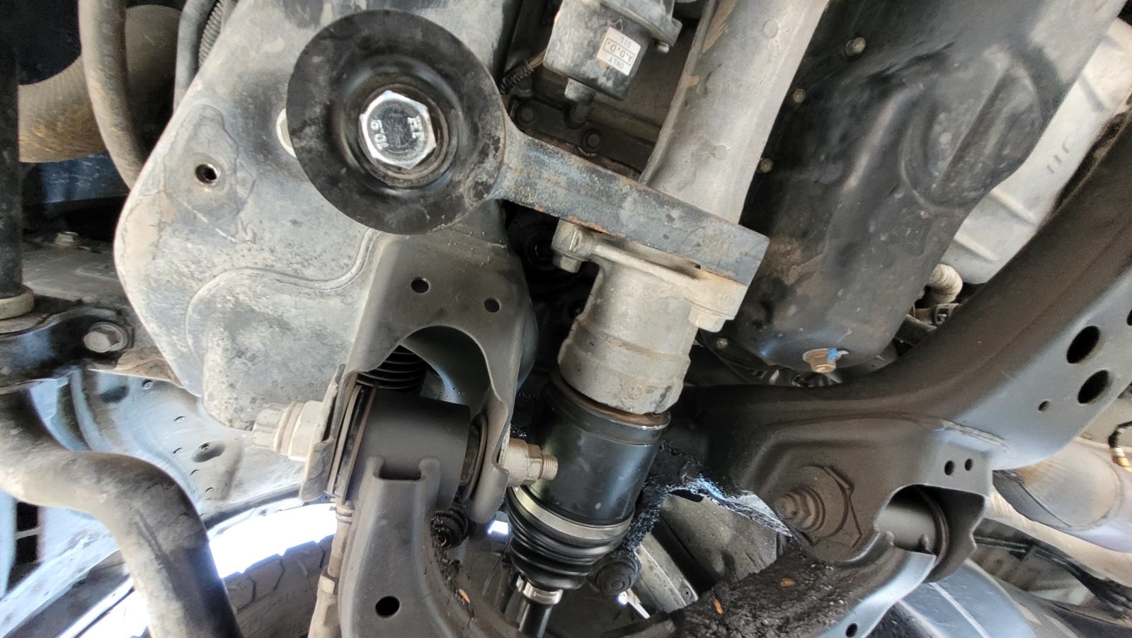

    Just the top part of the boot keeps opening like the photos attached. The lift kit is 2 inches and the shocks add 1 inch to that for a total of 3 inches.

  13. Aug 5, 2024 at 9:10 AM
    #43
    KNABORES
    KNABORES Sarcasm incoming
    Jan 1, 2020
    #40572
    13,745
    Arkansas

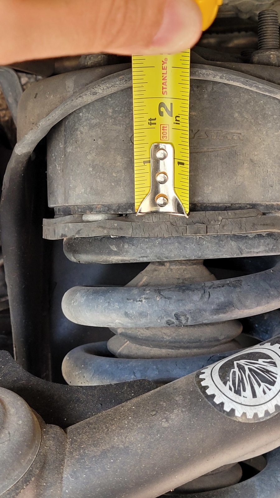

    You sure that spacer on top is only 2" of lift?? :monocle:
    It looks 2" thick, which would yield more like 3-4" of lift.

    That's the info the previous owner gave me so I'm not sure.

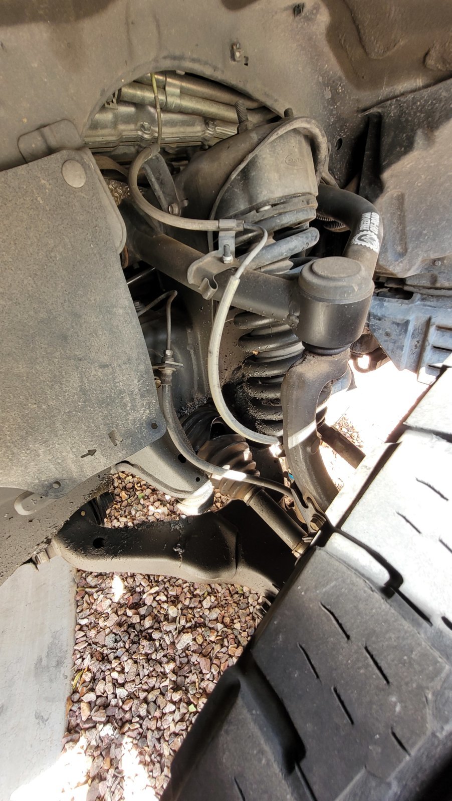

  15. Aug 5, 2024 at 9:21 AM
    #45
    TundraAllDay
    Oct 1, 2023
    #104749
    21

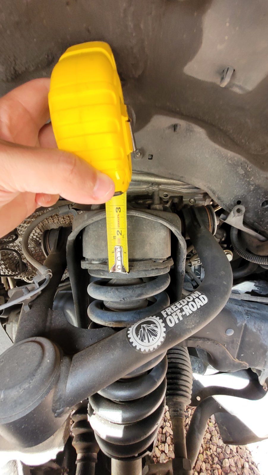

    Not sure if I'm doing this correctly, but this is what I can see with my measuring tape.
  16. Aug 5, 2024 at 9:27 AM
    #46
    KNABORES
    Jan 1, 2020
    #40572
    13,745
    Arkansas
    Those are likely the 3" Daystar leveling blocks. I don't see any 2" available from them. If you have an additional 1" lift in your front shock / coilover setup, then you're at 4" of lift in the front and likely need extended axles? What front shocks are you running? Side pic of your truck?

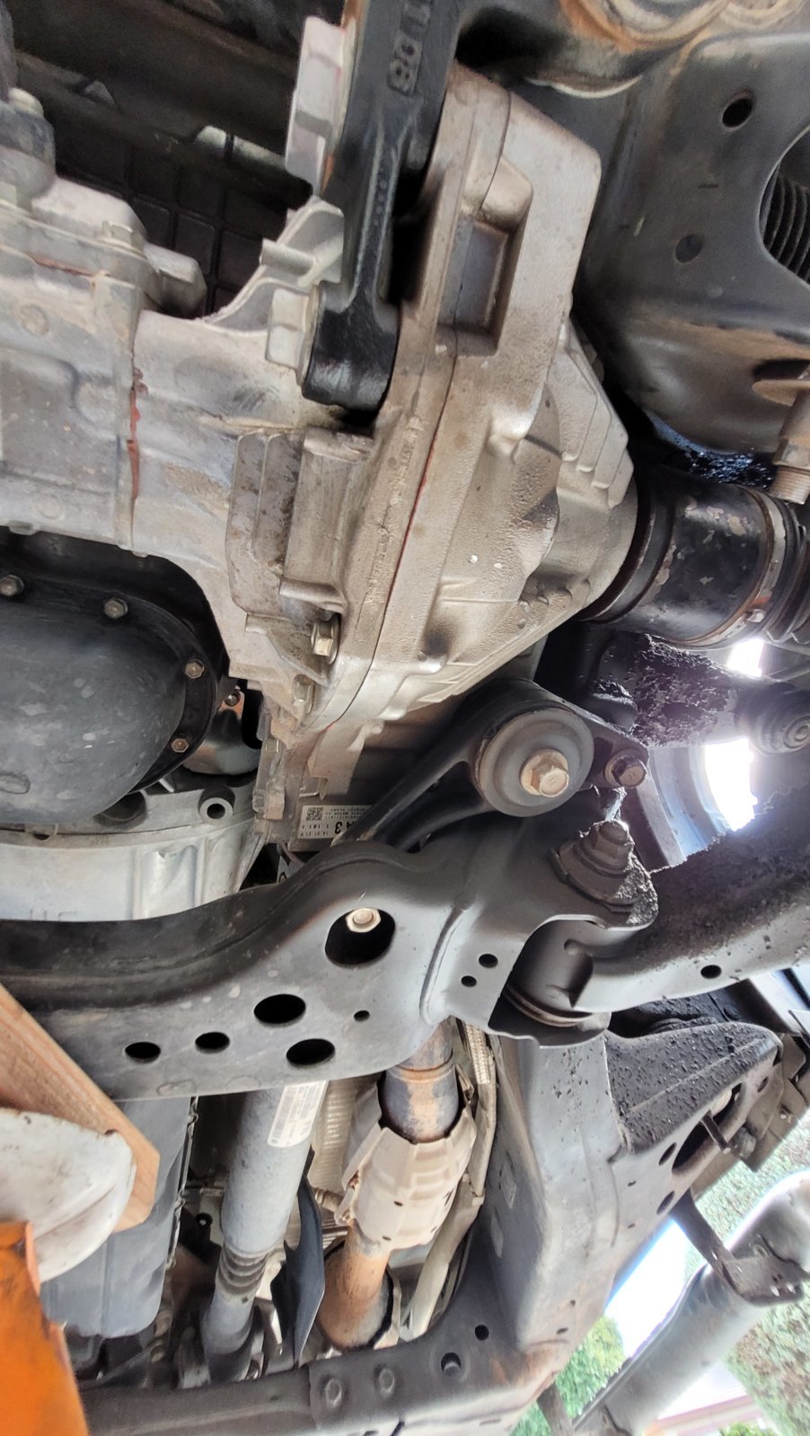

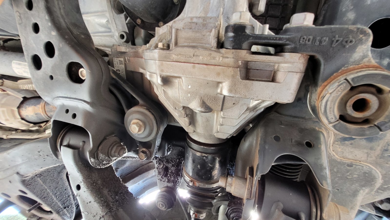

  17. Aug 5, 2024 at 9:35 AM
    #47
    TundraAllDay
    Oct 1, 2023
    #104749
    21

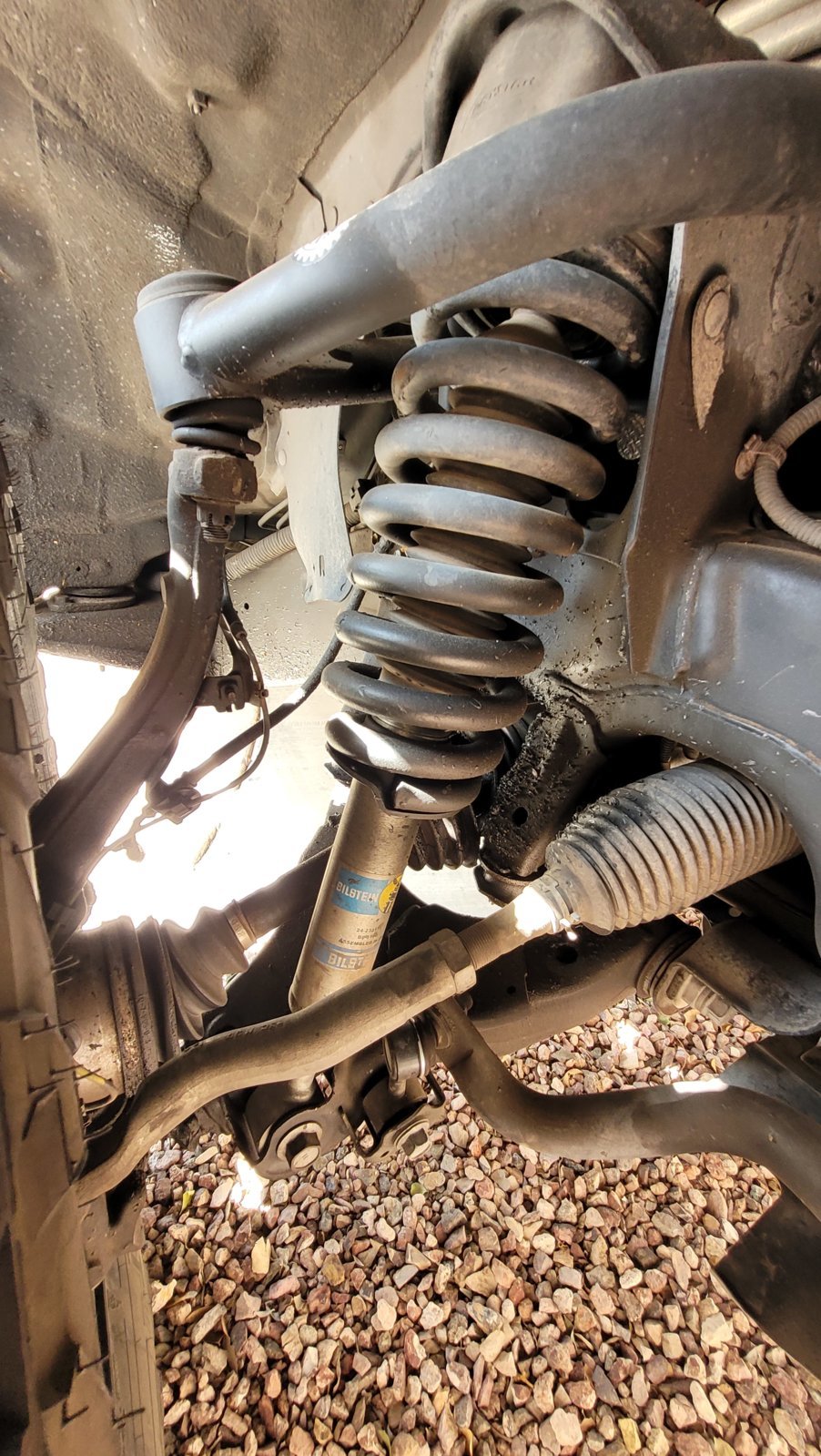

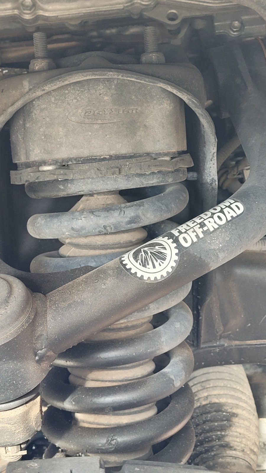

    Hopefully these will help. Thank you

    That’s a lot of lift.

  19. Aug 5, 2024 at 9:43 AM
    #49
    KNABORES
    Jan 1, 2020
    #40572
    13,745
    Arkansas
    Yeah, that's a lot more than 3" of lift. This is probably why the boots keep tearing. You'll need to put some high angle boots on there like the Porsche ones.

    OEM or RCV. Aftermarket (parts store) might use tripod joints which have less articulation, which is no good for with your lift. If you're just tearing the boot repeatedly and not screwing up the joint, reboot with a Porsche 930 CV boot or similar. Has more ribs and won't tear as easily.
    If I were you though, I'd just take out the spacer lift and most of your headaches will be solved.

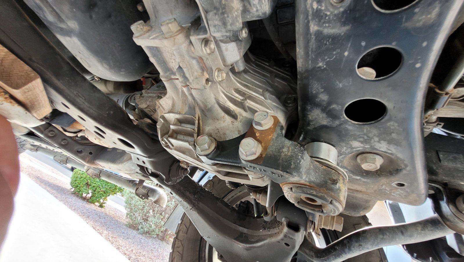

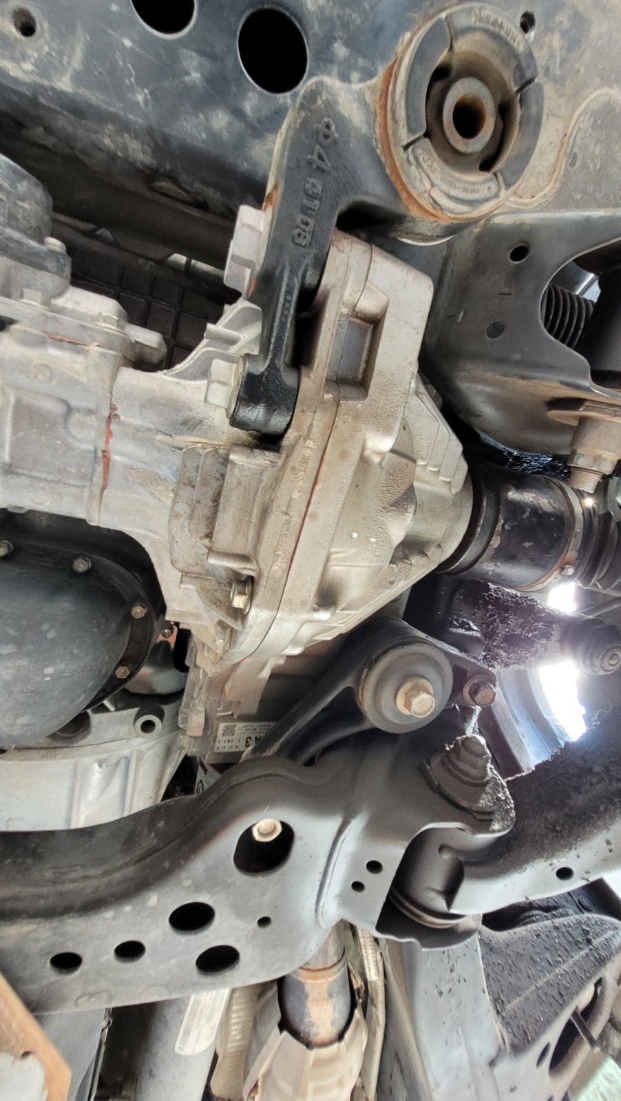

    I'm trying to install a diff drop spacers, but my differential has a different setup than any I've seen on YouTube. My diff seems to have a braket holding on the driver side. Anyone know how I should go about putting the diff drop spacer in or will spacers not work for me? Thank you.

    Did you get your install sorted out? I actually haven’t installed a diff drop and not sure what the process is for that driver side bracket.

    Yes I did. I took the truck a few weeks ago to Total Off Road and they recommended I install a diff drop with spacers to help with the angle. I ended up buying the 1 inch spacer kit and installed them myself. It took me about 3 hours to do. First time for everything lol. Most of my time was spent dealing with the amount of space I had to put the new bolt and nut on the driver side. That space is really tight and trying to get your hands in there to guide the nut on the bolt was a bit of work. But I finally got it and I was able to get a wrench in there to hold the nut so I can tighten the bolt from the bottom. In regards to my initial question above, I had to loosen the big bolt on the differential bracket that's in the middle a tiny bit to allow the differential to drop a bit more so I can get the spacer in. Then I put everything back the way it was. The kit came with spacers for the engine shield as well. That was tricky as the spacers have to go on top of the engine shield to bring it down. I used a few small pieces of duct tape to hold the spacers in place so they wouldn't fall off the engine shield while I tried to put it on and got the new bolts in place. Hopefully all this work will actually help with reducing the wear and tear on the boots. But only time will tell. I will report back if the boots go again. Thanks again to everyone and the great info on everything.
