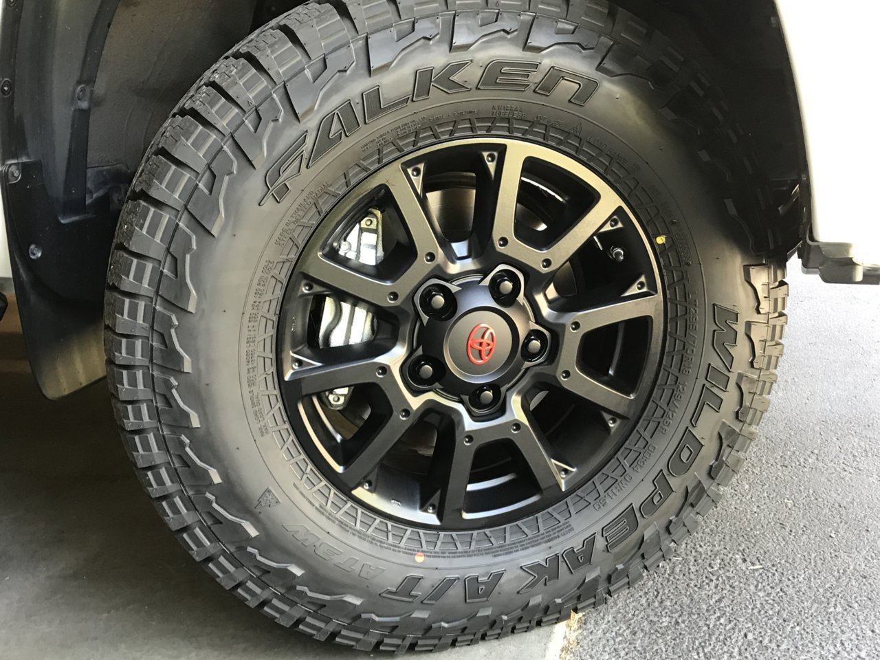

    I had my TRD wheels powder coated locally in matte black. $275 for the four and I painted the center caps. Time will tell how well they hold up. Full disclaimer; I was hoping to find the new TRD Pro wheels, but too $$$.

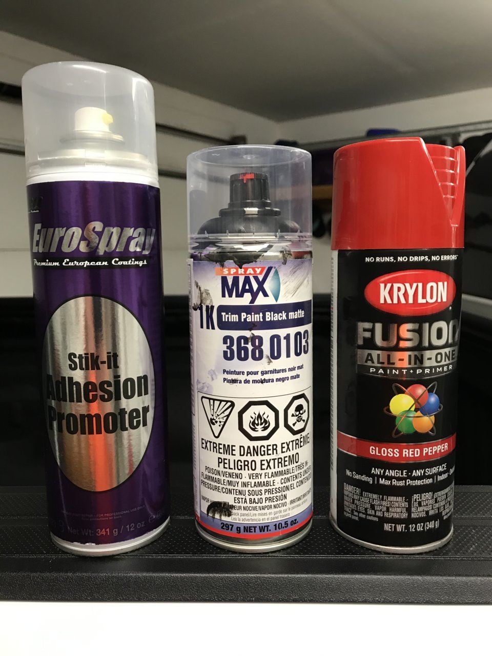

    Turned out real nice! What paint did you use for the center cap?

    I lightly sanded with 1200 wet paper, then primed with the adhesive. Three coats of the matte black. These paints dry fast and only need about 20 minutes between coats.
