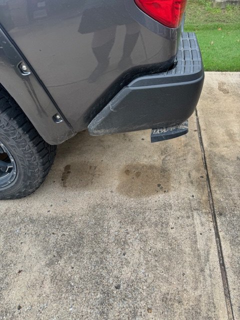

    I have the TRD dual exhaust on my 21 platinum and I was wondering if I would be able to install a bed step. From the looks of it it may be in the way

    The TRD exhaust exits behind the mudflap, not out the back. Are you sure you have a TRD exhaust, or possibly a custom tailpipe section? That said, it looks like you’re right and it will most likely interfere with a bed step install, though I’ve never looked into how that works. I’m sure someone that has installed the step will chime in shortly.

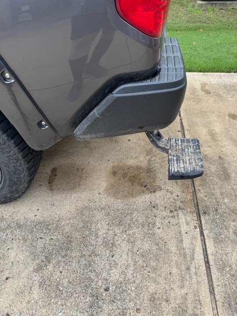

    Exactly this. No need for a new exhaust, just have a shop cut the end and redirect it. Should be simple and easy to be done and then install the bed step and all will be right in the world.

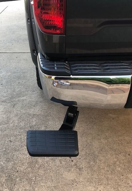

    From the rear, with a clean truck....:eek2:
    @joe diego I can take better pics if needed.:cool:
    X2 on Keith @dirtydeeds
    Best customer service I've had in years..
    He will give you great advice even if you don't buy anything from him.
    Great guy to deal with and the KING of Tundra exhausts...

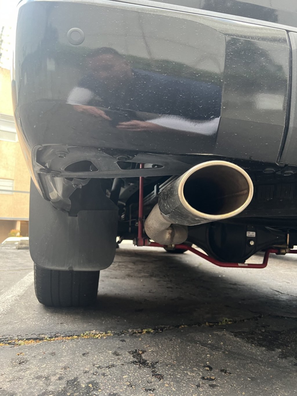

    Here’s a pic I took of the muffler. I think it’s an actual TRD exhaust.

    I'd say so.
    As others stated it looks like someone liked the rear out over the side out..

    Yeah those are the trd tips too.

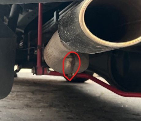

    Previous owner didn't like the tips coming out behind the wheels. Zoom in and you can see the cut and weld job.
    I had to cut my TRD exhaust and redirect it to clear my leaf springs when I lowered my truck.

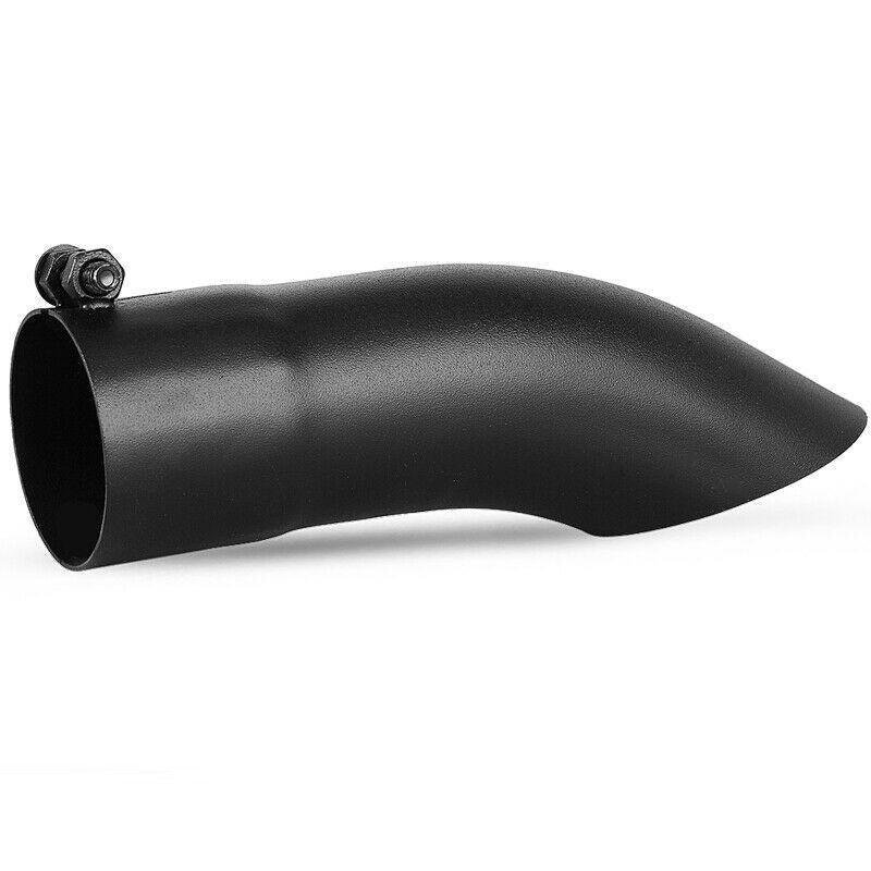

    Pics? Did you just do a straight cut or angle it? Thinking if I ever decide to delete my tailpipe like you did, I'd probably want to add a turn down.
    Something like this ..
  24. Apr 30, 2024 at 11:17 AM
    #24
    reneaux
    reneaux I've been around
    Jan 14, 2020
    #41189
    331
    2017 SR5 CM 4x4
    It pretty much points straight to the ground. Cut it a few inches after the last hanger.
  25. Apr 30, 2024 at 11:19 AM
    #25
    TacomaTRD4x402
    TacomaTRD4x402 New Member
    Nov 26, 2023
    #107483
    418
    Southern California
    '18 Tundra TRD Sport 2WD 5.7 Crew Cab MGM
    Brand new cabin air filter!
    Ahh nice! So that turn down wouldn't even be needed.
  26. Apr 30, 2024 at 11:21 AM
    #26
    reneaux
    Jan 14, 2020
    #41189
    331
    2017 SR5 CM 4x4
    Nope not needed. I thought about getting just a black tip to put on it to clean it up, but have not got around to doing it. 10 min job with a cutoff wheel or sawzall. No other hangers to mess with or anything.
