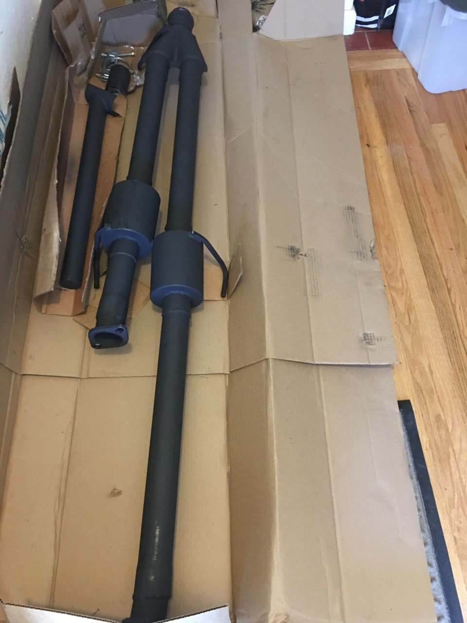

    OP You can do anything you want to the exhaust cat back. One of the beautiful things about the way Toyota designed the exhaust system. You could have true duels without major modifications. Although the single outlet tail pipe is sufficient.
    I went with this. Two mufflers into a wye pipe. Unless you’ve got power adders and long tube headers, there is no significant gain into making it a true duel.
