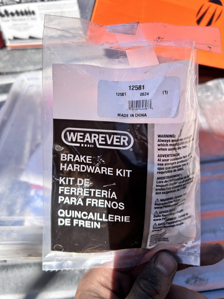

    Just wanted to add this in here for those questioning aftermarket parts. I used this carquest part from Advanded Autoparts on my 04 Tundra DC to fix the star adjuster. At the least I can confirm that this part fits, the metal flange sits on the star wheel correctly/seems robust enough.
