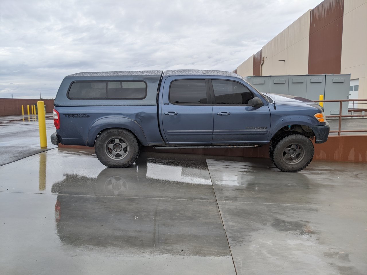

    Hi everyone, long time lurker, first time poster here.
    I recently installed Solo's stock length LCA with the octagon alignment bolts on my 06 doublecab and ran into something interesting. It seems the stock LCA allows for about 1.75in more droop than the Solo arms therefore limiting my suspension travel. I know not many are running these LCAs yet but has anyone experienced this problem too? For setup I'm running 6112s with 700lb springs on the highest circlip setting for the doublecab and no front swaybar.
    I went with the Solo's because they move the lower ball joint forward an inch giving me the ability to run ~35in tires without having to cut and tub the firewall. I went with 700lb springs because I'll have a Brute Force bumper coming soon and a winch to go with it along with more armor down the road.

    Yeah the 285s clear at full stuff with plenty of space left over so I'm hoping with once I do the pinch weld mod it'll be enough to clear either 35x10.5s or 315/70R17s with the right offset and backspacing.

    Alignment is good to go, 6° of caster and about 0.12° of toe. I know the toe is supposed to be ~0.24° but it tracks and steers great as is.

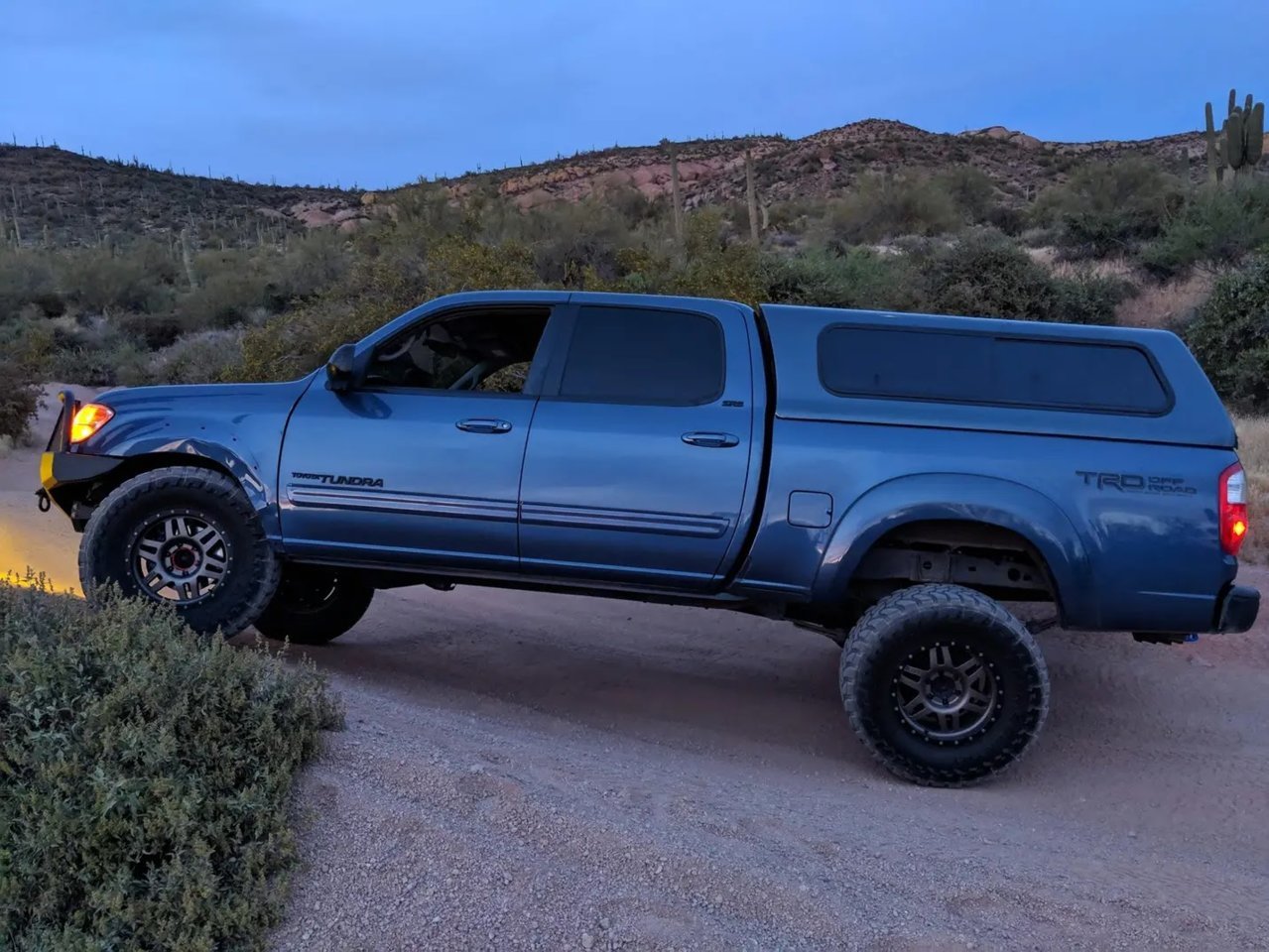

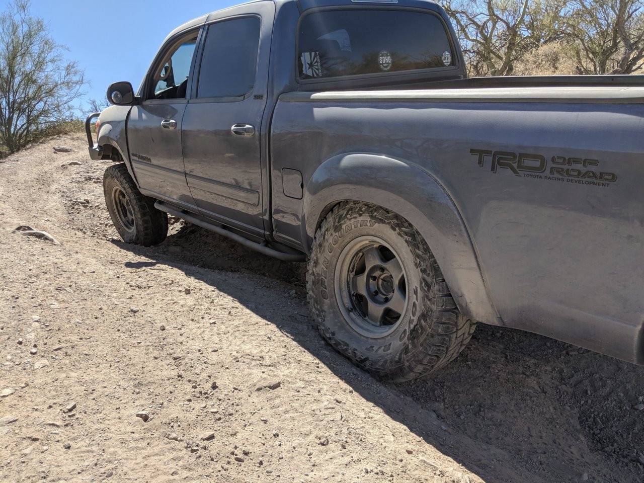

    Here’s 6* caster, solo lca’s, and 2.5” lift:
    2DE3C158-ADF4-441B-8833-5980B049D5C8.jpg 524CC9EC-398C-42B7-A972-EB8682BFE8B4.jpg B53A1EB9-0A65-4F60-B7D9-B4F88BD15B9E.jpg
    Save yourself the time and money and go with 285/75’s, trust me.

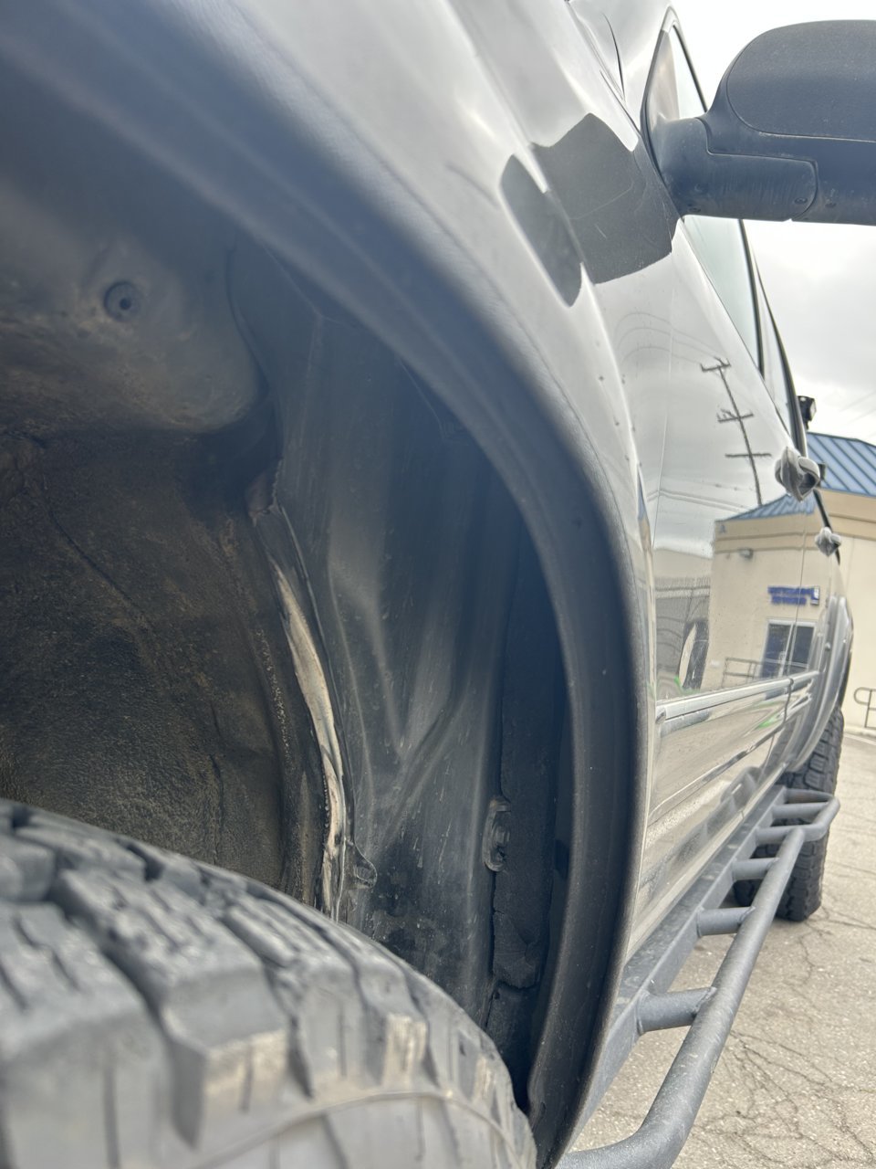

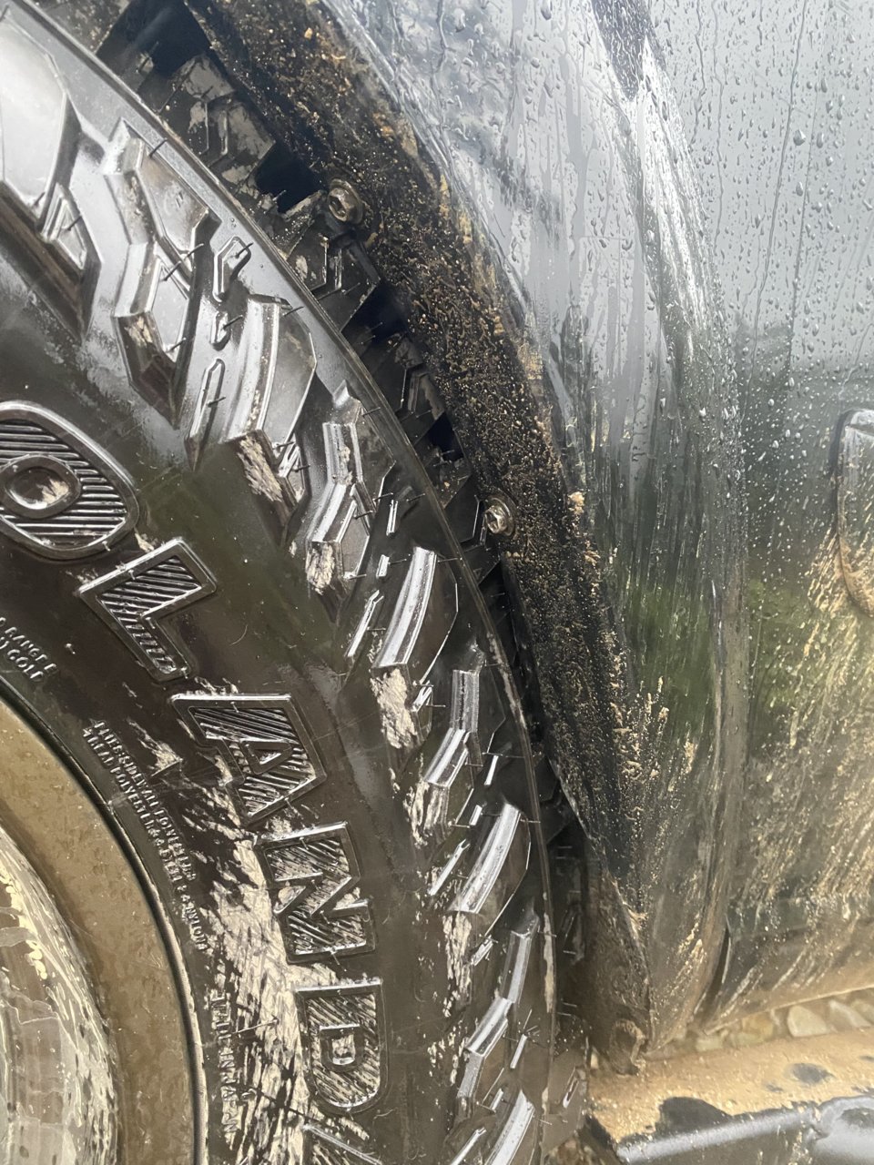

    At full stuff my 285s will rub my tub. They burnt holes in my liners and I trimmed my fenders because I bashed one of those. I'm running toyos

    There goes my hope of not having to do fiberglass fenders. I have 285/75s on already, Nokian Outpost ATs. I want the 35s for a tiny bit more ground clearance, improvement of approach, breakover, and departure angles, and improved floatation when aired down.
    The droop issue is still bugging me, after work I'll try removing the shock and cycling the suspension to see if it's binding anywhere or if my droop changes without the shocks in place.

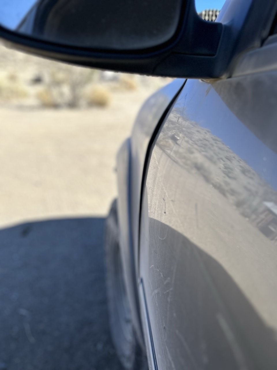

    Apparently both of us didn’t trim or hammer enough

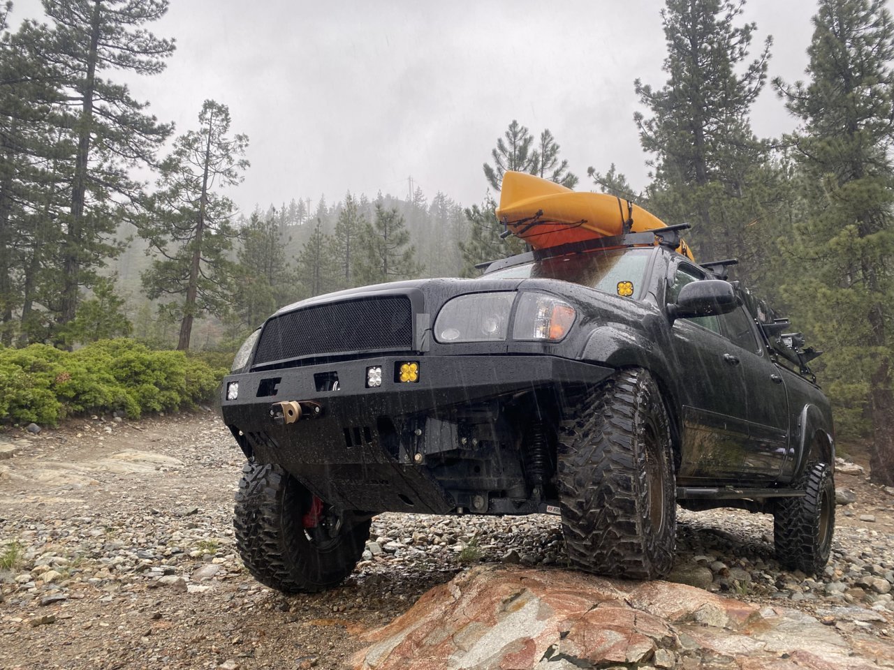

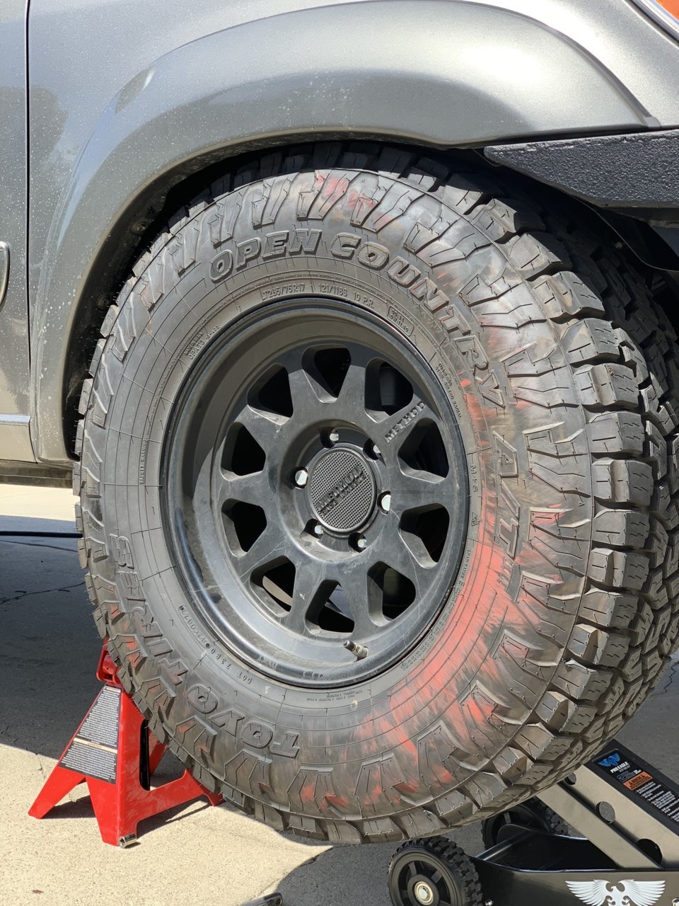

    I guess, lol. Here’s my static stuff no coil over on 285s. This is before I did the same to my fender as you, on a turn I think?
    This is probably 1”+ shy of full compression and I’m not turning the wheel out much. This wasn’t enough to blow the fender, that was a later trip.

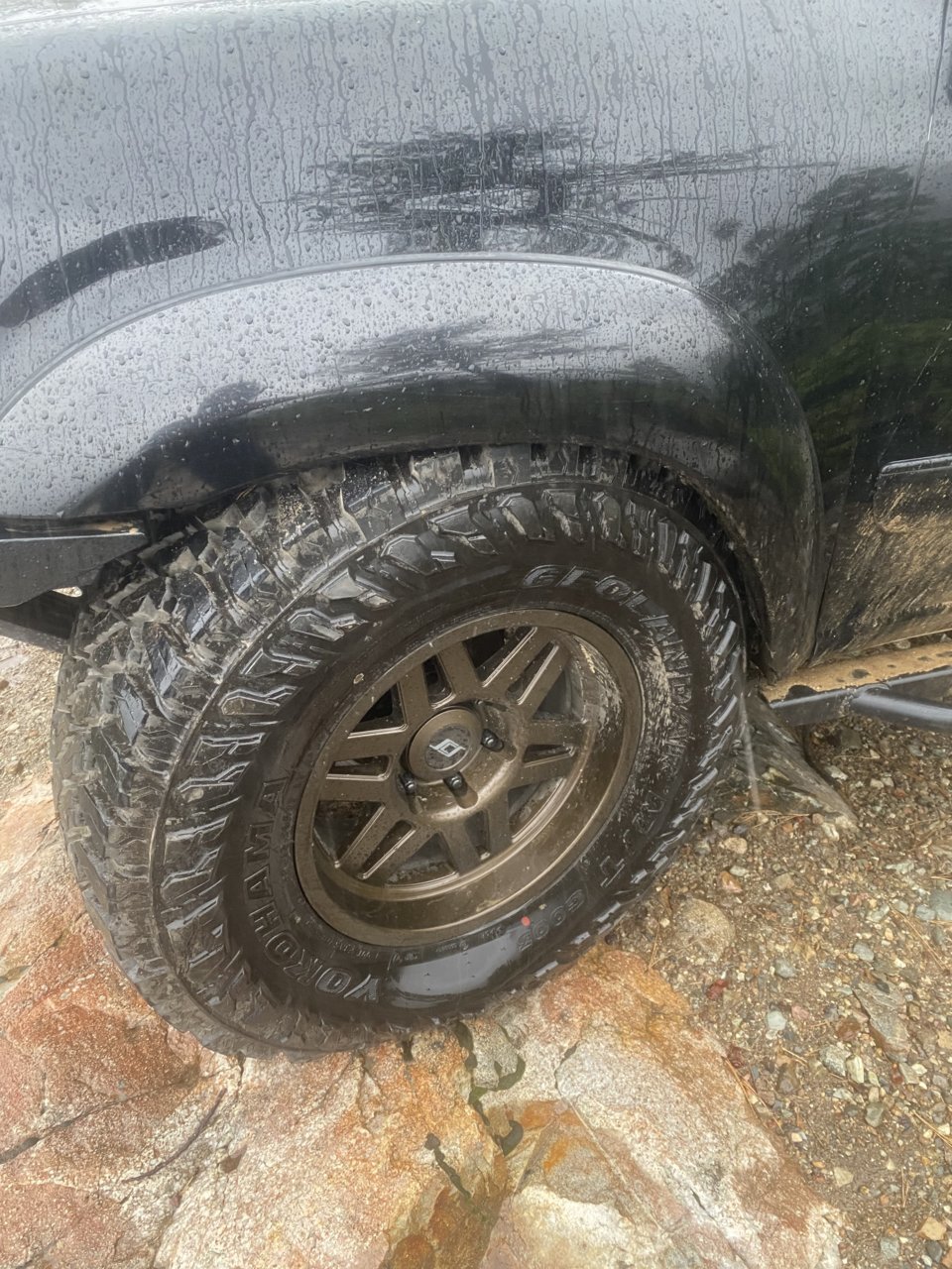

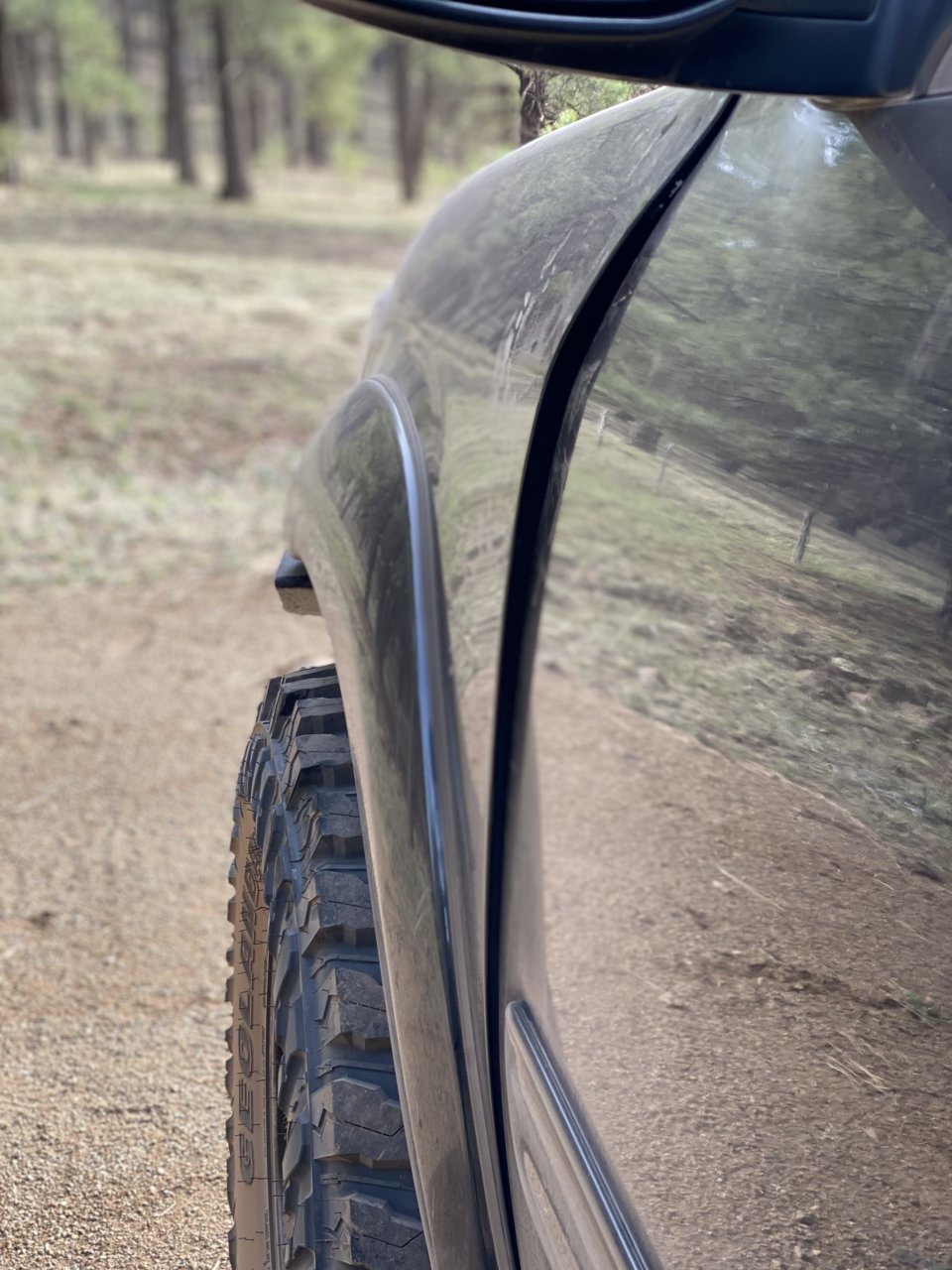

    I have one like that. I think I pushed it in a touch before taking the picture.
    here are my fenders now

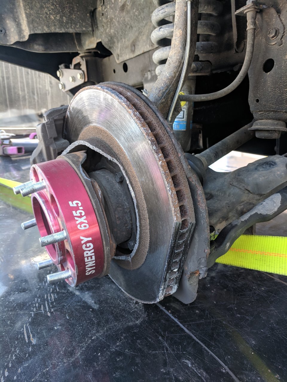

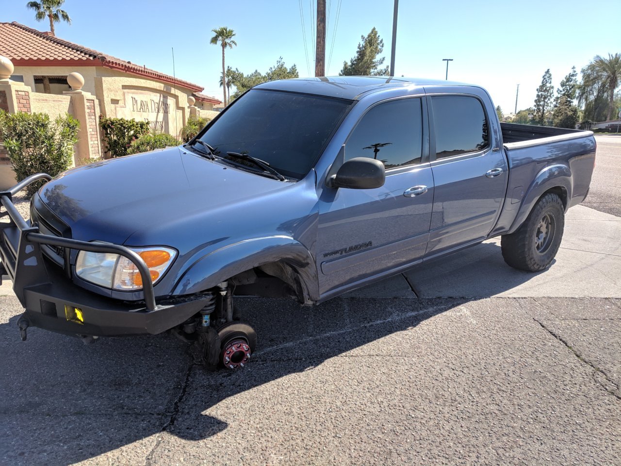

    I wish that was my reason. I used to be a little more stupid. Haha.
    And no, this was not wheel spacer fault. All of the threads were good thought the studs were bent from riding along the inside of the wheel. I didn't properly torque the wheel lugs.

    Am I not seeing what I think I see? Back tire is stuffed into the rear wheel well. Acts like a surface brake against all the portion of the tire that touches. Absolutely will limit tire movement. If it's "incidental" contact at speed, may be no big problem and noticeable only by sound, or signs of wear on tire or inside wheel well. But trying to do a technical trail, I can say from experience, that significant hang up will stop the truck if that's the tire with traction you need to clear an obstacle.
    Edit: maybe you don't have the same uptravel as me, so your wheels to reach the inside of the well-? Looks probably they do though.

    100% this. Happened to me during an articulation section.

    I do not recall hearing any rubbing sounds; but this was before I upgraded rear bumpstops to Durobumps and swapped out rear shock for Bilstein B110 which has limited my uptravel and doesn't rub when static testing. Here's what it looks with Durobumps and B110
    I am in the process of installing the rear fiberglass and don't recall seeing any rub marks on the fenders or bolts even. I have had rubbing issues on previous vehicles so I definitely understand the hang ups or worse; slicing tires from the sheet metal fenders. :eek:
    This actually happened to my wife; thank you though! She handled it like a champ, just rode the truck maybe 200-300ft until she could turn into this street. We were super fortunate no one was driving in the oncoming lane as the tire bounced across all 4 lanes.
