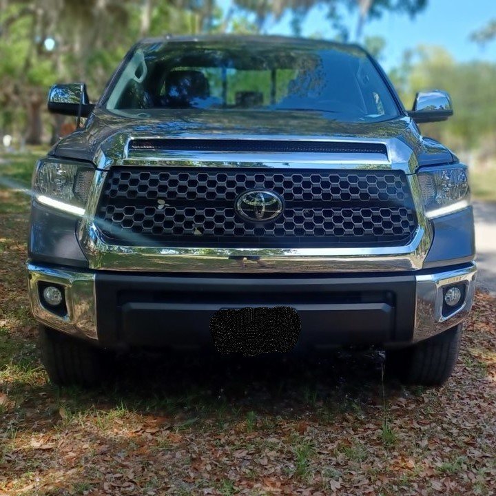

    I kept my amber DRL and had the low white halos come on with the parking and headlights.
    Thanks to @iHacker, it was plug-and-play for me..
    The OEM LED are phemonial compared to halogens...:thumbsup:
