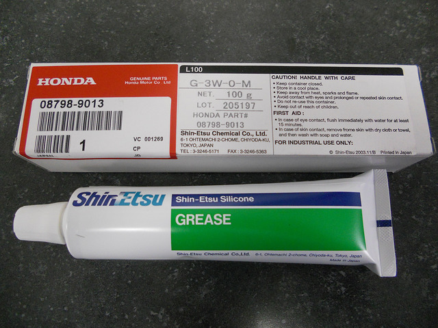

    Potential solution.
    I had a howling/whistle noise coming from drivers side, seemed like the mirror, from day one under certain conditions, usually over 70 mph on a windy day. Searched everywhere like you guys to figure it out. Some said it was the windshield seals, others the door seals. When you crack the window ever so slightly, it would stop. Sound familiar?
    One gentleman posted that he took his door apart and replaced the rubber glass run and belt molding complete with steps and pictures and that solved his issue. I actually ordered those parts and intended to do the same, since he said it worked for him.
    It dawned on me that I still had an old tube of Honda Shin-Etsu grease that I had used for slight wind noise for a Honda Accord. I figured I had nothing to lose since I had it, so I went a head and greased the window run and seal on the drivers door to see what would happen. It seemed to help, so I did a second coat of it about two weeks ago. It seemed to work for me! I took a trip last week, drove for over two hours and speed up over 90 mph, no noise!
    Here is the info in case anyone else wants to try it. The link below is just the first one I saw, you can research who/where and how much. This one was around 12.00. If you go this route and it works/doesn't work for you, please post back in this thread.
    Shin-Etsu Silicone Grease
