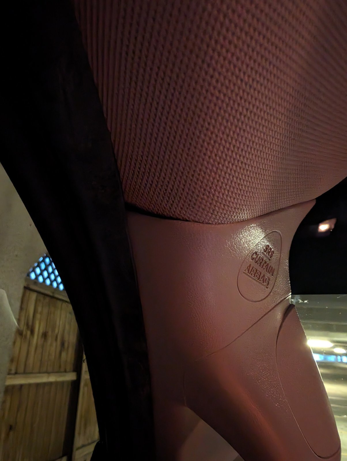

    My arrived yesterday via UPS.
    Was trying to install it this morning in the company's parking garage, but of course, I left my bag of parts on the table when I was heading out (I leave at 630a or prior to that, brain has not fully been function most times...forgetting parts is small, I have repeatedly forgot my wallet and DL....)
    Did have to trim the bottom piece of the garnish a bit for it to fit, now just waiting to get home to install the bolts and make it complete.....

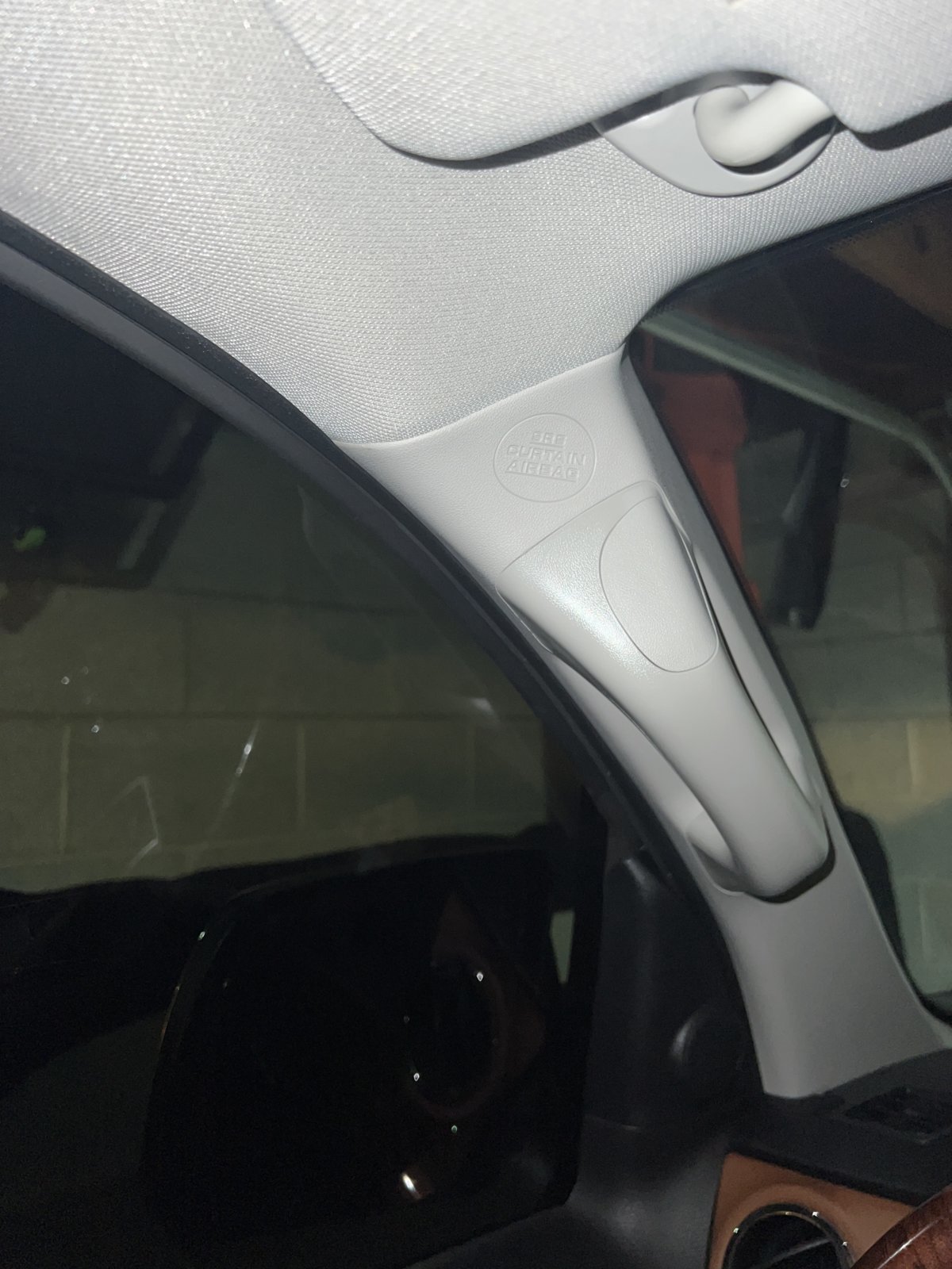

    So got mine installed completed late yesterday, so far looks nice and did the job getting my old ass into the truck. Granted, it may not look too smooth, honestly, it is not completely in the line of sight, so I'm cool with it.
    Worth every penny that was spent on this mod.

    Looks like your fastener covers need to be pushed down more. They kind of slid into place from one end then push down.

    Yea, I can see that, tried to do that after I took the pictures but it was darker (before sunrise and in a multiple story parking garage) so I will attempt that later this afternoon.

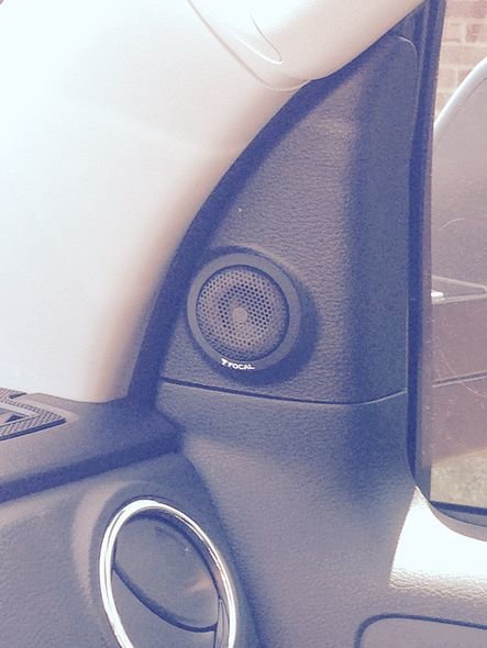

    That is Gen 3 stuff.
    Gen 2.5 JBL tweeters go in the door sail.
    I had to customize mine in my non-JBL...

    Thanks @1lowlife I figured as much it is a 3G product but the Toyota Parts website is anything but helpful on tying to figure out what it is for....
    I will be listing them for sell, at a loss to me of course, I simply don't need a 3G product.

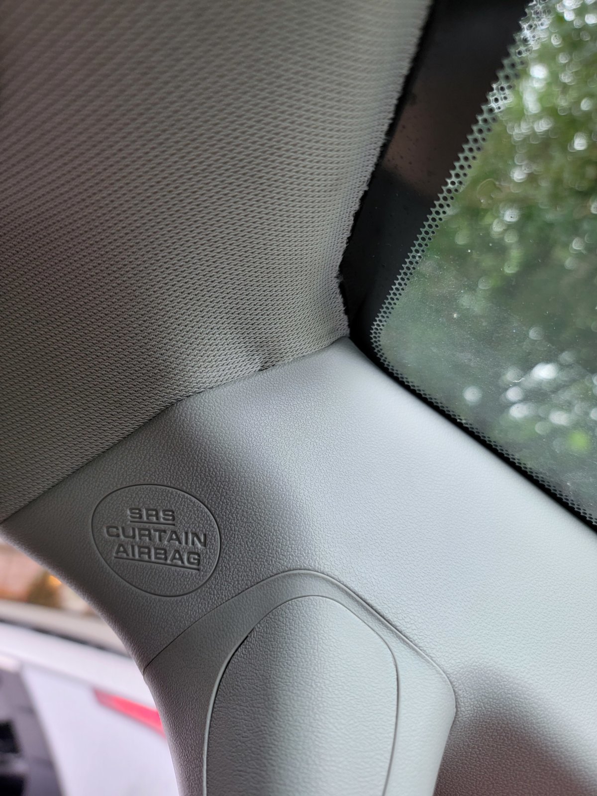

    I finally got mine installed. Had the same issue I’ve seen others on here have, the new piece pushed up on the headliner and made a gap between the headliner and the weather stripping. I put some foam behind it (also something I saw on here), but I need to put another piece up there as I can still see the gap.IMG_3279.jpg IMG_3281.jpg

    Yeah, strange as nobody up to this point reported this gap? Many installs I see to have it but I guess folks don't care? I wonder what part of the plastic geometry forces this behavior? Either, it way looks like putting some foam behind the headliner to push it toward the gasket is a good enough fix. Looks good by the way, if not perfect :)

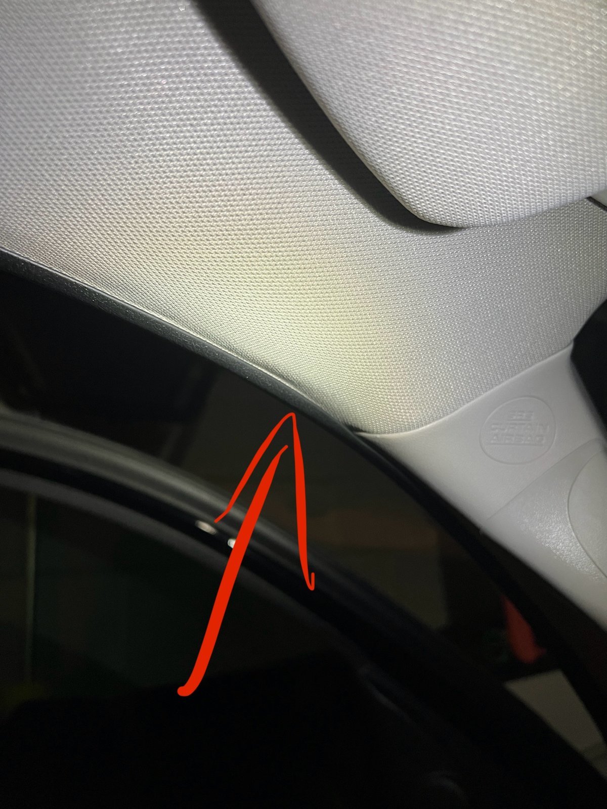

    Got mine in this morning. It went so quickly, I forgot to take pics of the steps. For the cutout relief for the dash wires, after marking where it needed to be, I used a 13mm drill at the top, then tin snips to cut to the 13mm hole. I did the 275 lbs paracord wrap last night, sitting on the sofa, while watching Netflix. For the bottom handle, I used a M6 u-nut with a M6 x 40mm flange bolt. I put an M8 washer under the flange. This M8 washer has approx. the same OD as the
    captive washer of the top handle factory bolt. The only issue I ran into is the headliner at the top of the garnish, near the windshield (see third pic., below). All was perfect until I got the top bolt finger tight, and saw the dimple in the headliner. I loosened the bolt, and the dimple popped back out. Tightened the bolt again, and the dimple returned. I went ahead and tightened both bolts, snapped the covers into place, then used a sewing needle to gently coax the dimple back out. My OCD is now okay, unless it pops back in. I may take the whole thing down and stick some foam under that spot if it does. o_O
    Edit: I don't have a discernible gap, nor dimple, on the other side, the weather strip side, of the garnish.

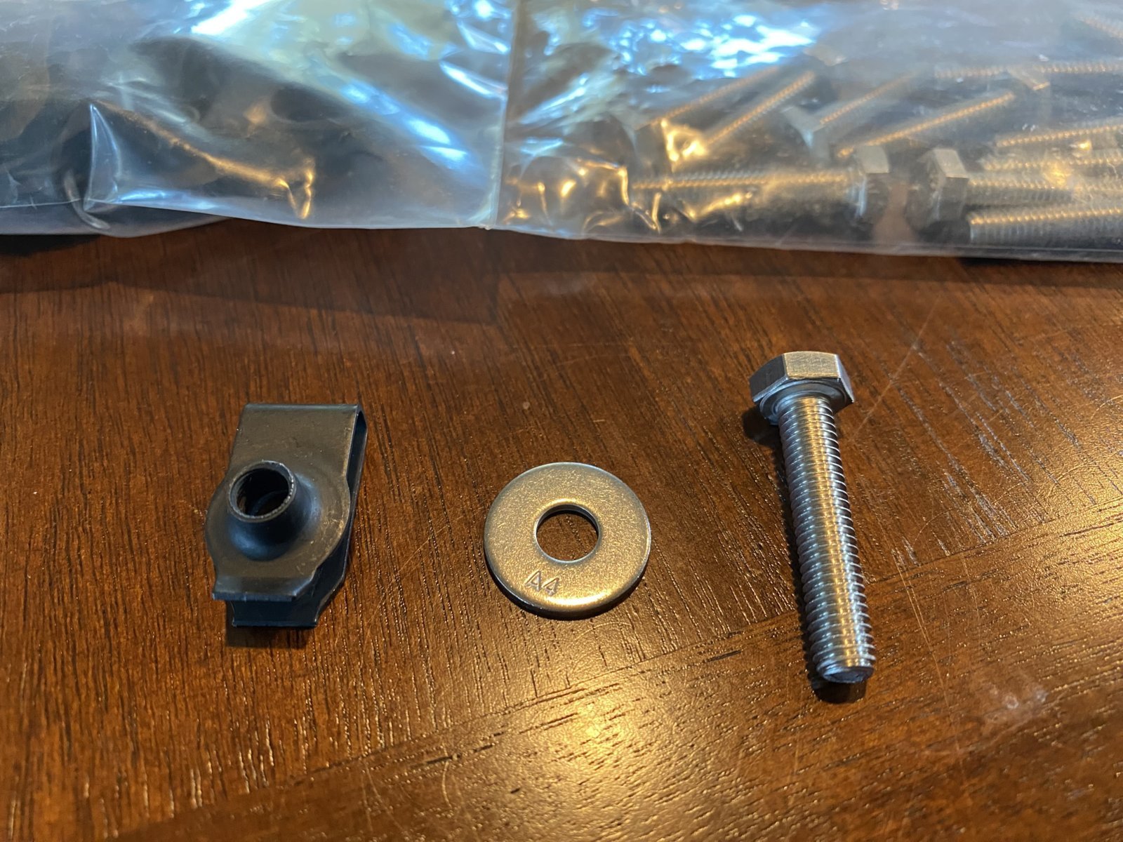

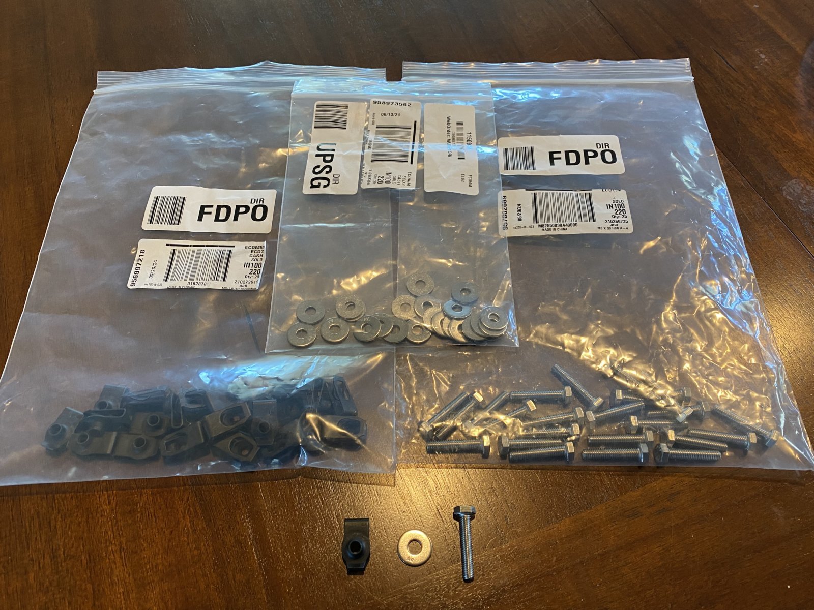

    If anyone wants some metric hardware for their handle, send me a DM, as I have plenty on hand…
    • M6-1.0 x 23.50mm x 12.50mm Phosphate “U” Spring Nut (made for GM & Ford)
    • M6 6.4mm x 18mm DIN 9021 A4 Stainless Steel Fender Washer
    • M6-1.0 x 30mm (10mm head) DIN 933 A4-70 Stainless Steel Hex Cap Screw

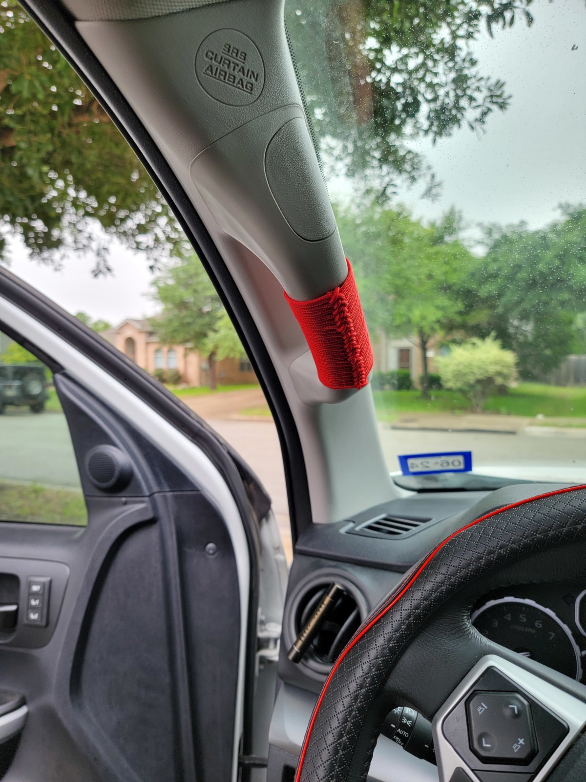

    So, just a quick update, I got this installed when I got it, and am very glad I did.
    I recently discovered that I have partial torn left knee ACL and injured my right knee tendon and ligament, so this grab has been vital to me getting into the truck when I have to drive to the doctors myself.
    Even when I am better, I am trying to not hurt myself again, so I am using it more than I thought I would.
    Excellent piece of hardware. Well worth the money spent.

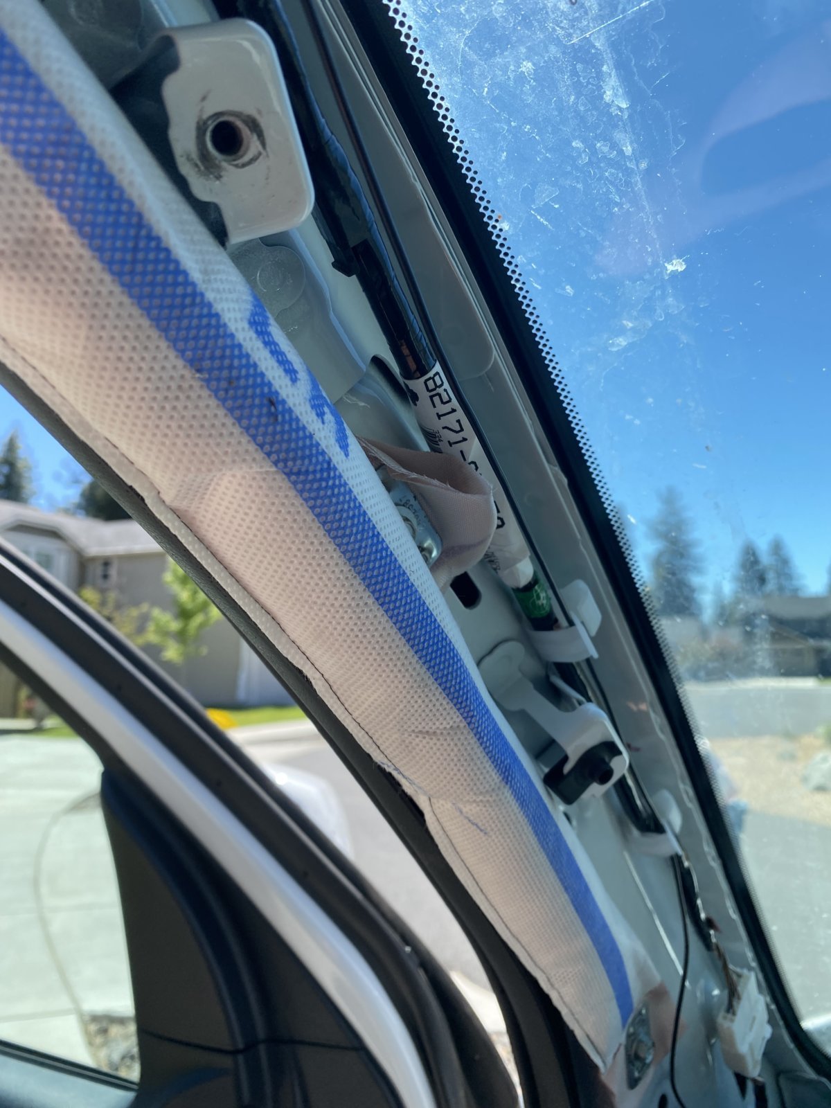

    Does anyone know what the drivers side A-pillar gray handle upper and lower bolt-hole cover P/Ns are? I've researched and get close. But I would like to be sure. Thanks for your help.
