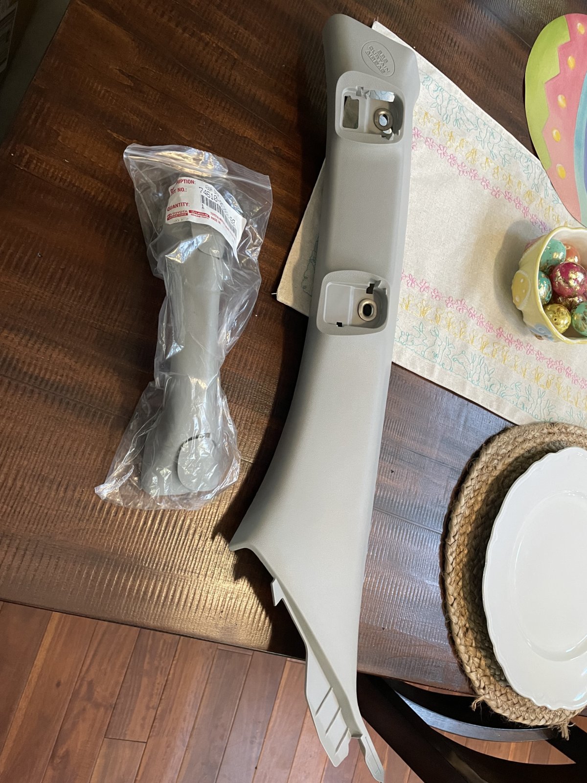

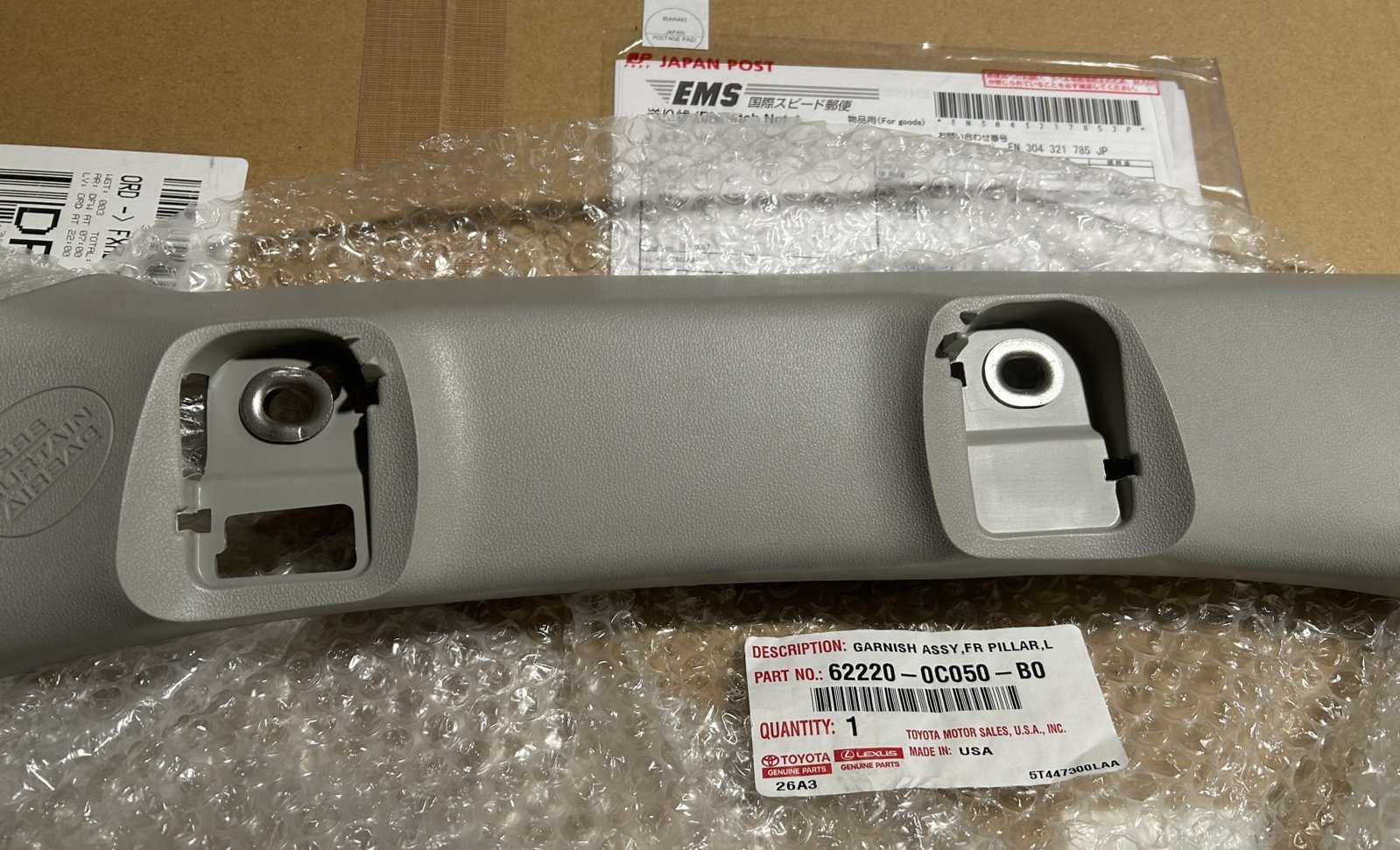

    Ok everyone here is the pillar I just received from Amayama in Japan.
    Handle is a few days behind

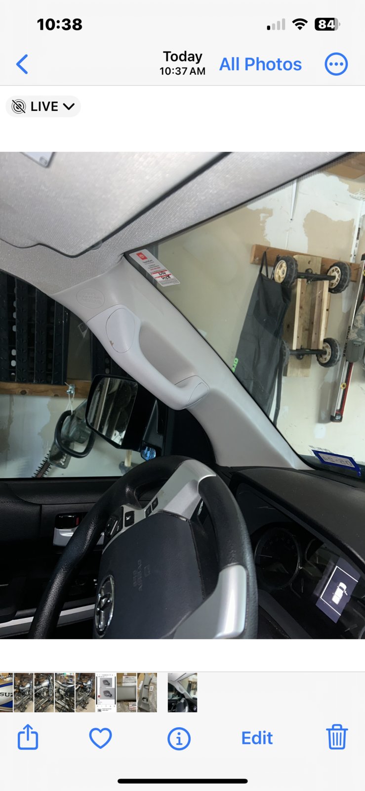

    Here it is installed with an off colored handle… new one coming. You need to cut the bottom flap for a good fit like in the video

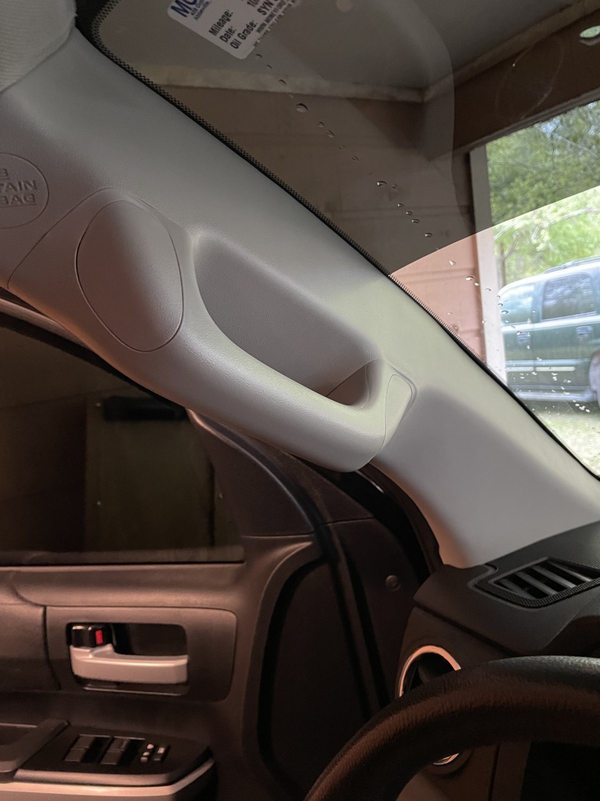

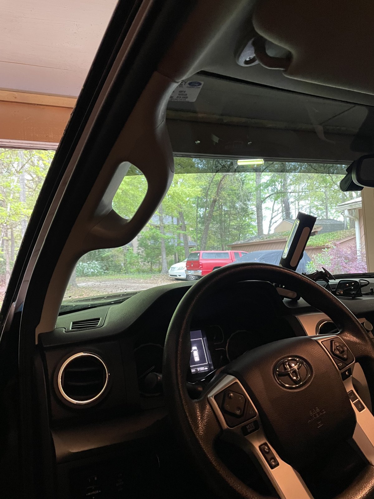

    My trim piece and handle arrived a few days ago. They were packaged well and match the interior color. Installation was quick and easy. If your like me and don’t have many junk yards nearby, this is a great alternative.
