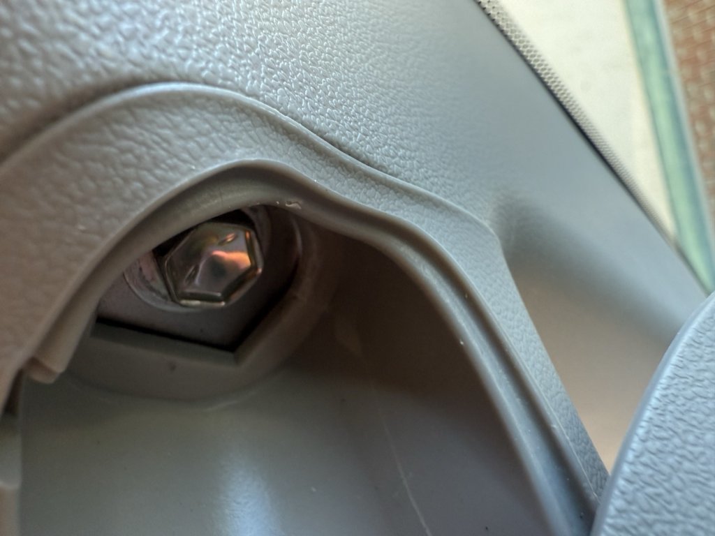

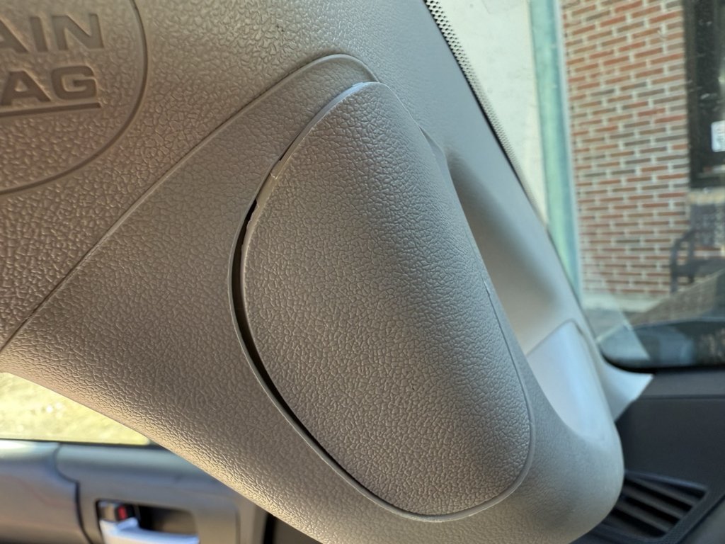

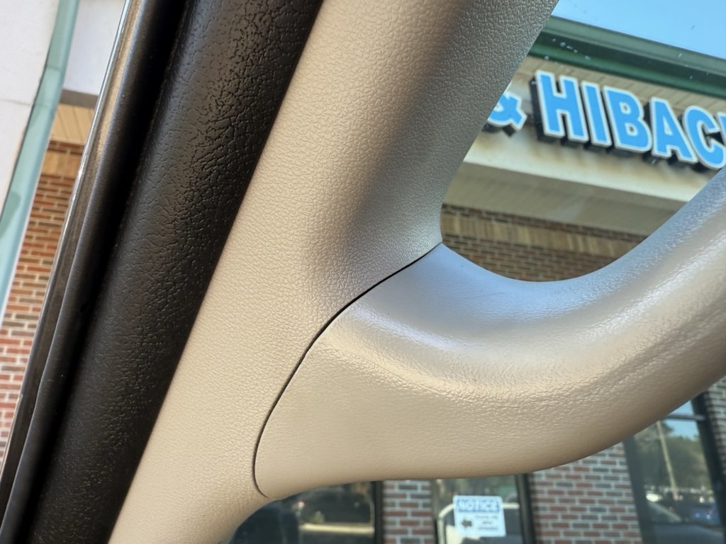

    I'm having problems getting this flush and tight. Anybody experience the same? I backed out both bolts and reseated it, but its still not looking done
    The top cap is always coming off:
    The handle doesn't sit flush on its left side with the pillar garnish and has a bit of rotational flex when I grab it:
    And there's this odd curve on the upper attachment point (which I actually see on the existing passenger handle):

    None of those areas on mine are perfectly flush. Looks pretty similar to yours. There are going to be some imperfections.

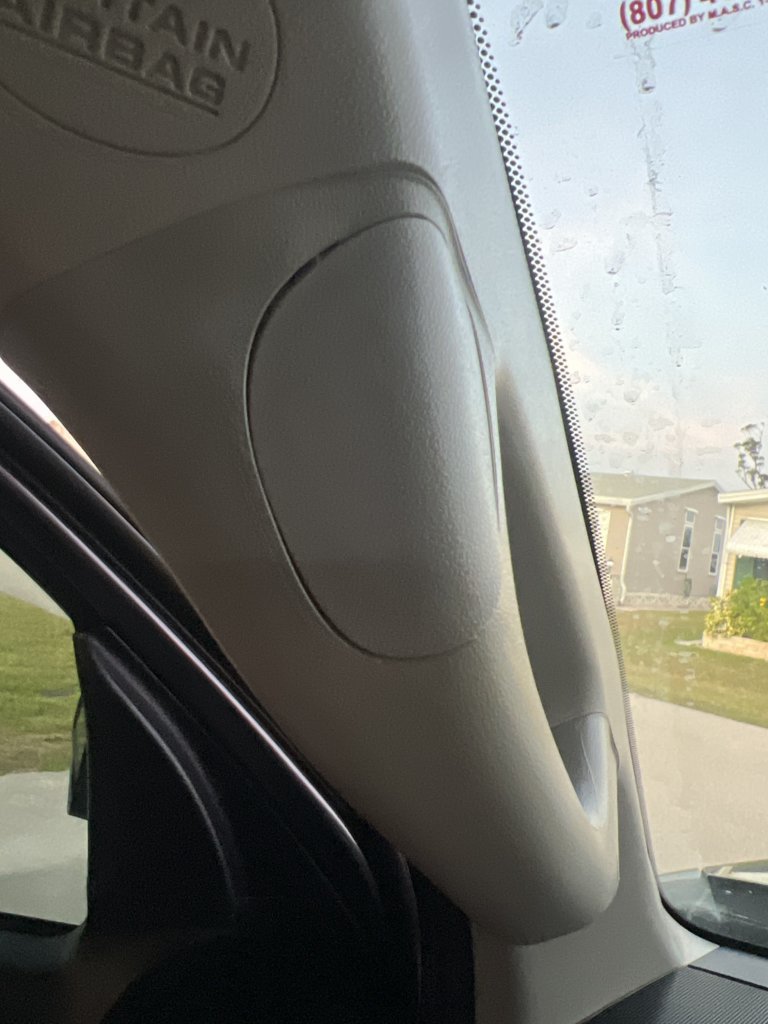

    This is what mine looks like.

    I'm glad you guys all posted up followups. I was trying to see the issue, 'cause it looks exactly like my '08 and '21.

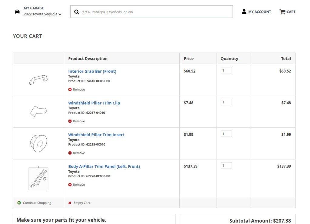

    Found this on Worldtoyota.com. Searched for 22 Sequoia, has same part #'s as the one for the Tundra. Not sure if the other hardware is necessary but I included it in the cart for the screen capture.

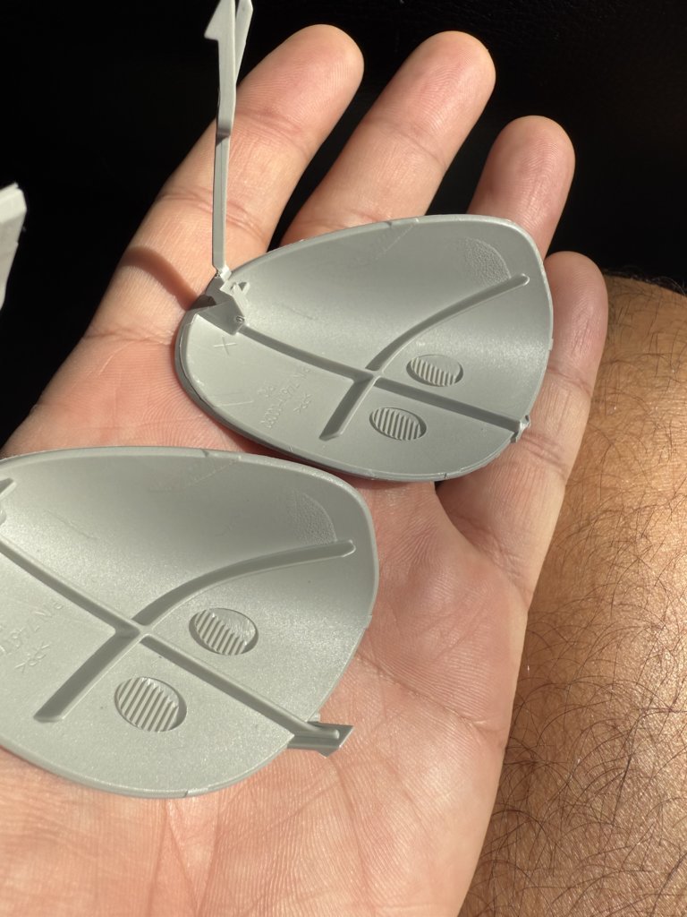

    Well, figured it out – the cover on the right side is the driver's side, it's just missing that little tab.
    Don't think you can replace these without buying another full grab handle so just swapped it out for the corresponding cover from passenger side, no longer pops out.

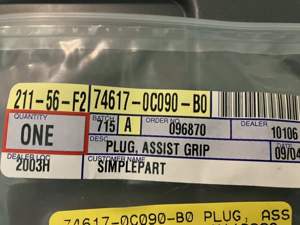

    Actually, those roundish covers can be ordered by themselves... I will get you the Toyota OE part #s a little later this evening :thumbsup:

    Ok, here are the part #s: 74617-0C090 B0 is the driver's top plug, and 74617-0C100 B0 is the driver's bottom plug in gray

    Thanks for these part numbers. I received my order from steal bay yesterday and the tabs were broken on both top and bottom. Ordered both this morning from the local Toyota stealership and will have them Tuesday. I will install the handle today and snap in the plugs when I get them.
