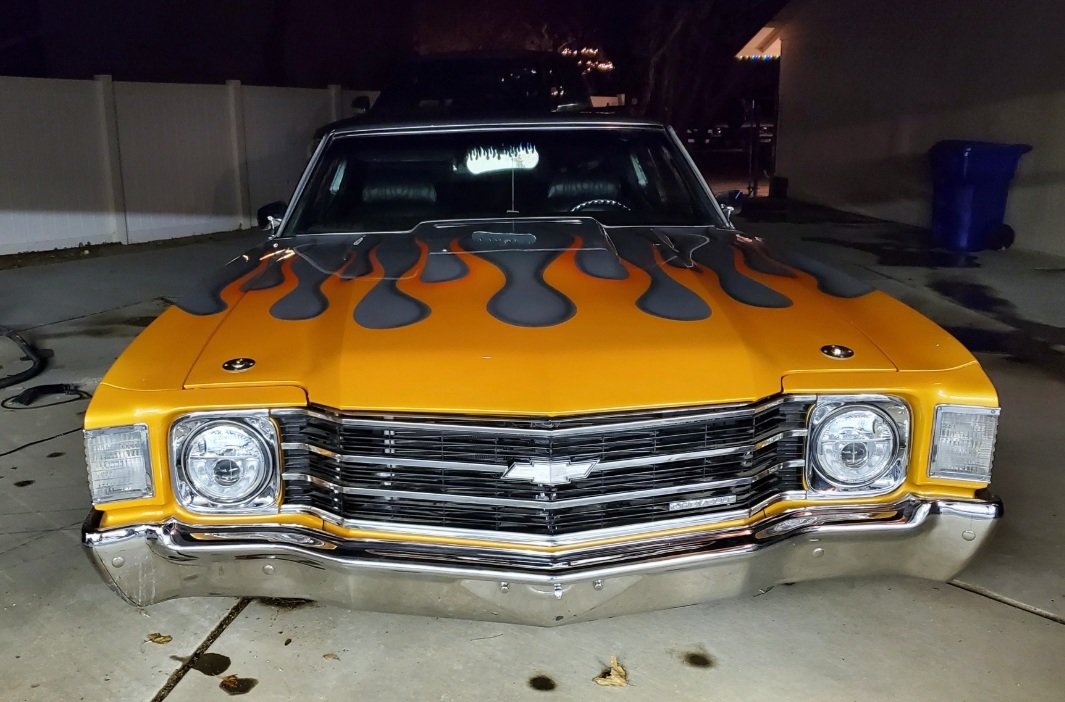

    It really does !! That's my 72 chevelle that I had forever now .thank you !Screenshot_20210419-081426_Gallery.jpg

    I was gonna guess early 70s El Camino, I wasn't too far off. Thats a nice one!
