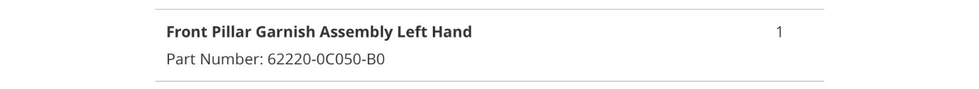

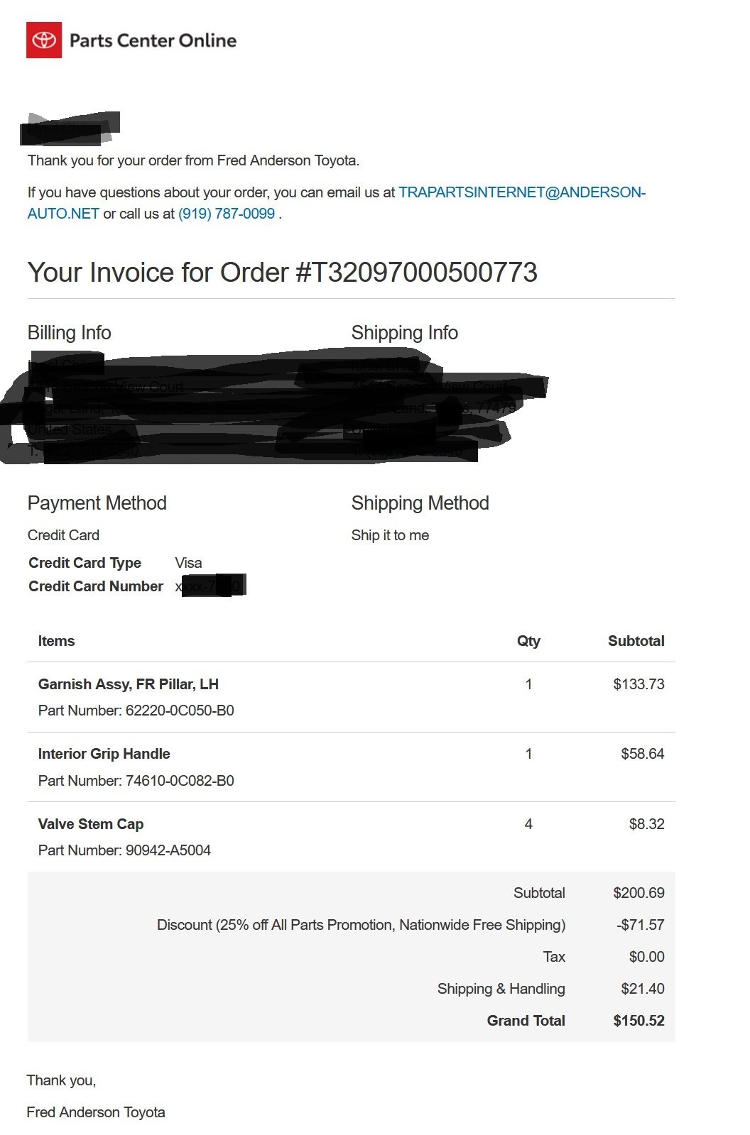

    Just got mine for $150 brand new

    I was able to add both parts to my cart, but I have the beige. I'm noticing gray seems to be the more in demand.
    $151 but the shipping wasn't free...it only brought it to $164 though. Now to head to the hardware store for the screws/bolts.

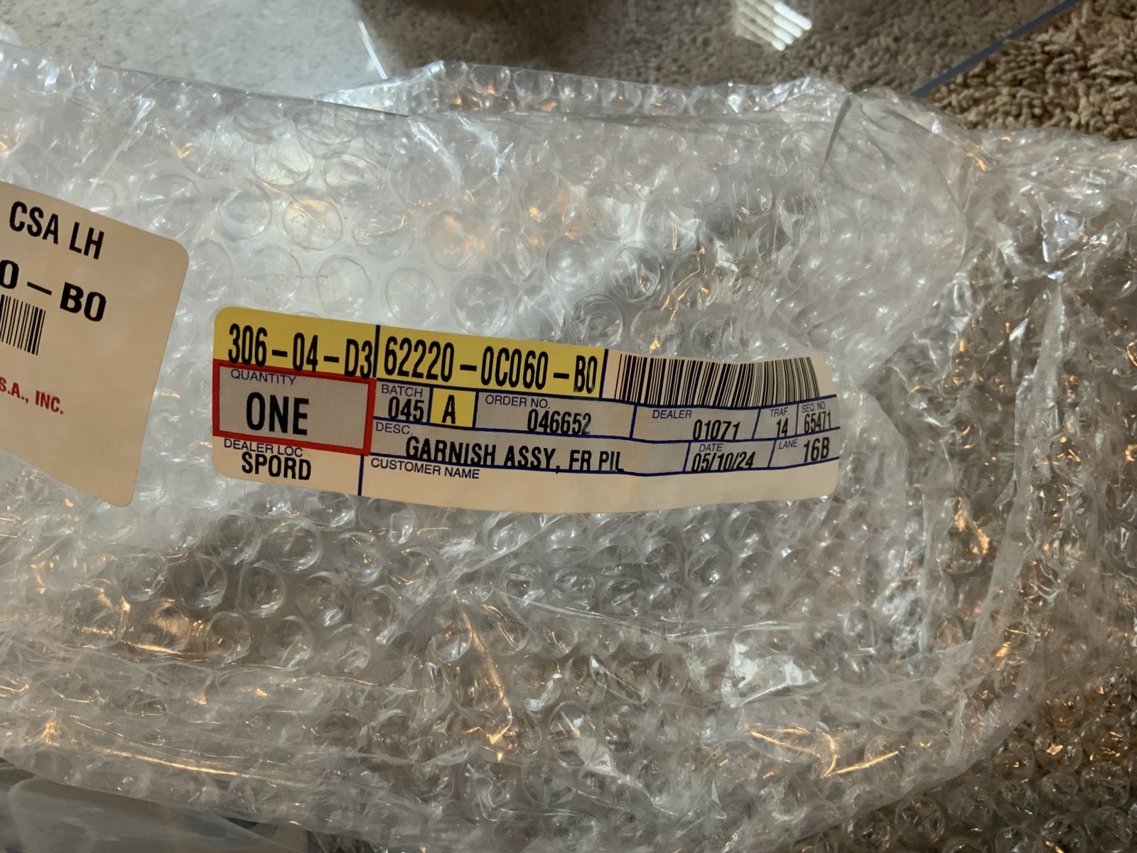

    That crushing feeling you get when you wait for over a month for a part to arrive… only for it to be the wrong one. :pray:
    What I ordered on 4/21:
    What I received on 5/29:

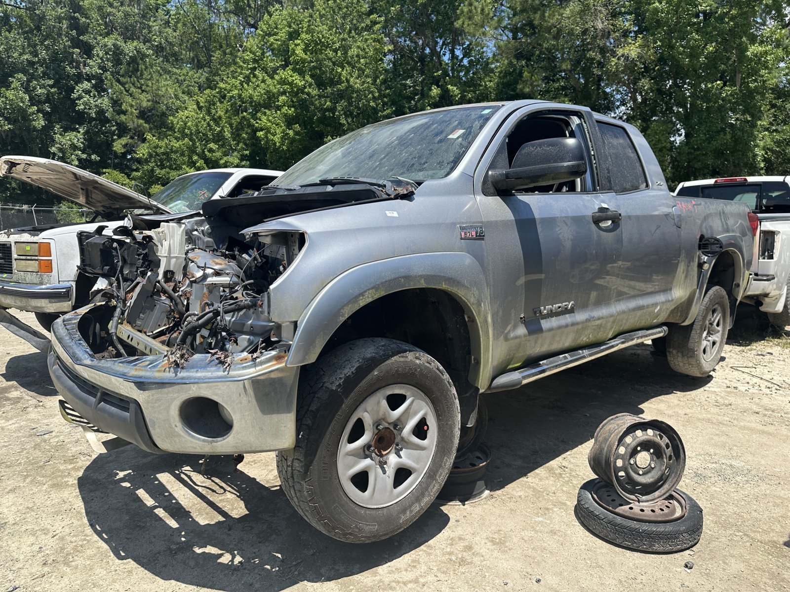

    I found a driver side grab handle in the junkyard and sold it after receiving my new handle from Sparks Part. These handle will fit 2014 - 2021 Toyota tundra but the color will sometime have a different tint.

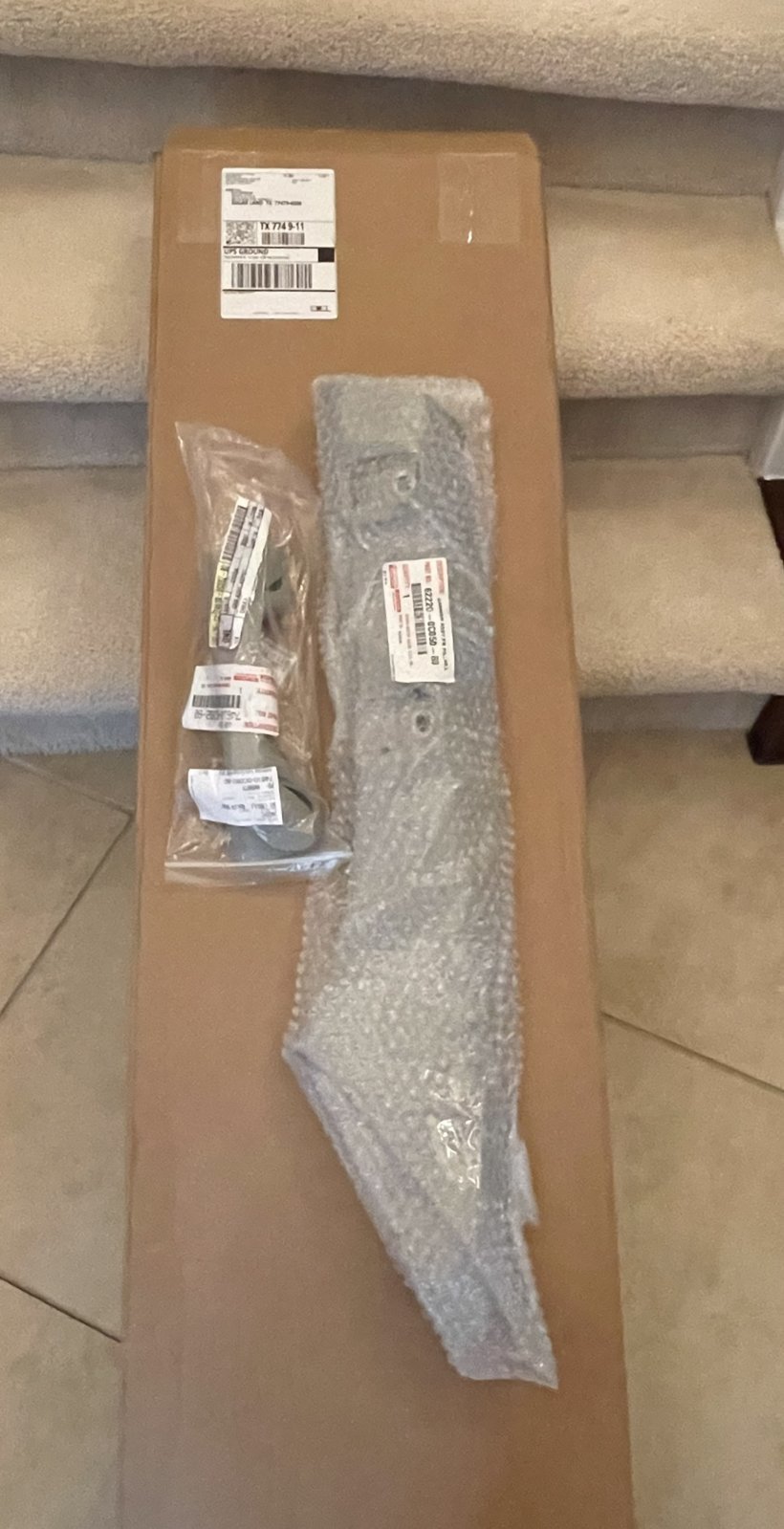

    One “oh sh!t” handle installed!
    If anyone wants some metric hardware for their handle, send me a DM, as I have plenty on hand…
    • M6-1.0 x 30mm DIN 933 A4-70 Stainless Steel Hex Cap Screw
    • M6 6.4mm x 18mm DIN 9021 A4 Stainless Steel Fender Washer
    • M6-1.0 x 23.50mm x 12.50mm Phosphate “U” Spring Nut (made for GM & Ford)
