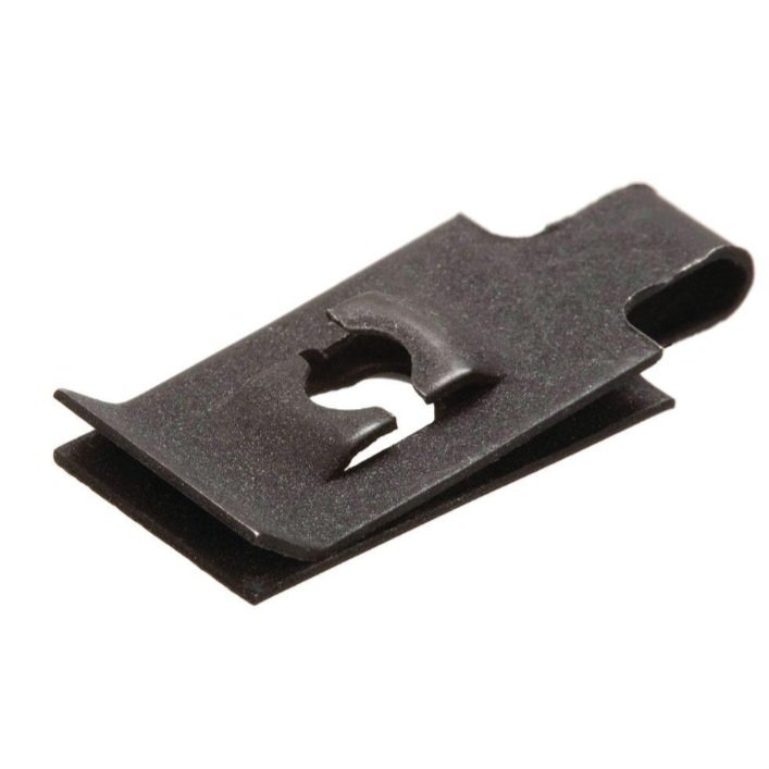

    Sparks “kit” is/was over priced. Buy the handle and trim piece from any Toyota parts store that will ship it to you, then go to hardware store and buy the hardware for $1.50.
    1.5” long 1/4”x20 hex bolt
    ¼” flat washer
    Extruded U-Type nut ¼”x20 in size

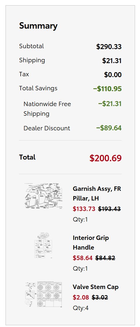

    Yeap just put the order online and added few things for the free shipping to Texas.

    Lol, you bought valve stem caps!

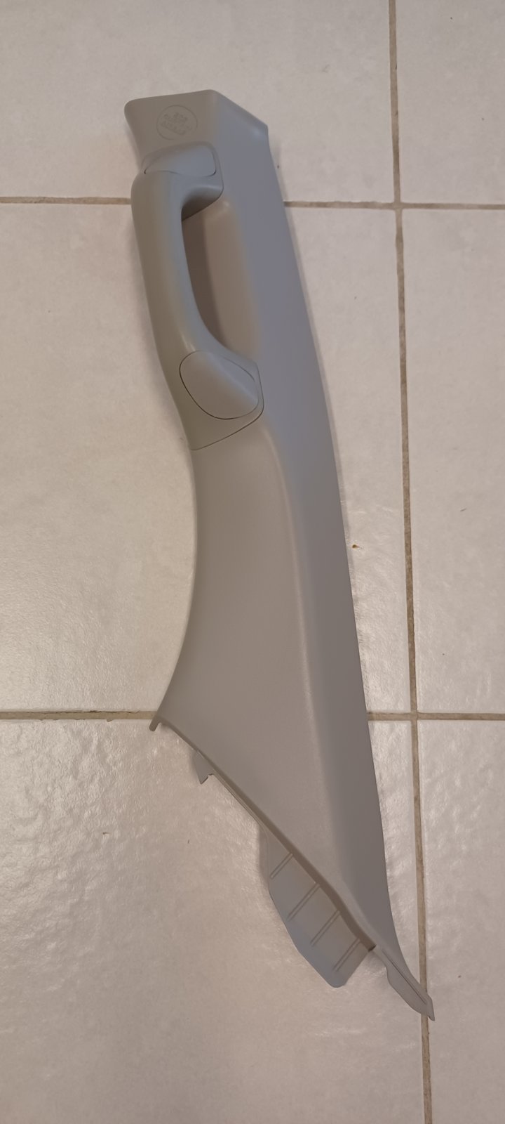

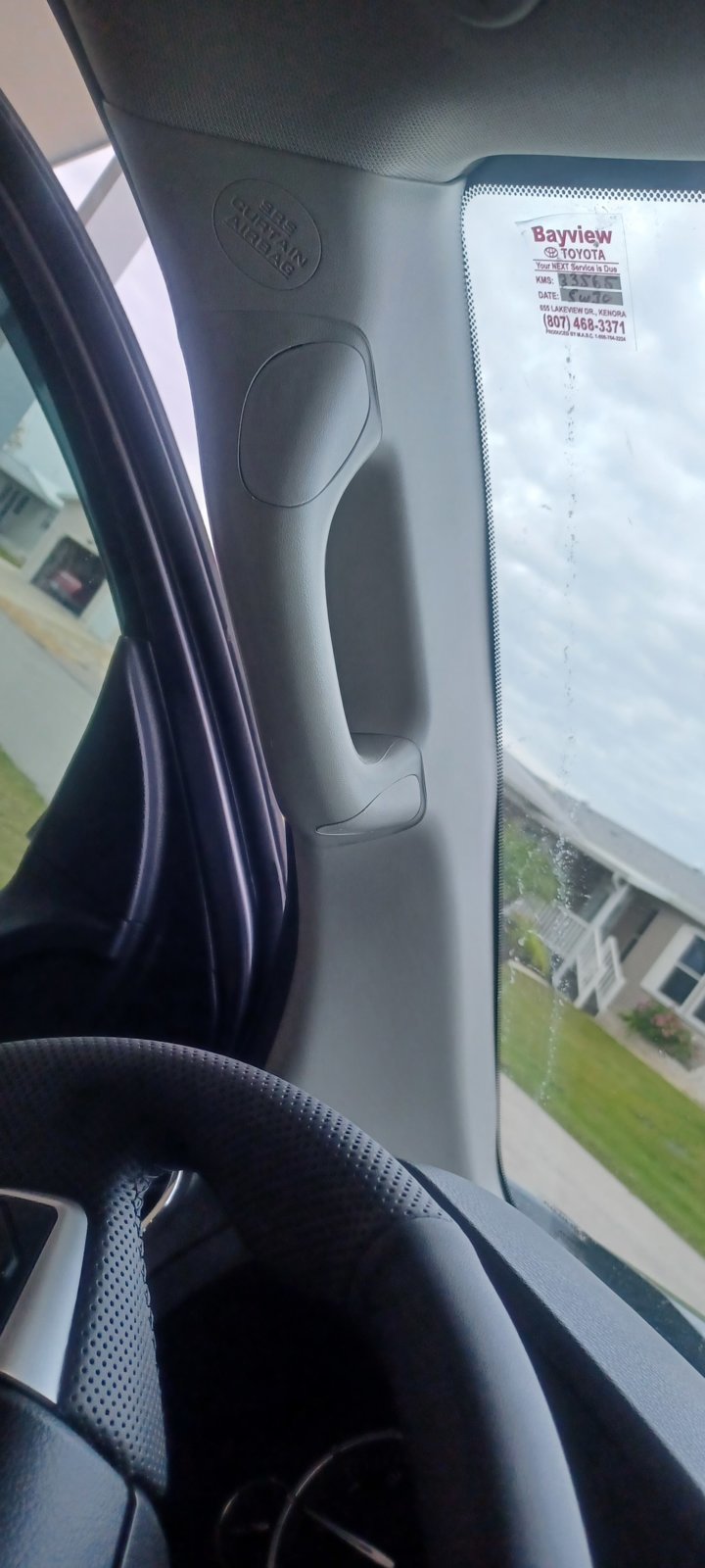

    Just installed. Works good. I used the two 8mm mounting bolts that came with the handle. A 5/16 speed nut worked well for securing the bottom of the handle.

    Nice job. Now please reference the beginning of this thread if/when you fixate on the fact that the plastic does not match perfectly.

    Not worried about it. It's the same as the passenger side and no reason to fixate on something that you can't do anything about.

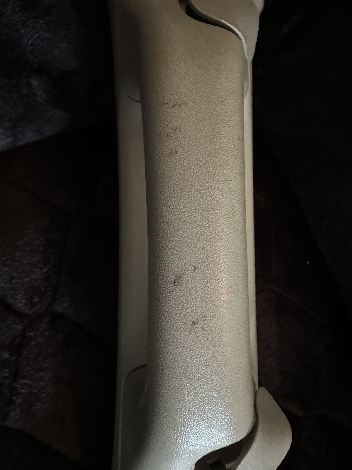

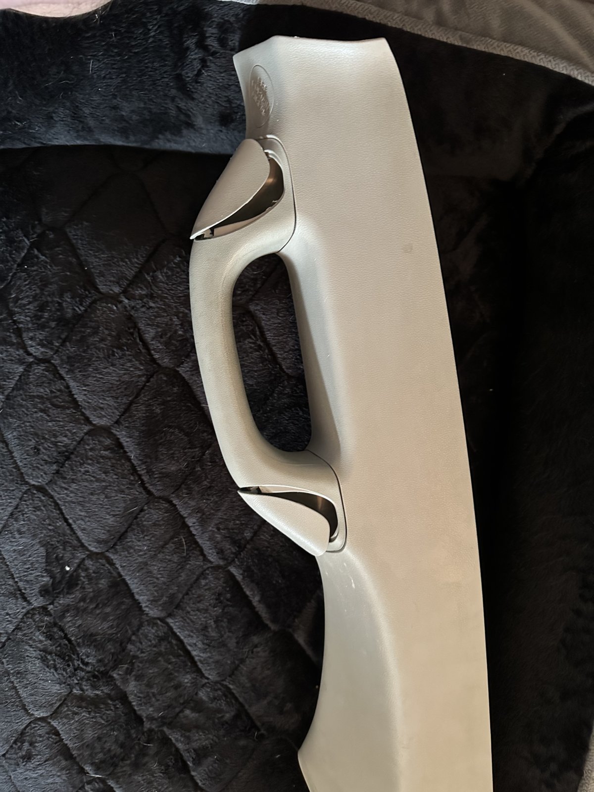

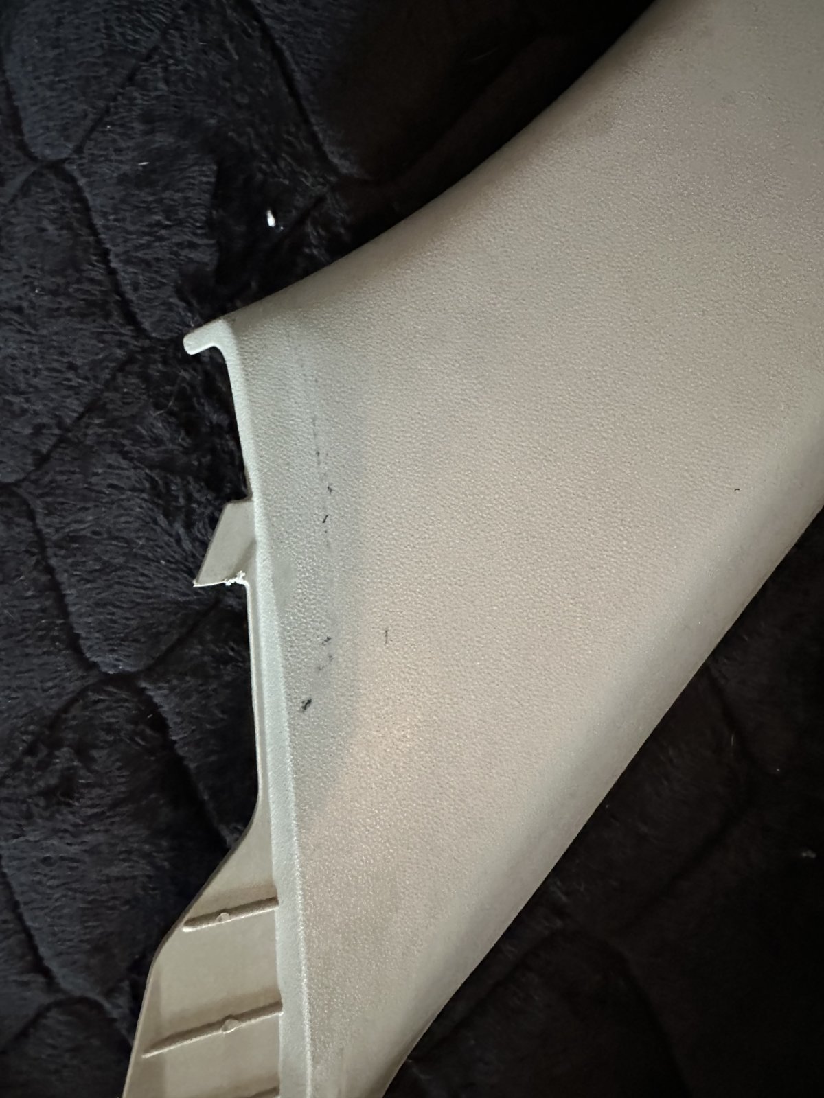

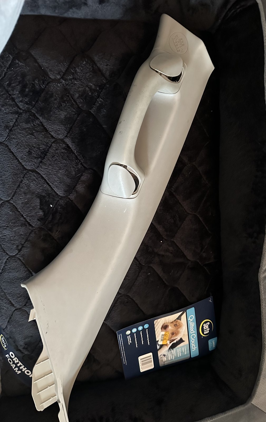

    I found one at a junkyard but they don’t allow you to pull it so I couldn’t see it until they brought it out. Is this cleanable/salvageable? If so what cleaners would be ideal to try to fix it? I tried dish soap but that didn’t work, considering using simple green.

    409, simple green, and decent cleaner will help.
    Let it soak on it a few minutes...
    Good luck..

    Mine looked worse than that and it cleaned up fine.
