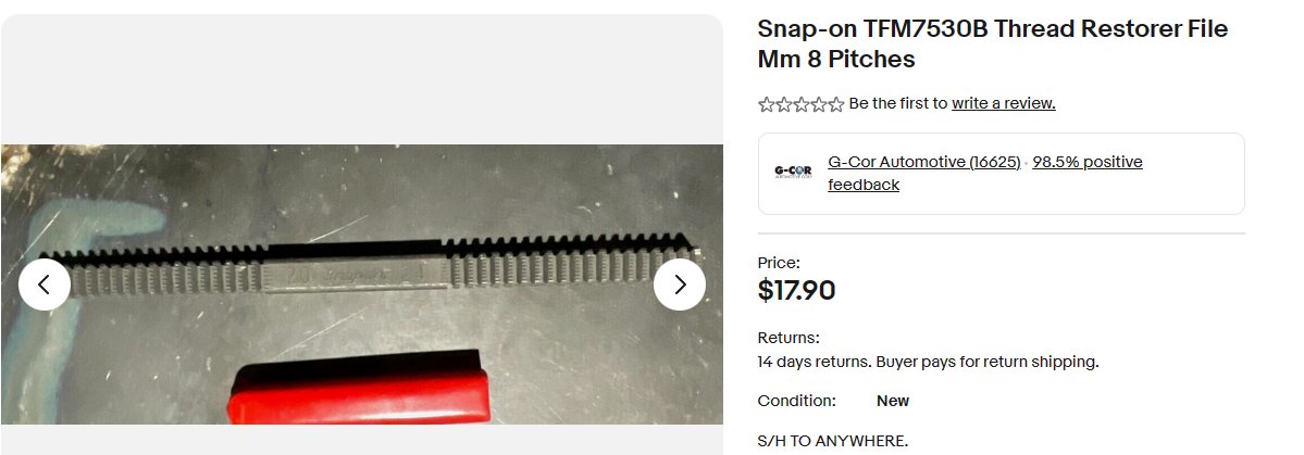

    We used to use these at work daily and they are a lifesaver. This one is metric. Screenshot (3).png

    A thread file has saved my butt several times. Before buying a new driveshaft I would see if a local machine shop could fix the threads inexpensive.

    Thnx for the help guys, I used a file and a hacksaw and was able to get the threads close enough for the nut catch and thread on. So the yoke is back on and gtg.

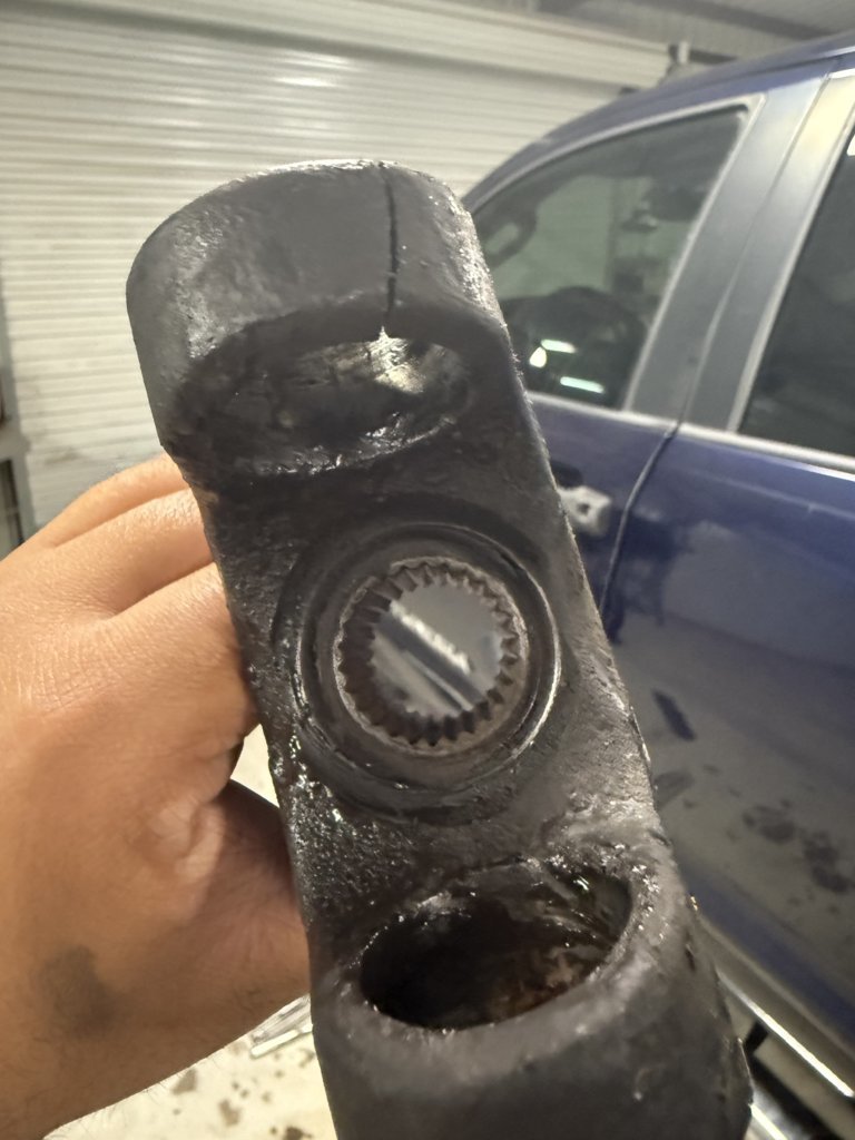

    Hey y’all, I was in the middle of replacing my carrier bearing, until i was trying to take the U-joint off of the center yoke, the socket and hammer method didn’t really work to i went and got a press set to get it out, but sure enough it didn’t work either and it actually ended up breaking the yoke. I can’t find the yoke anywhere, not even the dealership has it.

    Salvage yards will have many

    Toyota doesn’t sell them separately, you’d have to buy the whole drive shaft because they would have to be properly balanced.

    You can take any driveshaft assembly to a driveshaft and axle specialty shop to have it balanced. Sort of like a wheel/tire assembly.
