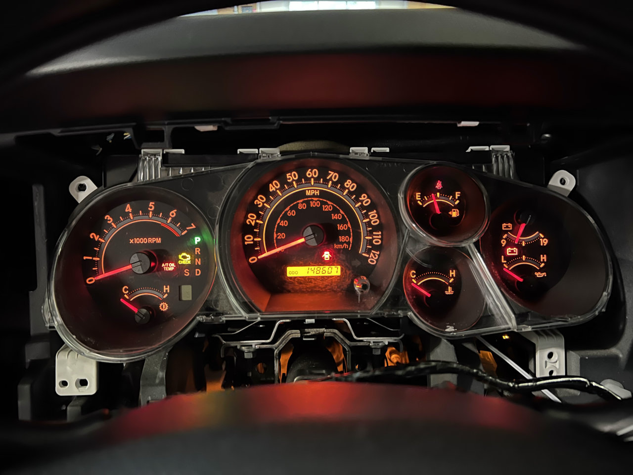

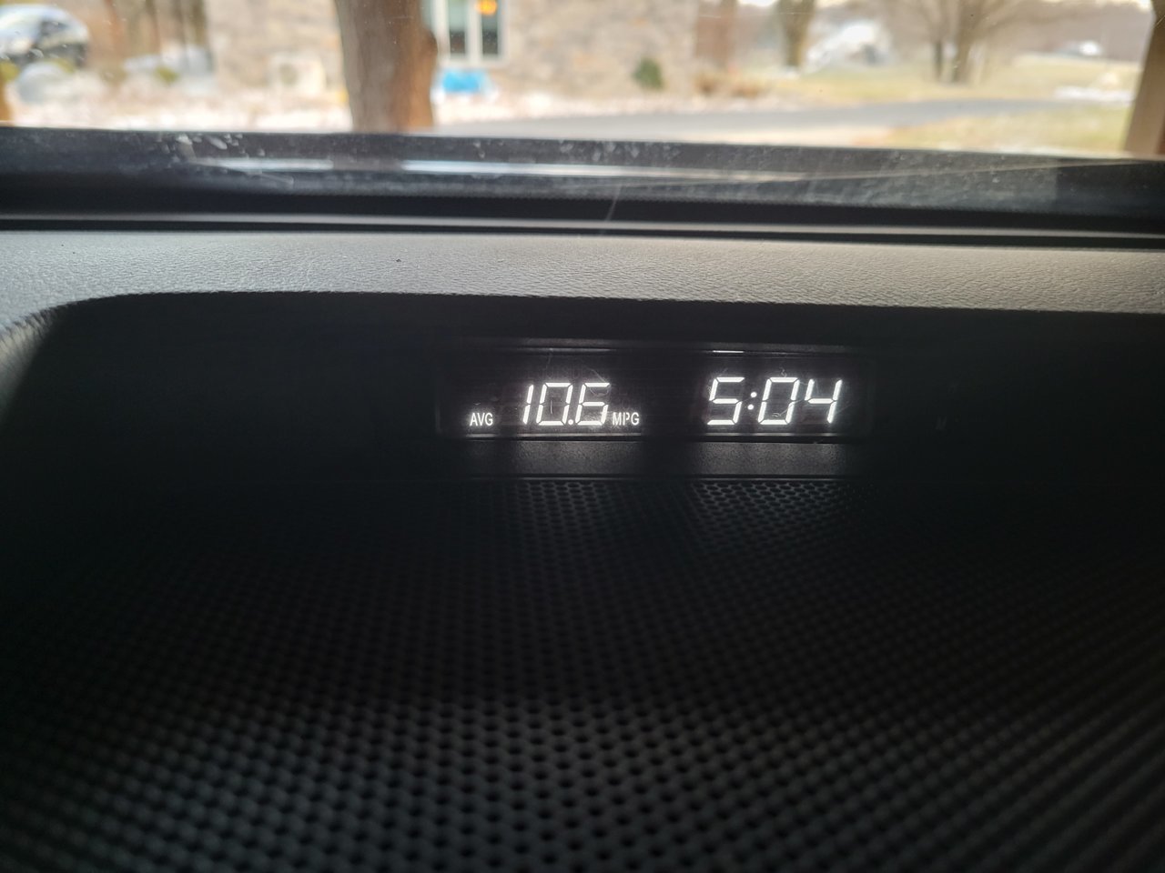

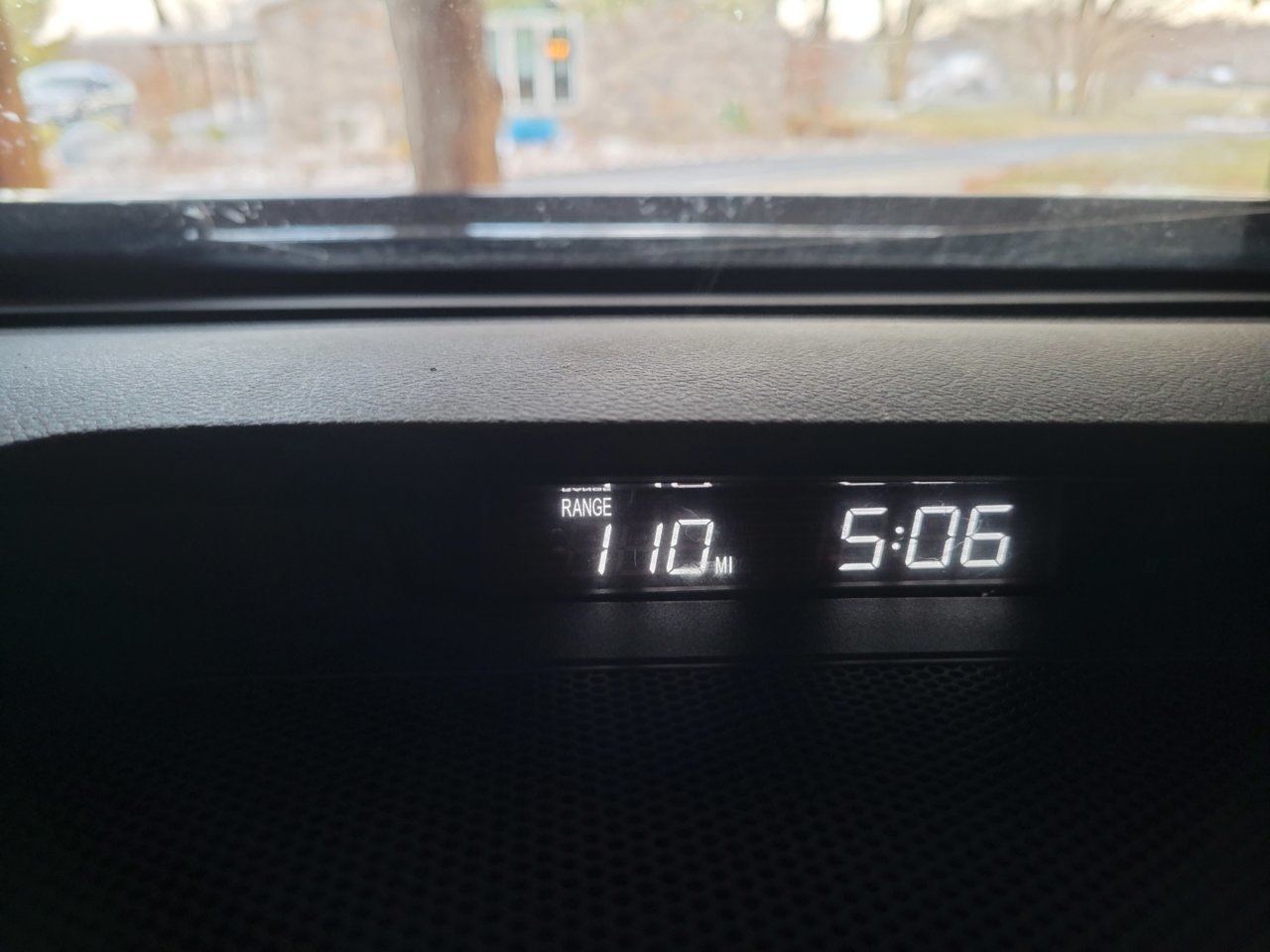

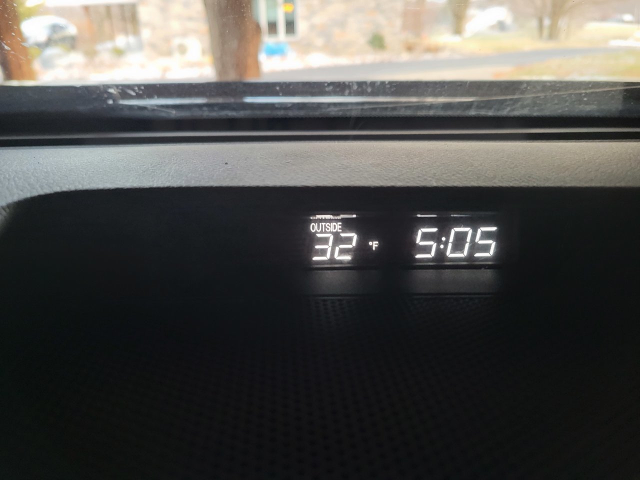

    BINGO.... Problem solved.
    Put in the used speedo cluster a little while ago and I now have ALL the functions. Took it for a few mile drive and see how bad the AVG. gas mpg is.:( .I was also a little surprised that the 103k miles that was on my truck, has disappeared. It now shows having only 17k miles on it. That's what was on the crashed truck this cluster came from.
    Shows me how easy chop shop crooks can cheat people. I thought my trucks mileage would transfer to the new cluster. 20230201_170646.jpg 20230201_170544.jpg 20230201_170511.jpg

    Awesome! I guess Canadian clusters don’t support the accessory monitor.
    Unfortunately the Milage data is stored in the cluster. Your new one will have to be corrected to match the truck. I can do this for you but I have to have the cluster in hand to change the memeory in the chip.
    Do the part numbers on the clusters match? You need to make sure it matches so fuel gauge and other things will work correctly

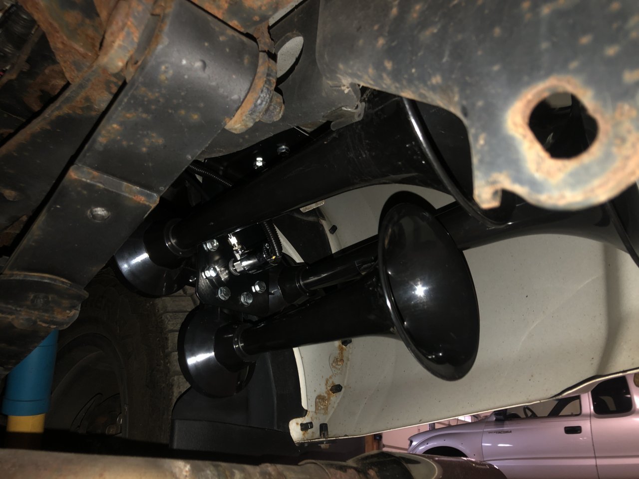

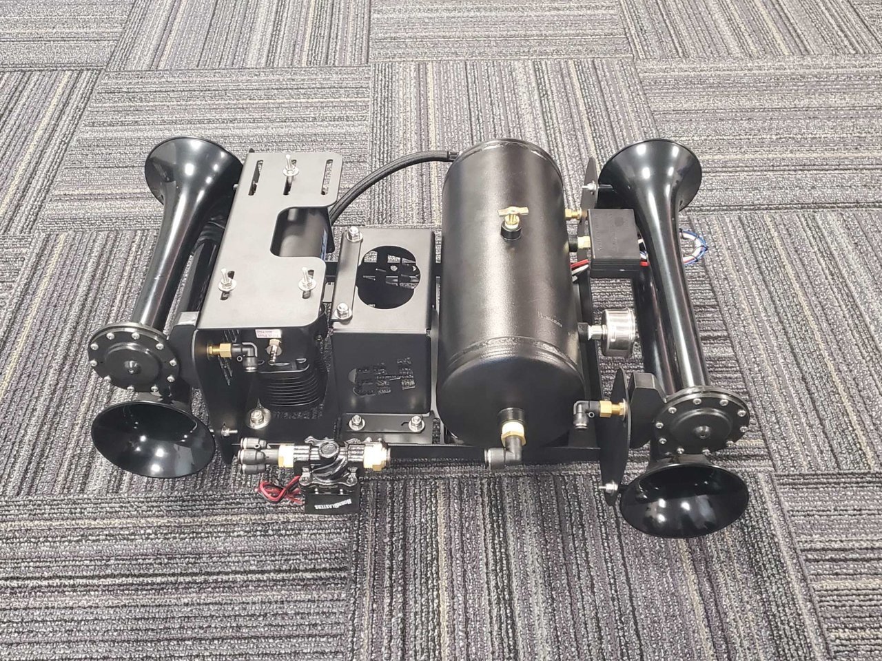

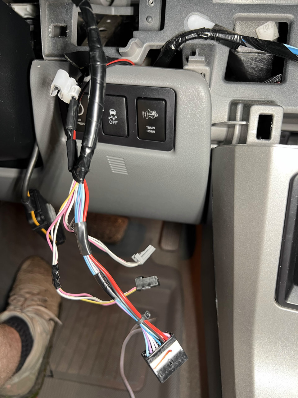

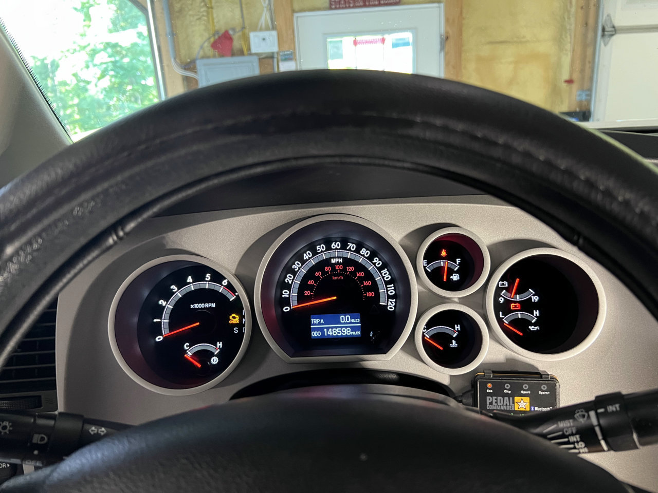

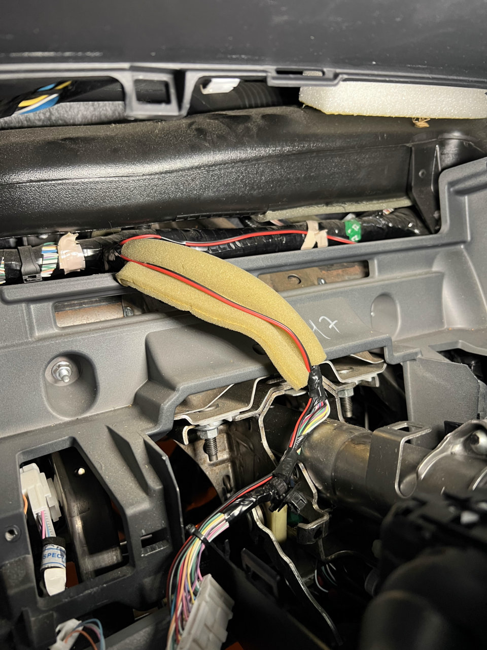

    Kaner and baraynavab, thanks a ton for giving all needed info for this swap. I wanted to follow up with my experience and what I found just to add to this thread and share my appreciation. My truck being a 2007 SR5 RCSB never had the option for optitron gauges, I purchased my cluster from Tanin Auto (linked below), I paid around $460 for it. I also bought a great condition used info button stack for $40. I went into this with no idea if it would work and it did minus the info selection option that is simple but necessary when getting this cluster. Enough threads led me to this page of which did the best job clearly showing what needs to happen, and doing so allowed the display and buttons to function properly. I found that with the old SR5 cluster with the new wires and button stack allowed the display next to the clock to cycle through options that it never did before but they stop cycling when the optitron cluster is installed. I am thrilled to have this upgrade in my truck and I appreciate the time put into this thread.

    I love the TRAIN HORN button on the dashboard. Wish I had one :)
  9. Aug 26, 2023 at 6:56 AM
    #39
    HalfATruck
    HalfATruck New Member
    Aug 26, 2023
    #102782
    2
    Chase
    TRD OR RCSB 07'
    It’s quite loud, also has the benefit of on board air

    Added Sonar Parking assist, Tailgate electronic Latch, Rear Hitch lights, Upgraded the Drive motor switch, Factory Fog lights with the column stalk, and bull bar. Soon to add Roll bars additional lighting and a Train horn.
    So I would like to add one more successful Drive motor switch addition to the tundra family collection, I have a 2007 Toyota Tundra regular cab, Originally with a Drive motor switch that had just the Fahrenheit button. I used the 0C090 option switch and added the two wires as stated on this forum. I also included sonar to my truck, and the switch is in full working operation. Thank you guys so much for the hard work and research to make the Modification optional.
