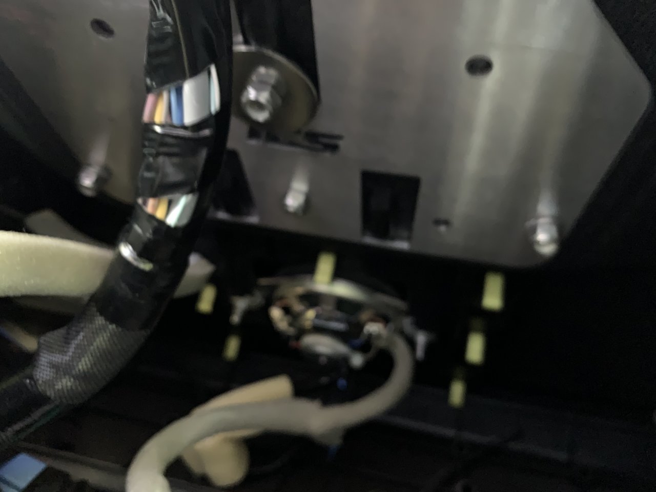

    I will get you a picture tonight, I haven't mounted it yet. But I did buy the underdash mount from ICS. I will get you a picture of that and the bottom of Rago. I checked when I got it and I will have to drill some of the ICS and use a larger washer to accommodate the Rago, but no one will ever see it.

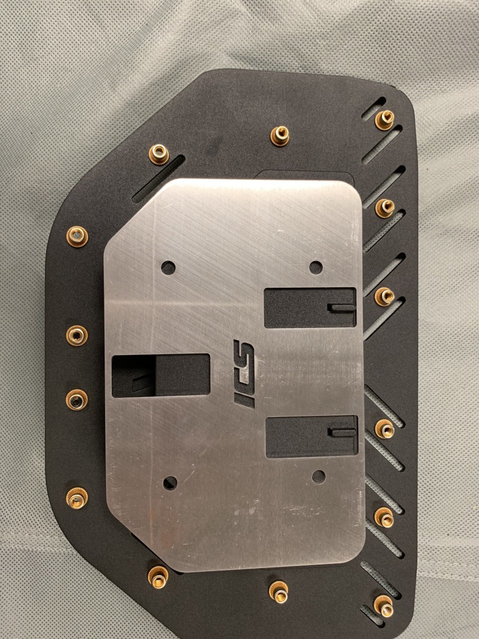

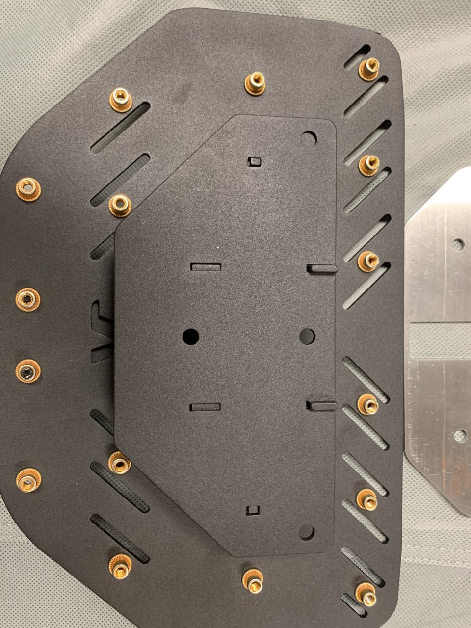

    Ok here are the pics.
    1. The drill points are completely different you will need to drill 4 new holes
    2. There are plenty of places to put mounts. You can really do any combination. You can probably fit 9 without trying.

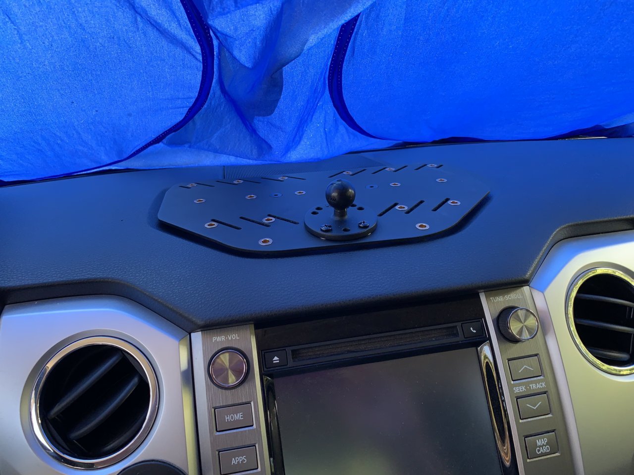

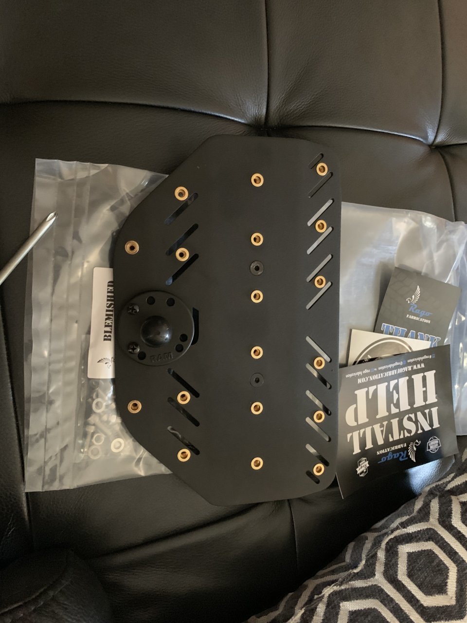

    Ok I finally mounted my Rago dash mount. Followed their video and everything was easy. I do recommend using the paper towel in the socket it worked great. I also bought and drilled the ics under dash mount. Whether you are going with ics or Rago the dash is flimsy with a mount on it. When drilling the Rago mount follow the video and only drill one hole at a time!!!! I drilled one checked figment drilled second. Somehow it slid a bit so it is not perfectly straight. You can only tell from certain angles but it is slightly off. Here are the pics. D92A186A-EF50-4C9B-A275-139F478ACFA7.jpg620E621B-61FE-4239-BE5E-7DF65BCCBE25.jpgEE0D165C-53CC-4325-A720-84DDE2748D02.jpgA6C01689-99DC-442C-A997-4696B9E177B2.jpg
