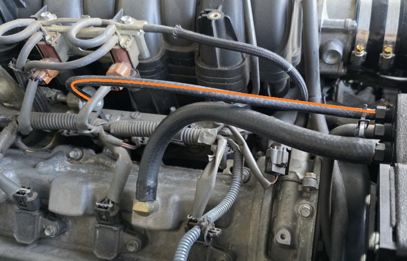

    List of things to check for P0174 (straight from Toyota's Factory Service Manual/FSM) is in my last reply.
    That said, first thing I'd check is vacuum hoses. First hose I would check is the one that supplies vacuum to the fuel pressure regulator on the passenger bank, which is running lean. It's this hose, with a traver in orange. You want to check it's attached above all else, and also make sure the hose isn't rotten/cracked.
    Yours may not look identical, but it's going to be coming from the same place and terminating approximately to the same place. Make sure the hose doesn't have cracks in it. This vacuum line (IIRC) essentially engages the fuel pressure regulator to open/close the fuel supply into bank 2 (which is throwing the lean code), and also acts as a vapor return for unburnt fuel that may escape the regulator.
