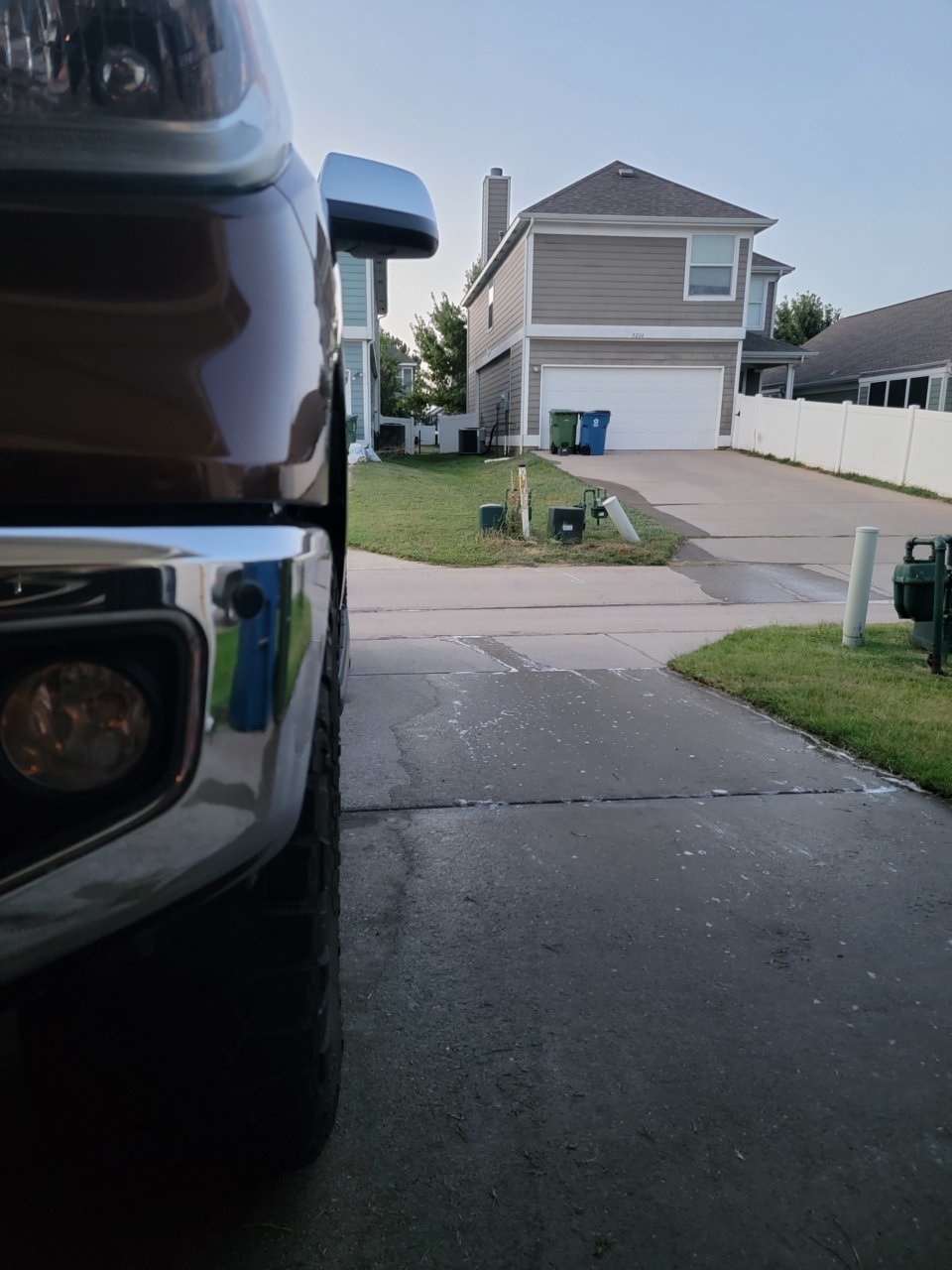

    Good to know. Thank you. I'm considering the Falken wildpeak and cooper discoverer XLT in 285/75r17
    I'll have to look them up and look at sizes. I know the cooper is about 8lbs lighter

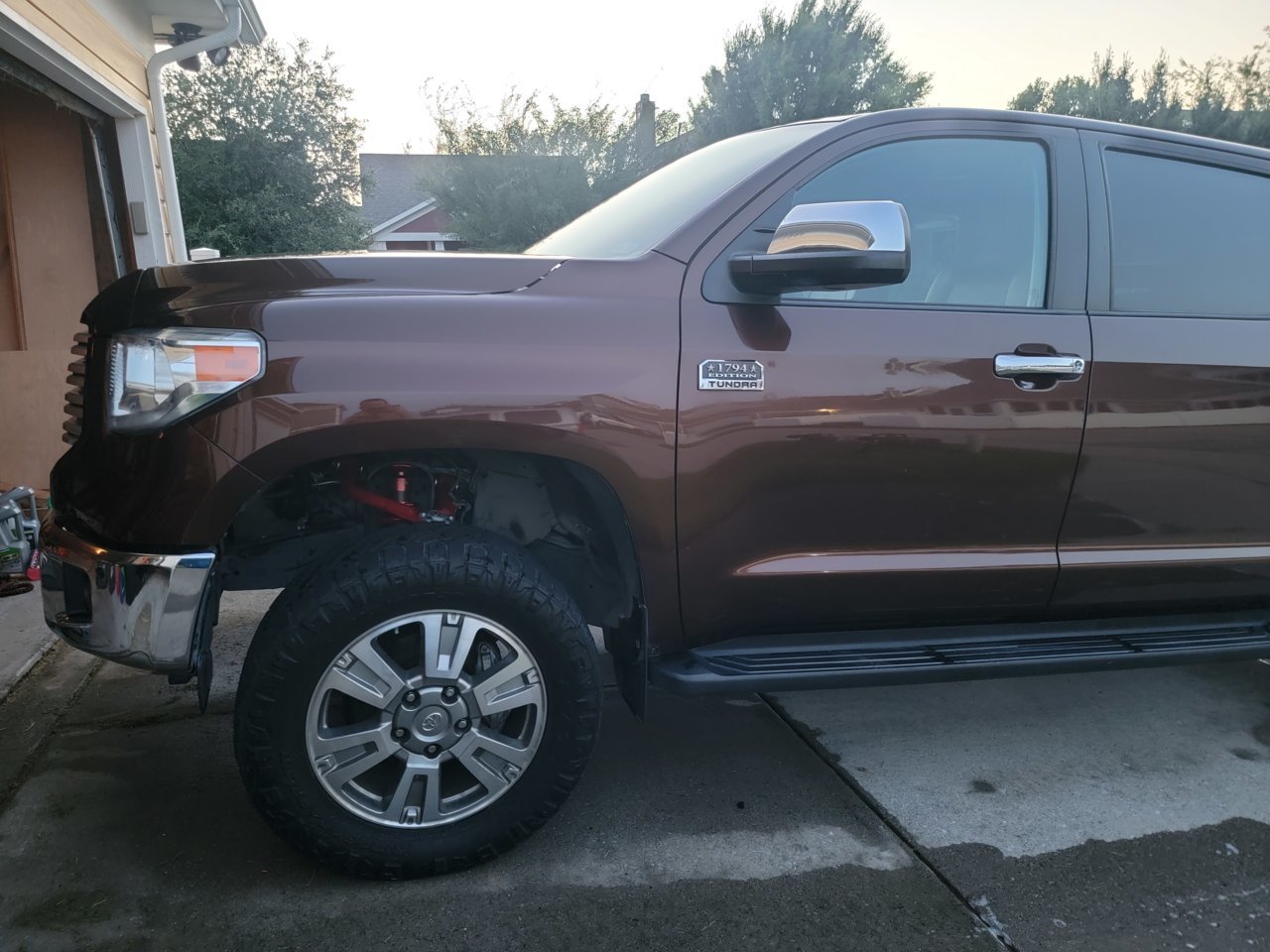

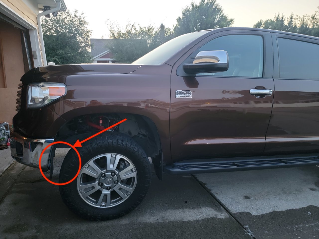

    In the side profile picture, there is a large hollow gap between the front of the tire and the rear of the front bumper. Is this a 2wd truck with no skid plate? Am I missing something here? That large void may be making the tire look much smaller because there is so much contrast.

    Here's the spot I'm referring to.

    I was also wondering why the front was up so high compared to my 3 inch lift.. its closer to 5 with the measurements that were given.

    I have the skid plate off currently. I have 4 mounting screws for the skid plate, but toytec only sent hardware for 3 spacers

    It's 3" of lift right on the money (measured before and after). It must be that skid plate missing making it look higher? I also have the front swaybar off because I had hell getting it back on after installing the lift lol considering a drop bracket or trying again in a couple of days

    Could be, lot of daylight with the skid plate off.
