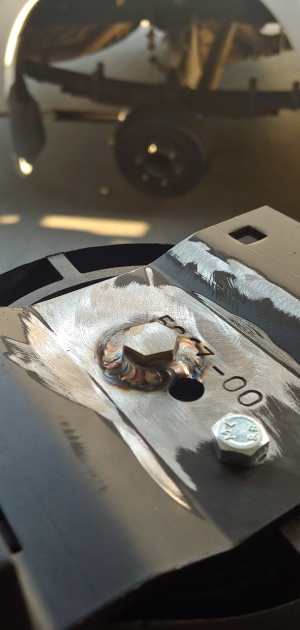

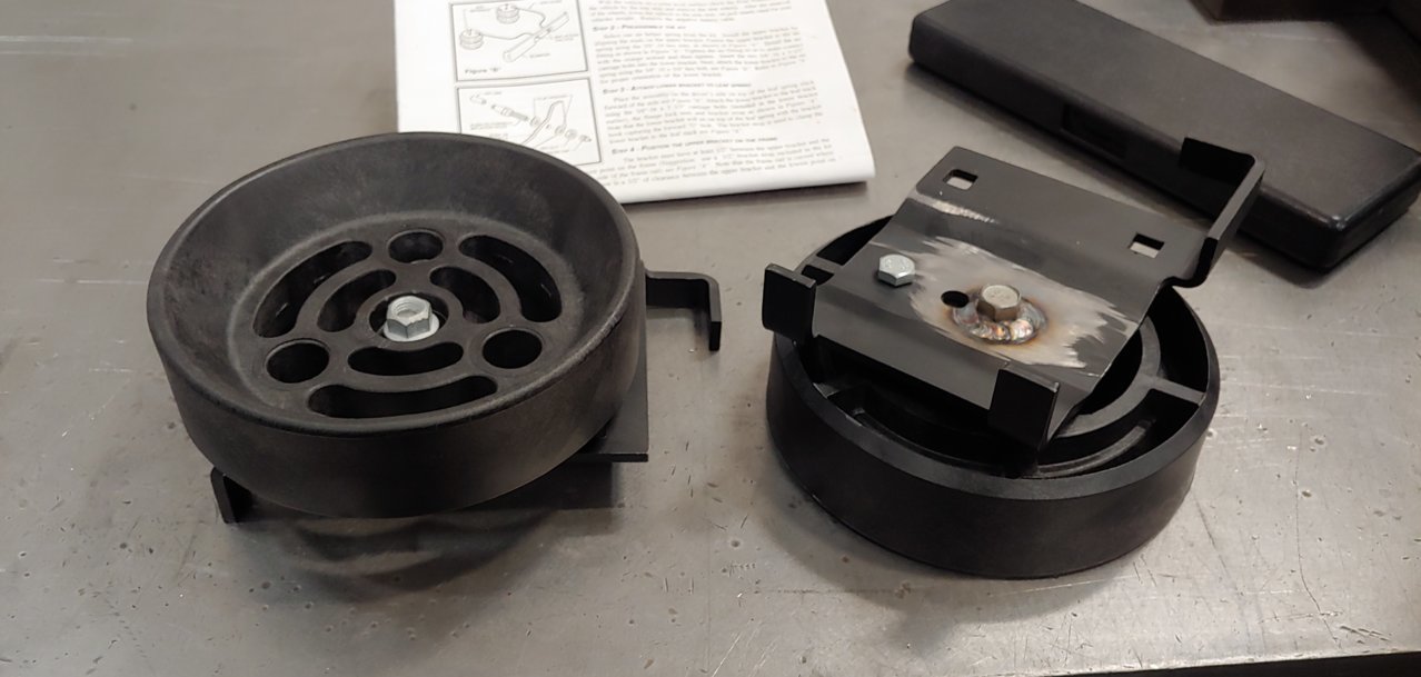

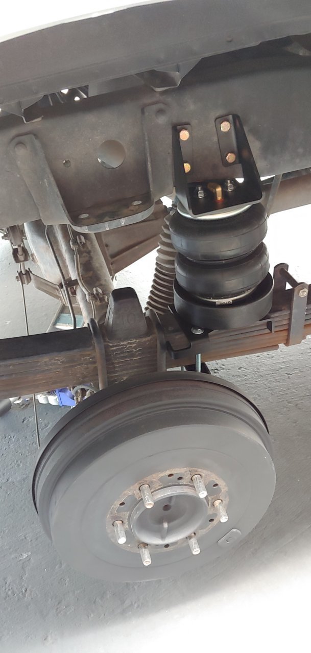

    Installed Firestone 2245 kit.
    Probably shouldve been the first mod, the difference is night&day.
    Added Daystar cradles.
    Slightly modded the mount bracket.
    Ran a bolt thru the bottom, welded the head(could've got away with 3heavy tacks, but had some fun instead) , decked it, now it acts like a stud for the cradles. In case the nut ever comes loose, it should stay in place.
    The second bolt stops potential rotation of the cradle.
