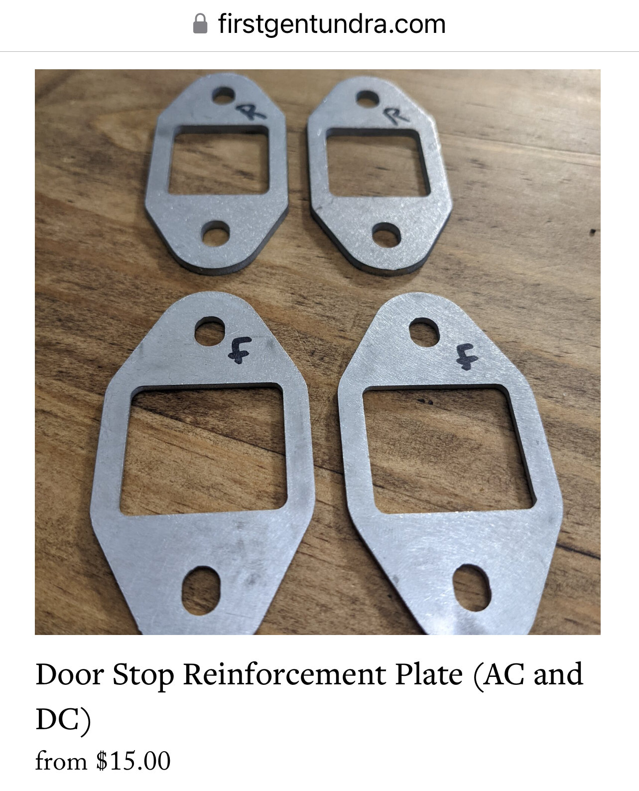

    Are there heavy duty Door checks that work for these trucks?
    I read a post sometime back where somebody modified Another check to work on this truck. Sure would be nice to have better ones.
    My front driver door had to be welded with a little fabrication to repair it after my door check went bad. I guess these could've potentially prevented that:
    HBTundra likes this.

    I've been eyeing those for a while for my DC.
    My doors are in fine condition . . . I was considering them for 'preventative' maintenance.
    I haven't searched on here for reviews, installs, thoughts, etc , but it seems like a good concept.
    Any feedback would be welcomed.

    I've had them for quite awhile now as preventative maintenance. Nothing bad to say about them. Install is not very intensive, with only three bolts per door. Should only take a couple of minutes to do each one.

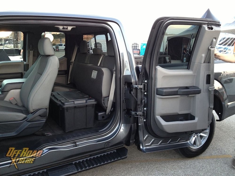

    Y'all be jelly of my Ferd Supercab suicide doors. They open all the way back against the bed. LOL :D
    Just like this.
