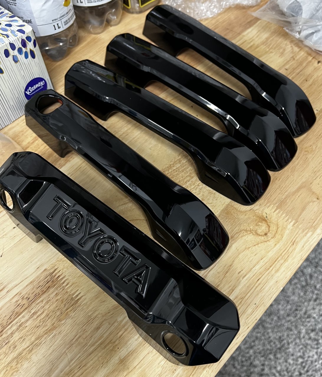

    I got the eBay handle overlays for $50 and they are a great option for chrome delete. I got the OEM tailgate handle and window mouldings too but haven’t tried the trim yet.

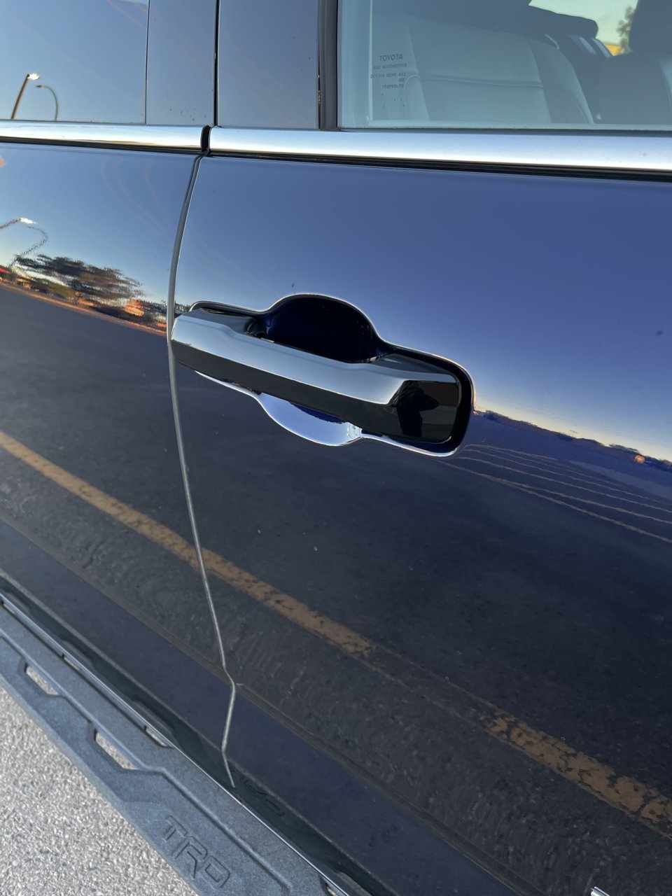

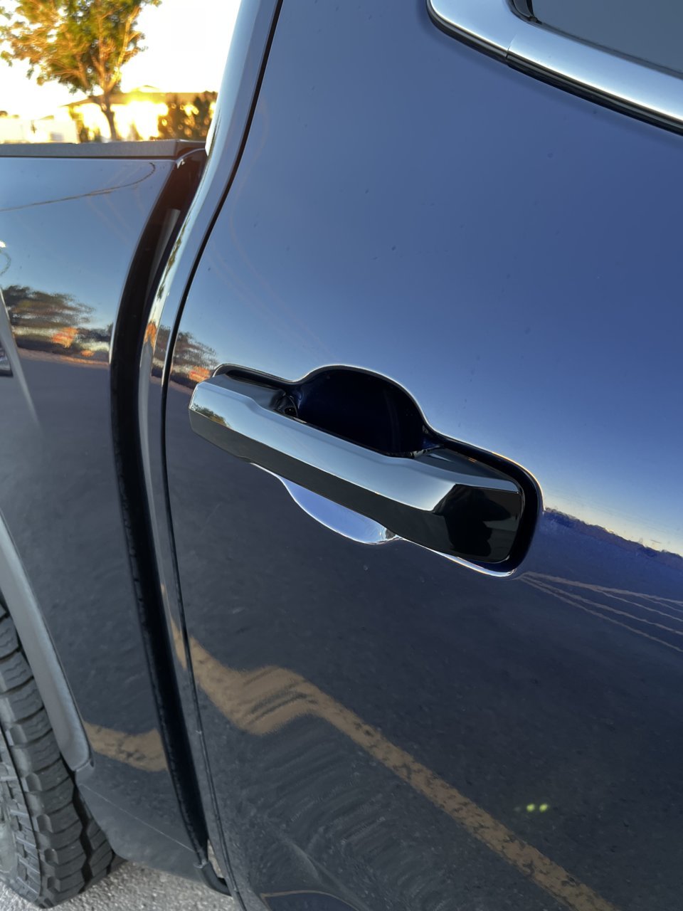

    Picked up all the trim pieces and changed them out for the gloss black, I found part # in the parts thread. The horizontal pieces are $245 each and the verticals are $100 each Canadian, I called the dealer and got them in one week. I followed the instructions posted in this thread and it’s not a hard job at all took me an hour. I started with the front doors and broke the single clip on both trying to unclip it, but did not break the clip on the rear doors. There’s no need not to break the clip if you’re not going to using the chrome again, to save time and effort on being gentle just push down with enough force to break the clip. Each clip is about an inch in each side from centre of truck. The front doors are very easy to pull off and pop the new ones on, scraping off the tape on the vertical pieces is the hardest part of the job. I put the vertical pieces on first and hinged the horizontal piece into its clip end, there was a hair gap between them and I just opened the front door and pushed them together. I had the weather stripping gap before so nothing chances there. I couldn’t find a wrap option for a cheaper price but I like that this is a permanent OEM fix compared to wrapping or plasti dip. I recommend doing this job for a chrome delete

    Yes it does, that’s all I use is the handle to lock/unlock the truck.

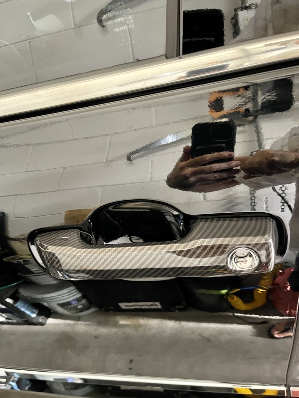

    2F68C52D-C062-4F7F-AA61-AE3B319936D6.jpg So I got the carbon fiber ones from China and not a fan of the look.. ordered black as I shoulda in the beginning.
    they do work fine btw with the touch lock but I replaced the tape with actual 3M.

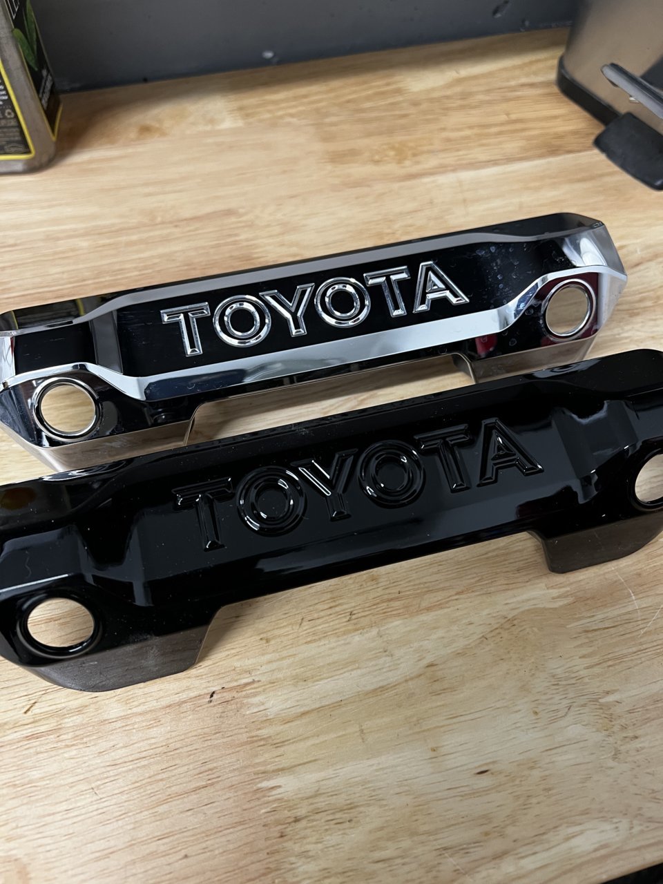

    i got the tailgate handle from Toyota because mine has two holes and the one from eBay only had one, I think it’s a trim thing. The overlays have been great so far, I go through the automatic beater car wash a few times a week and they are still on, can’t beat them for $50
