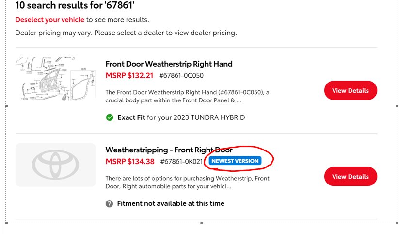

    The 3/8 foam weatherstripping filler does not work, it is too fragile and tears in half. I ended up using 1/4" and 3/8" nylon rope through the weatherstripping on the cab to fix the rattle noise. I tried 1/2" I still get a little wind noise. It seems like they are using 1/4" gap filling weatherstripping to fill a 1/2" gap.
    I tried ordering the above part number for the door weatherstripping hoping to receive the weatherstripping from the video. I received the same light weight weatherstripping I already had.

    I can confirm that the seal swap out works! As for mirror noise my drivers side mirror actually rattled and it was completely swapped out with the seals all covered under warranty. The door seals are a complete swap out of inner and outer door seals. TRD Jon has the seals part numbers in his video. Heads up the seals aren’t cheap. Charged my dealership like a grand and my drivers side mirror was $1,500. But it solved my rattle, window ticking.

    My local dealer and corporate got tired of dealing with it. The issue I’ve seen to find is when you go on a road test with the techs they all say they don’t hear it cause their hearing isn’t all there cause of the air tool….. but I hear it clear as day. I’m just gonna wait a bit and replace the seals myself. Seems like the sequoia seals have the same part number so I’m gonna use those and report back my findings
