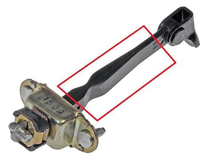

    Last person on here I saw use wet lube on their checks, the check stopped catching. They got lube on the part Im boxing in red, if memory serves. Afterward, the door just slid right past the detent, and kept on going.

    Decided to paint just enough super lube on the arm facing (away from rubber) sides of the new plastic ramps to allow dry graphite to stick. Was quite tight to repack, lube was key. Works great.
