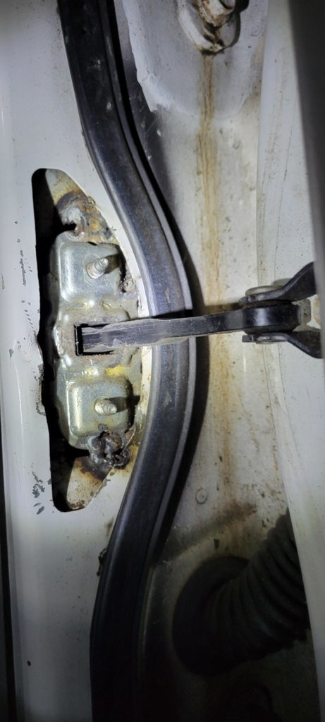

    Update to my update above... pulled the passenger side door check and it turned out to be original or similar since it had the part at the top that can be twisted off. I did that and then tried to remove the case as I had on the other one. It didn't have the 4 tabs like the newer one, but no matter how hard I tried to split the case, it just bent the ends and would not open. Upon further inspection I found that the two bolts that attach it to the body had apparently had a couple of tack welds on the back to keep the case from coming apart... ever... again. So it looks like someone replaced the "squeezy bits" before and didn't want it to fall apart. It didn't, and, sadly it won't.
    So I threw it back in and I guess I'll either have to pay stupid money for a new one or find a used one somewhere and rebuild it. At this point I think I've worked on it long enough and I'm just going to spring for a new OEM. $90. Why? Dunno. You can buy the same part for the Gen 2 or 3 models for under $30. Insane, but it is what it is.

    I'm a bit late but some folks have drilled out the tack welds to remove the studs and just replaced with similar sized bolt/nut. That would work also and save you money.

    Been there done that for the driver side but due to previous owner’s “fix” I wasn’t able to do that for the passenger side. Earlier posts detail the whole saga.

    This reminded me of my door check that was yanked right out when I bought my truck. Luckily there was one in the parts tote that came with it. Went a little cave man flux core on it, but at least I have a stop now. No detent though... :rofl:
