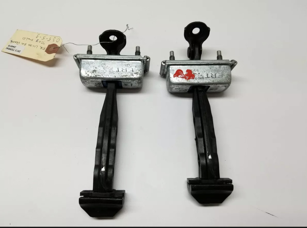

    The more I look into this, the more I think these things are universal. I looked at the old ladies 2014 GMC Terrain and I’m almost certain hers would fit my tundra. I think as long as they have two bolt mount and the third eyelet at the end, they would fit.
    GMC Terrain Door checks
    I
    did order the mother Russia kits so I will rebuild my old ones. I watch that YouTube video posted and they seem to work solid. I can’t wait to have this problem finally fixed.

    Both can be used on either door. On one side it is stamped "LR" for left front but if you flip it over, it says "FR."

    Gotcha. But they are the same length for sure
