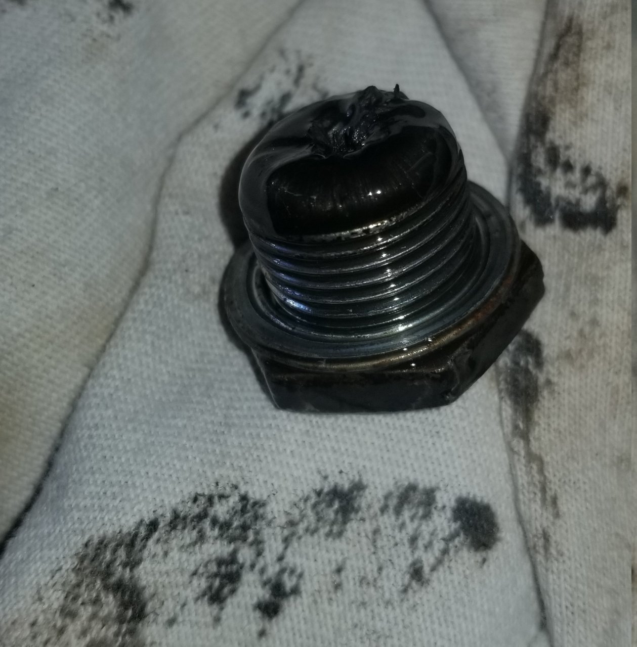

    I had my diff oil changed two weeks ago at 85K miles. I didn't get to see it or smell it, but the guy doing the work said it was "extremely dirty". Had the transfer case oil changed too.

    I wonder what the drain plug looked like. It is magnetic and will collect shavings and sludge.
    This is what mine looked at around 153K. The dealer had done it previously at 75Kish.
