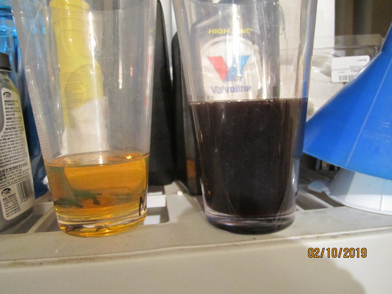

    Finished.
    I think the new gear oil smelled exactly the same as the old gear oil, the color was almost identical as well. Practically nothing on the drain plug magnet, no shavings, just a fine layer of black dust from the ring and pinion gears wearing in.

    I did mine at 142k and it was just as black as that. On a side note, I think diff fluid is the worst smelling oil. But prove me wrong

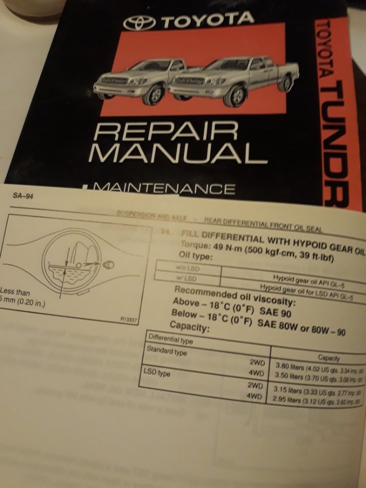

    Excellent, I just looked at the manual and watched some helpful videos. Looks simple enough.
    I have 2 Tundras that I'll be doing this job on and I have supplies already in the garage. A 2WD 2002 and a 2000 lifted 4x4 with big tires... 305/70/16s. I'm wondering if a thicker oil may be needed?? Temps here get below freezing in winter, to above 100 in summer. Idaho.
    Manual seems to call for 80w90 in the rear and 75w90 in the transfer case. If I'm reading it right.
    So, I have enough 75w90 for several jobs, covering me for that exact spec in the transfer case. I have all new, 8 qts. of Valvoline full synthetic 75w90.
    I also have 8 qts. of Chevron Delo 85w140 that I scored on a great sale. I also have about 3.5 qts of 80w90 but 3 different brands (Quaker State, Valvoline, and another) of I presume conventional stuff, partial bottles GL5 specs, garage sale finds; opened, but clean/new/partial bottles. Anyone run a heavier gear oil due to tire sizes or stick with recommended? Can I mix these safely? Is a small difference in weight (75w90 or 80w90) a big deal? I surely can go buy exactly what it calls for but it would be nice to use up what I have in my garage first if it's fine... Otherwise a trip to Autozone is in order.

    By the way, I have 3 telephone book sized repair maintenance manuals for my Tundra. I've often tried referring to them. They are so far quite useless... Huge gaps in explaining steps, big blank pages, I suppose so that the owner can make his own notes from experience or research. A full 3/4 of this page is blank, and there are no helpful tips, steps, or even complete details of how to drain the fluid or put new fluid in... If you didn't know how to do it, or be told, or see it done, you'd be lost following this information.

    In fairness to Toyota, the FSM isn't written for the consumer, it's written for trained techs.

    The smell is the additive that does the work. You should worry if there is no smell.....+1 on the Mobil 1 gear oil, it is good stuff.

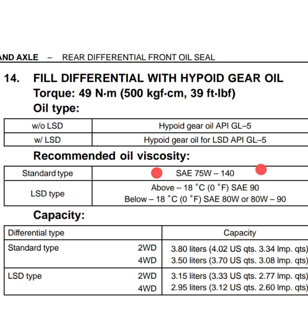

    So I just downloaded the fsm from a link on this forum some where. And this oil weight spec is different from my owners manual. Not sure if I should go back to AutoZone and exchange or not... Gut tells me to stick with the owners manual, but maybe there is a bulletin or something updating it.

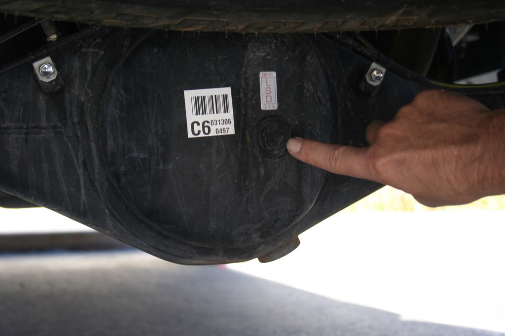

    Isn't the LSD a TRD after sales upgrade?

    LSD is an option on some trucks, but it's not part of the TRD package.
    The quickest way to tell if you have an LSD is to see if your diff has a sticker. Second easiest is to plug your VIN into the Toyota owner's site and it'll tell you there.
    Interestingly enough it looks like the LSD wasn't an option on the 01's according to these brochures. https://www.tundras.com/threads/1st-gen-tundra-brochures.91566/
