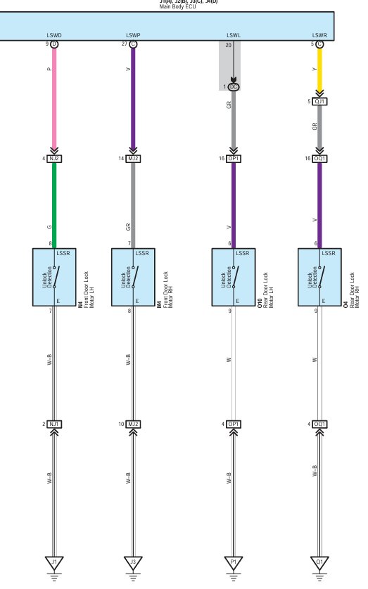

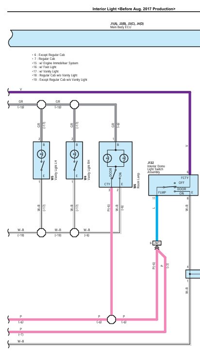

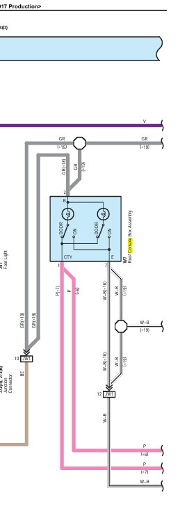

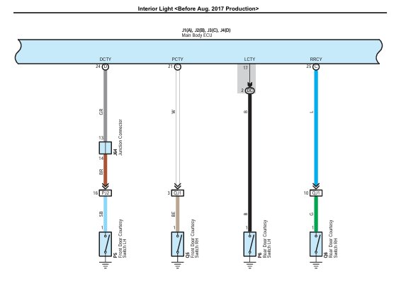

    I never definitively figured out what my issue was.
    My lights didn't stay on when I closed the door.
    Something was grounding the circuit and setting off my alarm in the middle of the night.
    I was trying to figure out what was causing it, and I did that with the console, and it never happened again.
    Something is grounding your interior light circuit.
    Be it in the roof console;
    It's possibly a bad door switch, but all they do is ground the circuit when the door is opened.
    You could disconnect one at a time and see if that resolves the issue.
    Or it could be a door unlock detection switch being that it grounds that circut when you unlock the door and turns those lights on.

    The wiring diagrams can be found here
    Ultimate TUNDRA Wiring Diagrams Collection | Toyota Tundra Forum
    Those 2 circuits don't have any connection that I can see.
    I'd post the BSM circuit, but it's 7 pages.
    Is it both the console/map lights and the rear dome light that do this?
    Have you measured the voltage at the socket or somewhere on the console circuit board with everything off?
    Probably easier to pull the console again and measure stuff there.
    Also, check and make sure those lights have a good ground.
