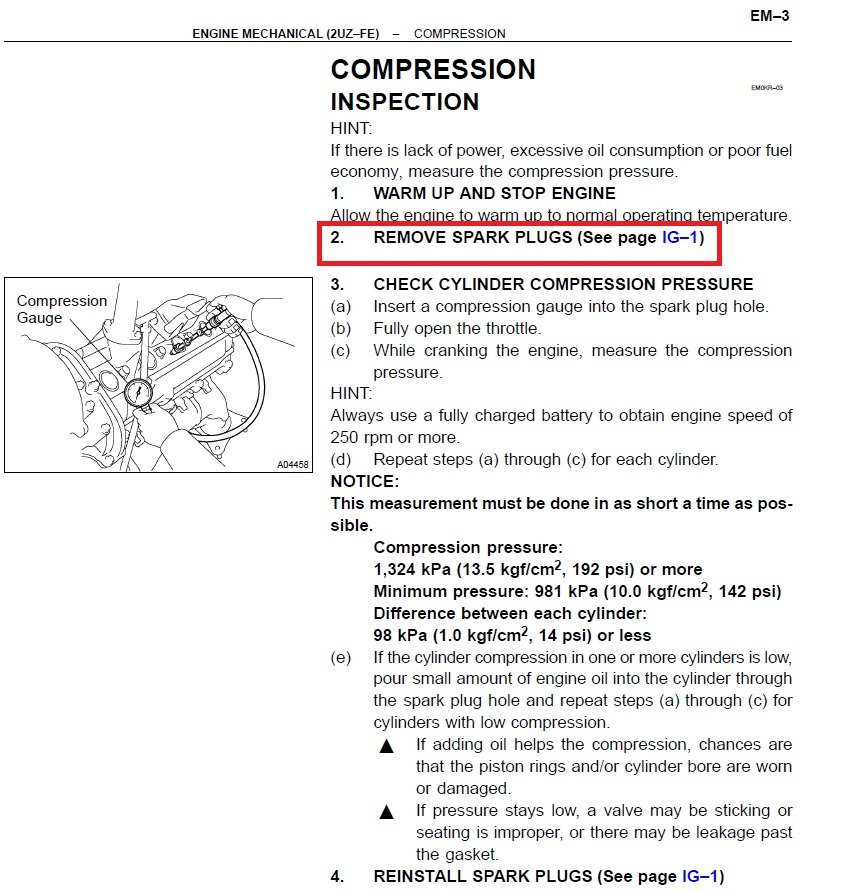

    Let’s clarify terminology here. Turns over means when you turn the key the engine rotates. Now, due to the super sketchy belt and possibility of damage done, prior to trying to start it, did you do a compression test?
    BroHon and Sirfive like this.
  5. May 12, 2025 at 7:20 PM
    #35
    NOLUBEZ
    NOLUBEZ [OP] New Member
    Apr 25, 2025
    #134012
    14
    Justin
    2000 White Tundra SR5
    No compression test. Guess I should give that a try next.
