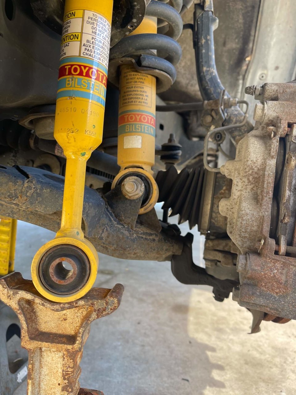

    ‘02 Limited AC TRD
    Bassani cat-back
    155451870_10158940436125275_460627186309_4dd240d4ba3a3135f47d56b4eaf37a9f6b69e3fc.jpg
    i couldnt install longer shocks without preload. And it seems like uca’s and diff drops are a good idea up to 2.5”.

    Have to separate some of the suspension components to get the longer shocks in. Need to droop the lower A arm all the way down. And diff drops for anything OVER 2" is a good idea. Also sturdier CV boot clamps if 4WD, believe the OP is 2WD so he will need neither.

    That’s a nice looking truck! Did you have to do anything else after replacing the shocks? Diff drop?

    Those look more like 2nd gen shocks.

    Theyre from a 3rd gen taco.
