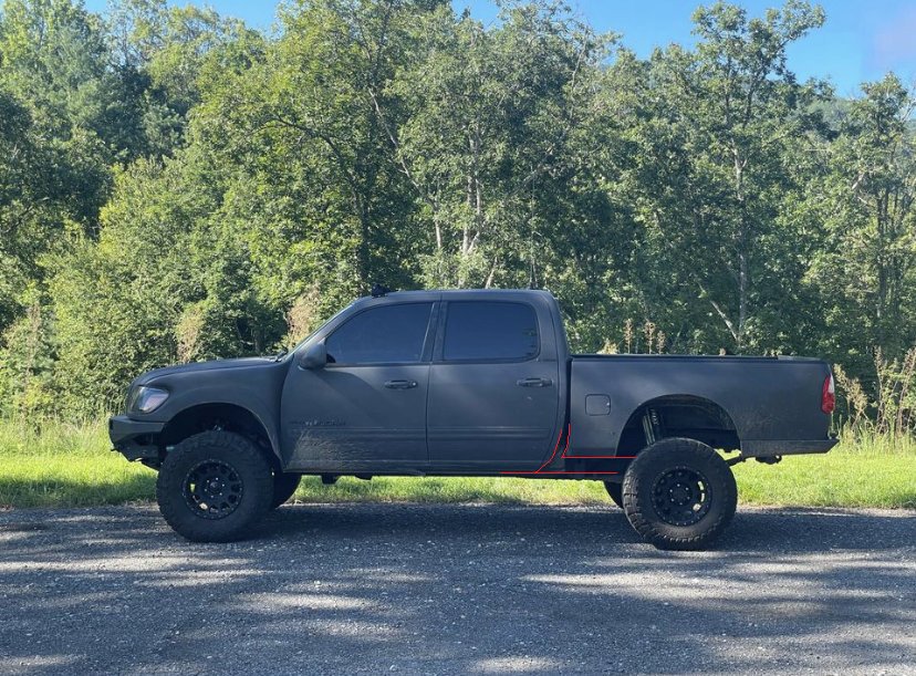

  12. Mar 19, 2025 at 5:30 AM
    shifty`
    shifty` Just like witches at black masses
    Jun 20, 2020
    #48239
    28,377
    ATL
    '06 AC Limited V8/4WD
    Also worth noting the top of the AC bed is nearly vertical, as the DC cab is rounding forward. The lines are totally fucked. You can really look at the DC and tell they tooled the cab off the front half of the Sequoia, matching the rear cab wall to the shape of the rear Sequoia door (I believe they share doors) to make it look natural.

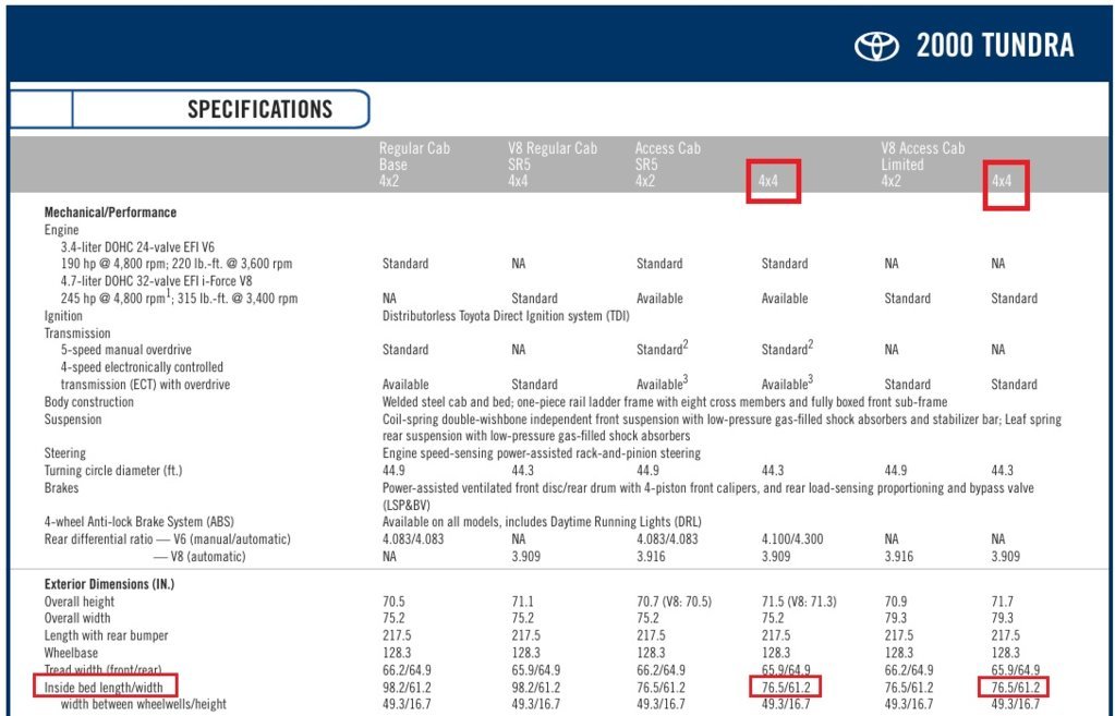

  14. Mar 19, 2025 at 6:01 AM
    BubbaW
    Aug 19, 2019
    #34845
    3,763
    Bubba
    Where Eagles Nest
    04 DC LTD 4X4 4.7 V8
    T150 Lover
    If I did, this is the figures I would have posted. What I don't know is if the brochure dimensions for bed length are measured like @CocaDonut did.

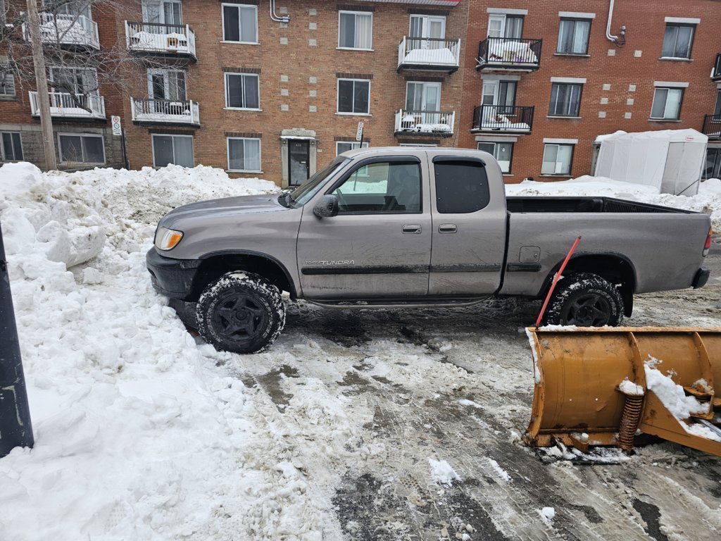

  16. Mar 19, 2025 at 6:28 AM
    CocaDonut
    CocaDonut [OP] New Member
    Feb 26, 2025
    #130989
    11
    Andreas
    2000 base Tundra Access Cab 4wd grey
  17. Mar 19, 2025 at 6:31 AM
    Sirfive
    Sirfive Master Procrastinator
    Jan 24, 2021
    #58078
    4,826
    SATX
    ‘02 Limited AC TRD
    Bassani cat-back
    Looks normal to me.
    KNABORES likes this.
  18. Mar 19, 2025 at 6:32 AM
    CocaDonut
    Feb 26, 2025
    #130989
    11
    Andreas
    That's what i thought but weirdly enough the measurement inside the bed is 74.5" inches. Unless the measurement is supposed to be outside the bed?

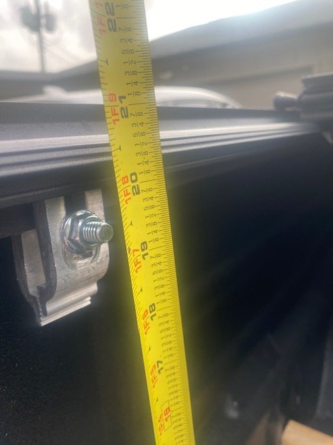

  20. Mar 19, 2025 at 6:49 AM
    Fragman
    Fragman New Member
    Nov 28, 2024
    #126540
    177
    TX
    2006 Tundra DC SR5 2WD V8
    Honestly, if I wanted to make one measurement and 'tell the difference'. it would be inside height. The DC is a fair bit taller. This is my DC inside height.

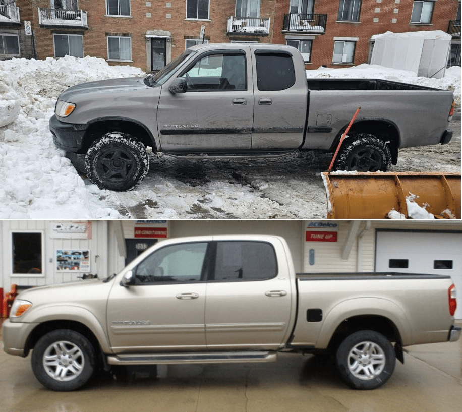

  23. Mar 19, 2025 at 7:16 PM
    shifty`
    Jun 20, 2020
    #48239
    28,377
    ATL
    They're wildly different beds and body styles, sometimes it helps to see a over/under comparison - pay special attention to the rear tail lights and that area:
    jimf909 and The Black Mamba like this.

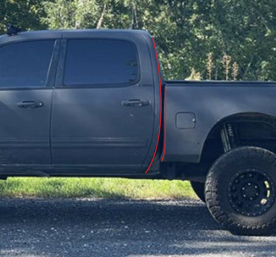

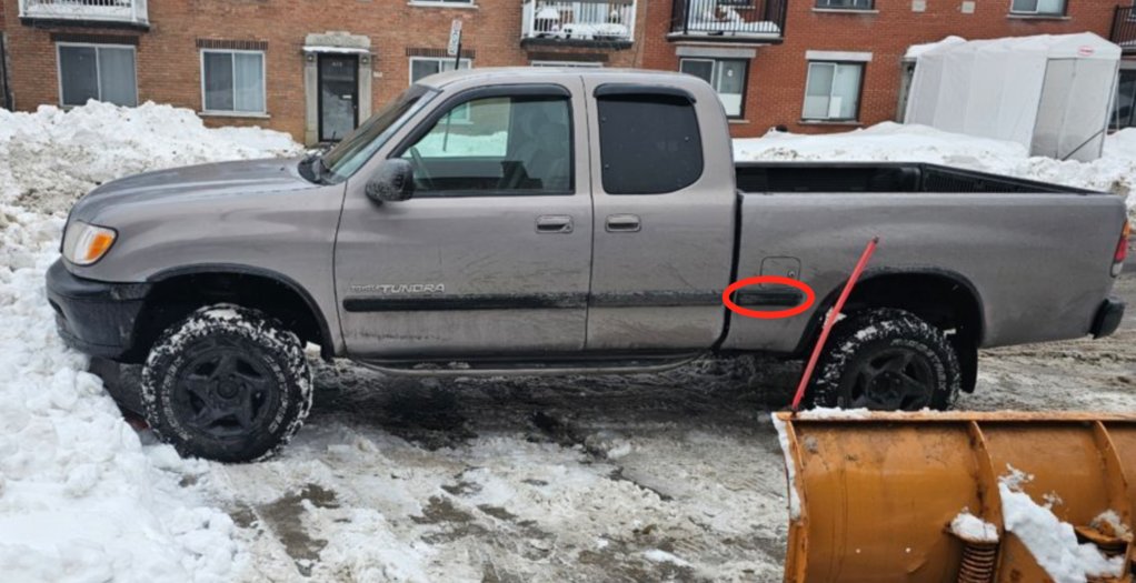

  24. Mar 19, 2025 at 7:17 PM
    #24
    The Black Mamba
    The Black Mamba He must increase, but I must decrease - John 3:30
    Sep 6, 2023
    #103472
    4,155
    Ryan
    DFW
    Black 00 SR5 AC 5VZ PreRunner
    Imma keep it stock
    The trim I circled in red is an early year access cab exclusive. That is one distinctive characteristic of a OG AC FGT.
    shifty` and jimf909 like this.
