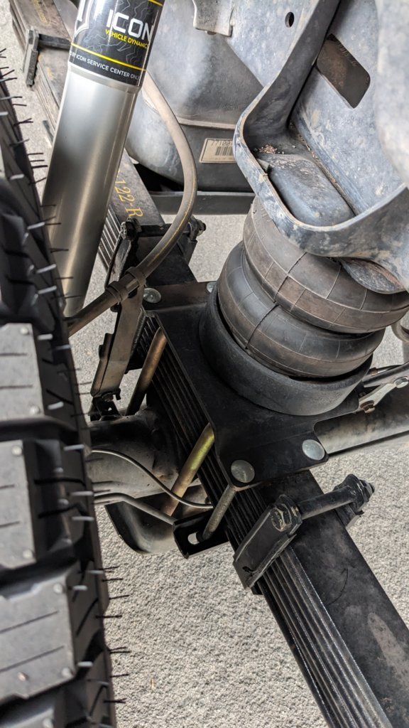

    I looked long and hard for a leaf spring setup to eliminate my airbags but after describing my loading scenarios, was told by pretty much every manufacturer (including Alcan and Deaver) to keep my bags. So I built a 6 leaf frankenpack for constant load and kept the bags for additional load.
    Looking at ride height, ride comfort, and load capacity, I think you can pick two at a time with leaf springs. If the variability in load is narrow, you shoot for all three. If it’s wider - like that camp trailer, you can pick two all the time, and the the third some of the time.

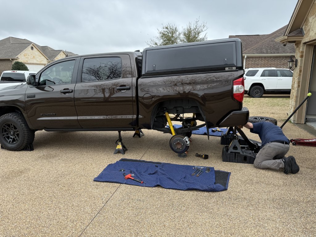

    Installed the Dobinsons Add-A-Leaf kit today to bring the spring pack up to a L59-121-R heavy constant load setup. Was TOO terribly difficult, but definitely a bit challenging at times. Especially since it did not come with any instructions and also because either Dobinsons, ExitOffroad, or the delivery service (can't remember if it was UPS or FedEx) left out one of the four white plastic bumper/spacer/silencer disks. Luckily NAPA had a similar replacement in stock, but it added about an hour and a half to the job, cost me some money, and isn't quite the same as what it should have come with. In the end though, I'm happy with the outcome. Added about 2" of height to the rear for a final rear/front rake of 2".

    Did you say adding the 1 extra leaf added an additional 2” of lift?

    2020 Smoked Mesquite Platinum 4x4
    Yeah it’s a stiff boy! Maybe it’ll settle a bit over time. But I’m good with it. Doesn’t seem to ride too harsh either.
