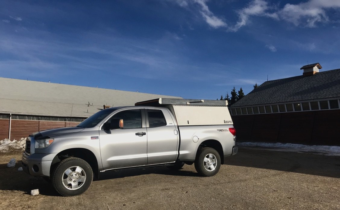

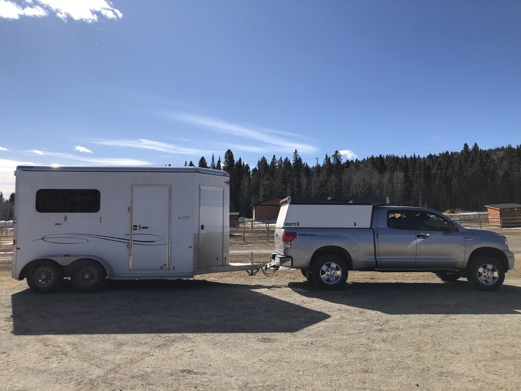

    Hey everyone, just thought I would chime in with my recent findings. I originally wanted the 6112/5160, but since being sold out everywhere, I picked up some twin tubes and 778 coils w/ the rear shocks. Since the truck is not my daily driver, I've only had a chance to put 200 miles on this setup, and they've settled quite nicely! Like many have stated before, the ride is stiffer when going slow, but big bumps are smooth when going faster. The truck doesn't feel like a whale in the turns and much more planted overall. I do have an appointment made to get the rear leafs worked on, so there is a slight bit of rake for now. I'm sure I'll see some more settling but just wanted to show some somewhat good news in a seemingly spiraling thread lol
    Tire size is 275/70/18
    ~Stock~
    • Driver- 22 1/8" / Passenger - 21 7/8"
    • Droop: Driver - 26" / Passenger - 26"
    ~778 Unsettled~
    • Driver - 25 1/2" / Passenger - 25 1/4"
    • Droop: Driver - 27 3/4" / Passenger - 27 5/8"
    • 3.375" Lift post install
    ~778 w/200 Miles~
    • Driver - 24 1/2" / Passenger - 24 3/4"
    • Roughly 2.75" Lift after 200 miles
    Before:
    After:
    Adding a spacer up top has nothing to do with the preload, at all. Whenever you are moving the spring perch up, the spring will preload. People install CB shims to either correct for lean, or add height without changing how the spring behaves. Adjusting for lean with clip height is a terrible idea.
