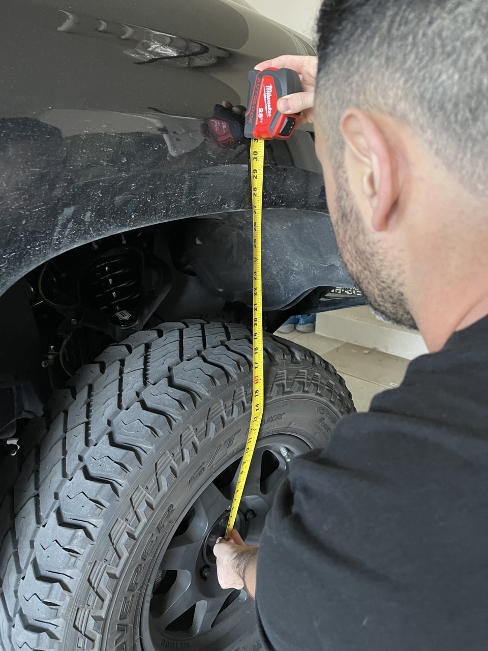

    these are the 778s on 2nd clip— should give 2.5 inches of lift.
    finally got my wife to hold the camera while I measure.
