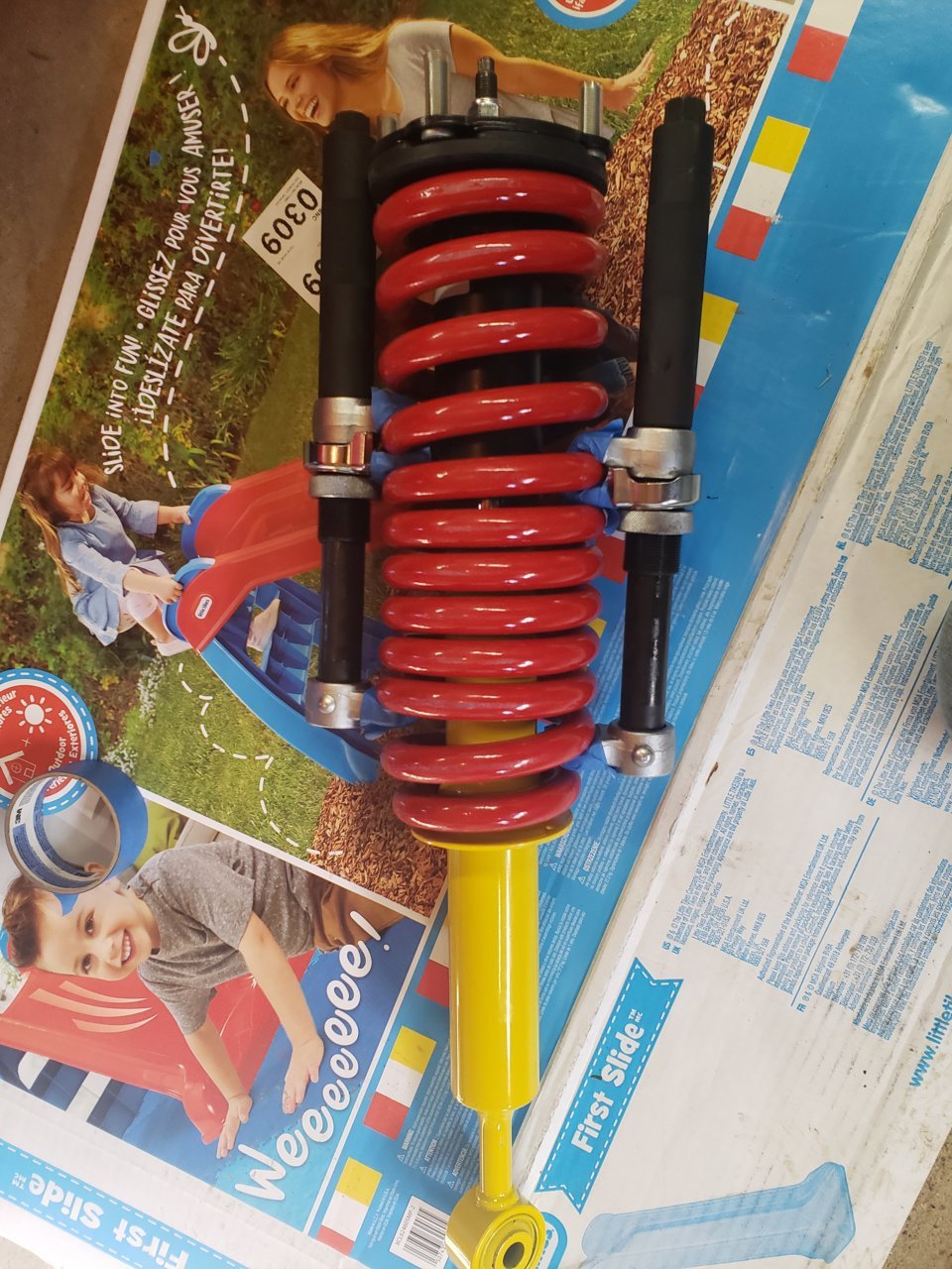

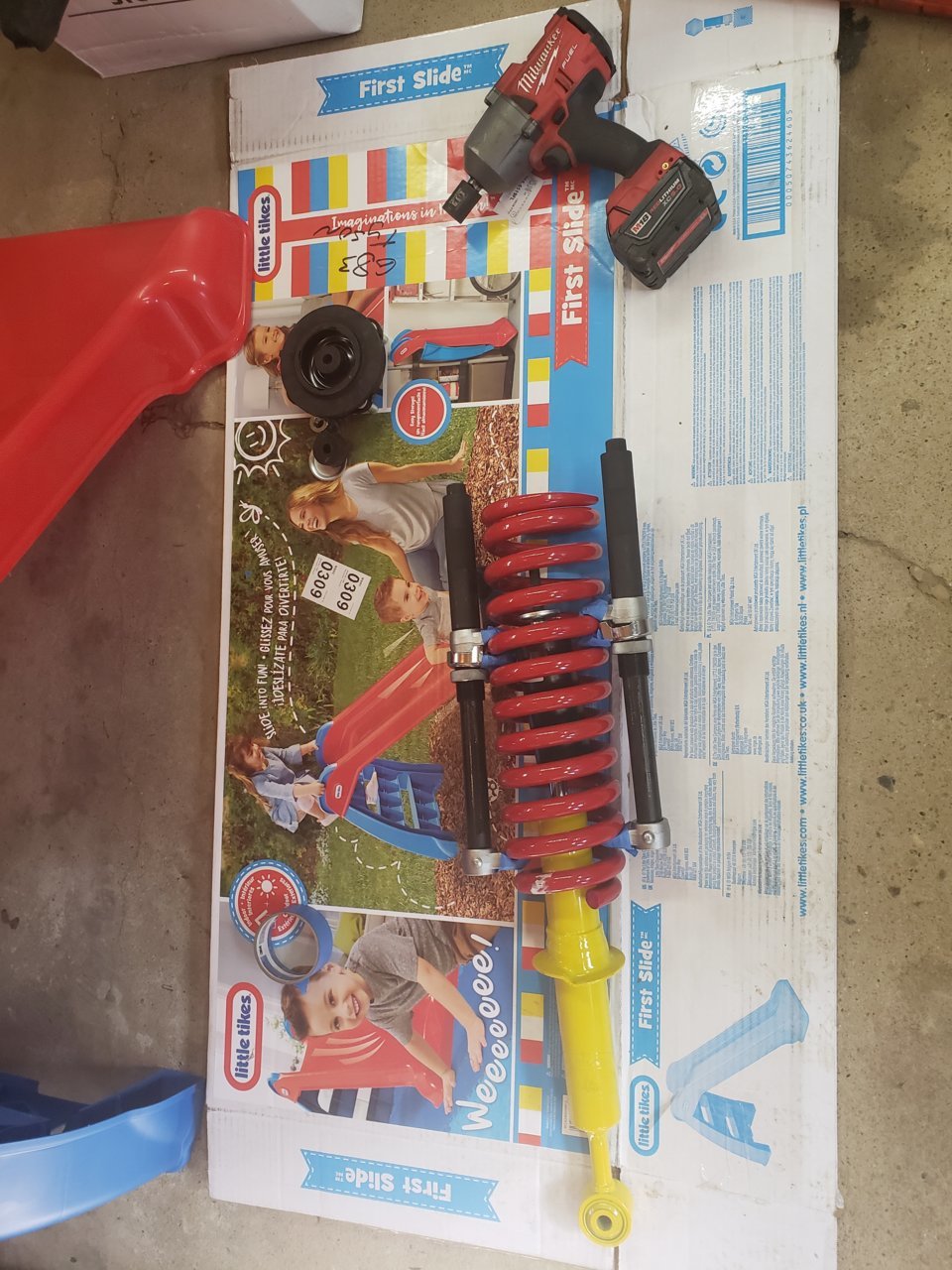

    Well, the build is going well so far lol. These SPC spring compressors are actually really legit. Totally different animal than your typical auto parts store rental type.
    I should get the struts mounted within a few weeks, so I'll post up again then.

    I just bought a set of those SPC compressors myself to try out. Now seeing that it can handle the Tundra springs, it will have no problem on my 4runner coils.
    Rica25 likes this.

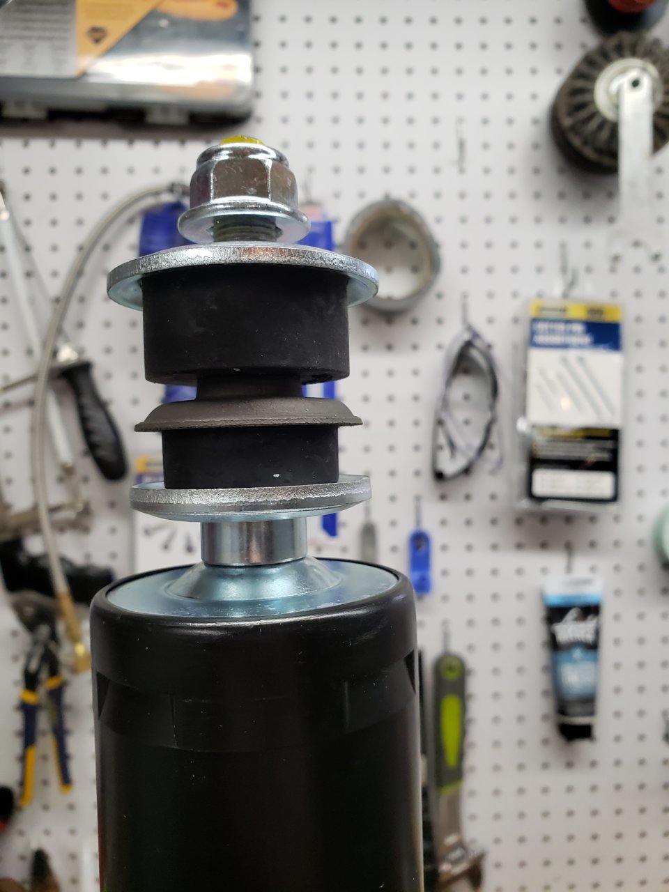

    While I have you here @crikeymike , I'm assuming this little spacer between the dust boot and the lower washer stays put, correct? That's how I'm building them but figured I might as well double check.
    Rica25 likes this.
  17. Mar 19, 2021 at 1:18 PM

    Yes, that's correct. It's to give the proper spacing on the bushings and washers up above when installed in the mount, and also maintains the down travel in the strut.
    Yeah, #1 problem with a lot of compressors is not being able to get the jaws out once the spring is in place. I'm testing these out as a way to adjust IMS or MRA struts that have already been installed, so that the seat height can be changed. Will be messing with it this weekend I think.

    However the spring compressors are a bust lol. Can't get them out from in-between the coils. I'll still keep them for future projects though since they are super stout.
    Looks like I'll be dropping these off at Main Line whenever I can.
