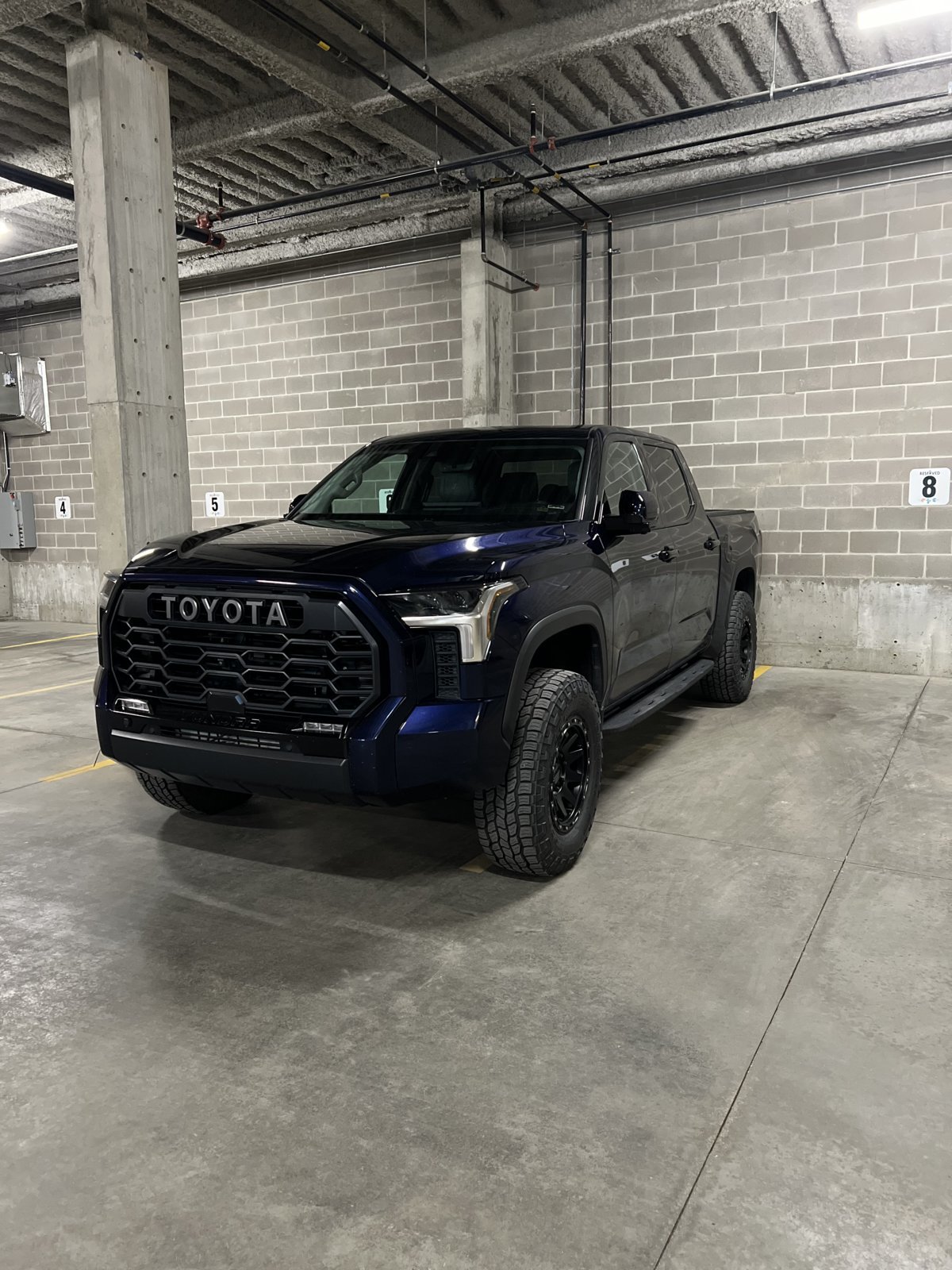

  14. Jul 11, 2024 at 8:35 PM
    Yaboy
    Yaboy New Member
    Mar 18, 2022
    #76004
    477
    Canada
    22 limited off-road
    That’s not my truck but I have 2866 rear springs like that one pictured. I don’t remember posting that, what are you looking for?

  16. Jul 12, 2024 at 10:45 AM
    Yaboy
    Yaboy New Member
    Mar 18, 2022
    #76004
    477
    Canada
    22 limited off-road
    I bought those for the price and availability. They lifted 1” and tires added 1” 295/70/18, I was parked beside a 24 limited at work and my truck was quite a bit taller then stock. I would like to add the panhard bar, AFE rear sway bar and the TRD pro front sway bar with links. The parts I did get are: Elka 2.0 front coilovers, eibach springs and TRD 3” lift UCA set to 2.75” lift. Rear dobinsons IMS 2.6 with OME 2866 springs, extended brake lines and icon bump stops front/back. I think it’s a great setup for 5k cnd and I’ve used it as a daily driver for a year and a half like that with no issues. I have a post in this thread with all the pictures, here’s a recent one of the truck it sits level.
