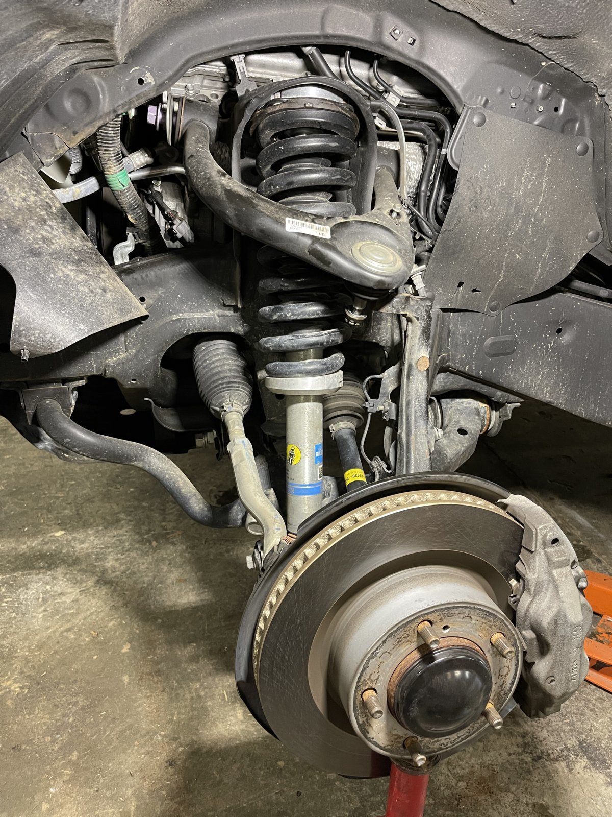

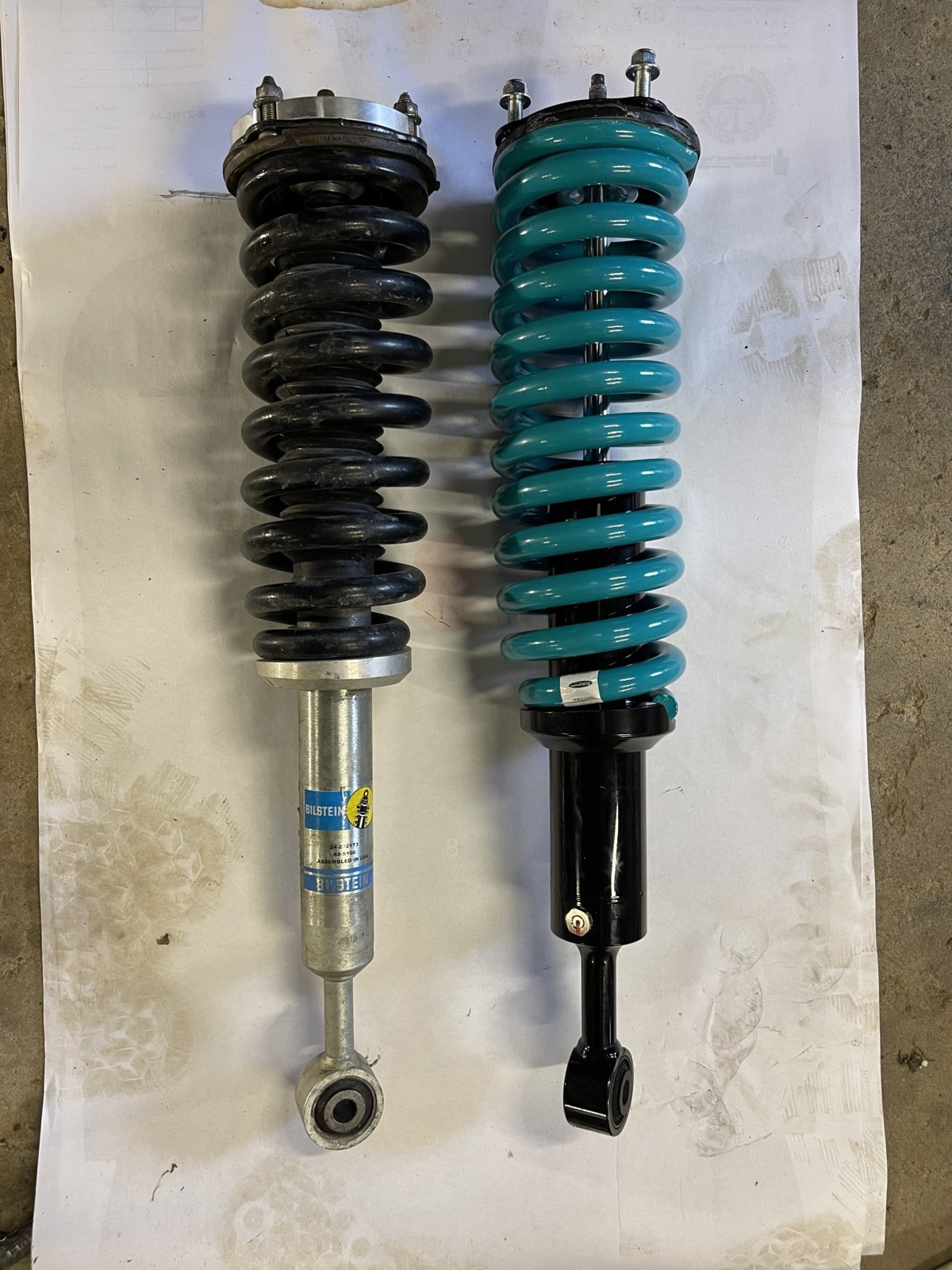

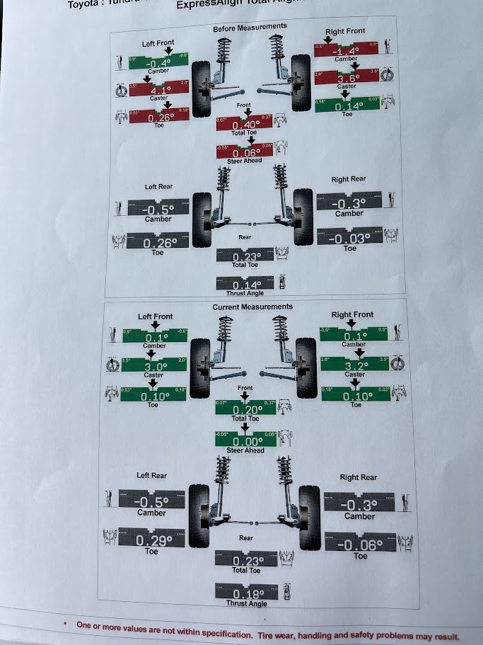

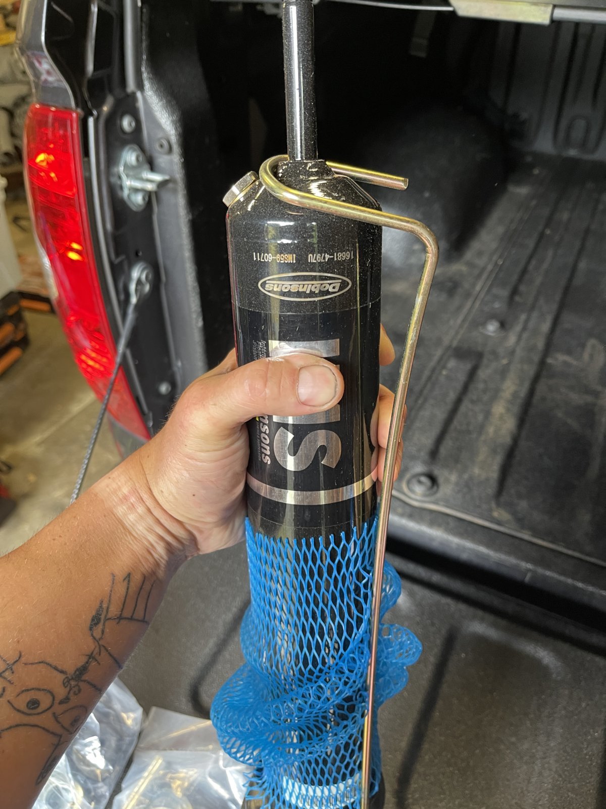

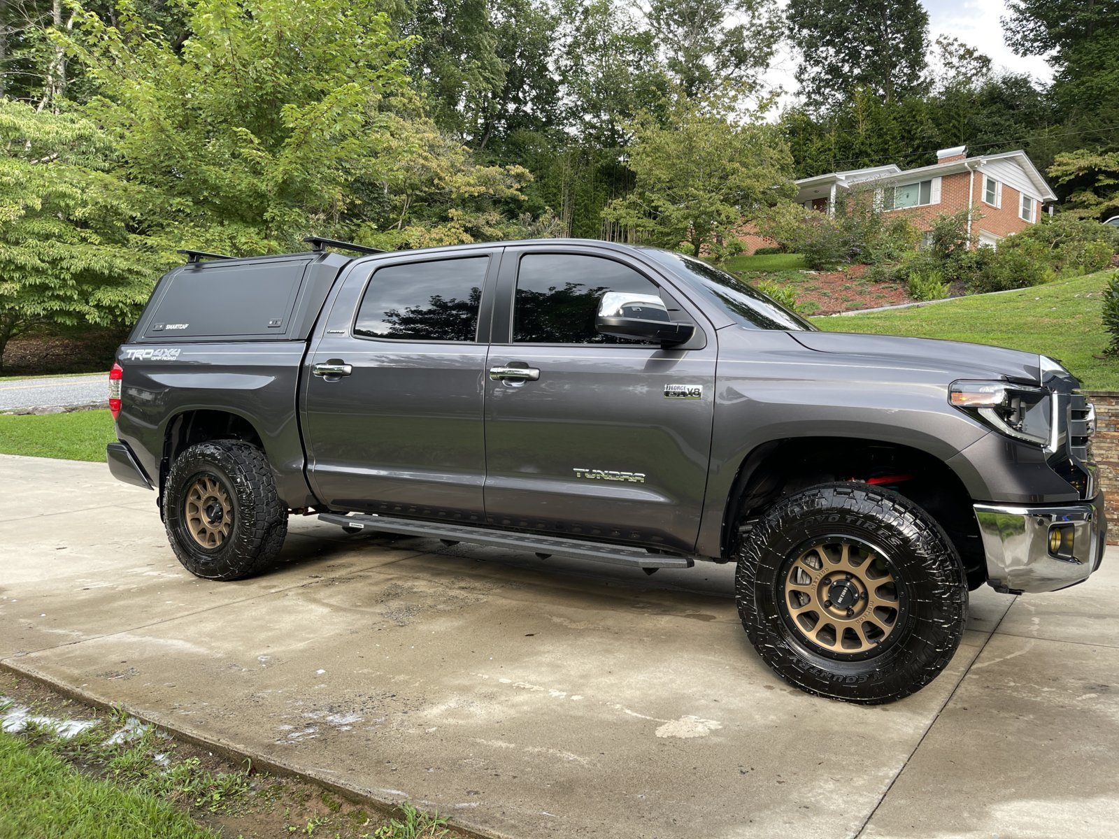

    Installed the IMS over the weekend. The difference in ride quality is night and day. I previously had the Billstein 5100's, stock spring, and Westcott collar Lift, no UCA's. This thread, and the forum in general, definitely helped me make my final decision on suspension. JBA and Dobinsons IMS for the win! Stock weight spring 3". Had to do a garage/tape measure alignment just to limp it to the shop.

    Sure. It rides like a truck. Stiffer at slower speeds and very smooth at higher speeds. Prior to switching, the collar lift with no UCA's felt like the truck was on its tippy toes. Very twitchy and harsh. Highway bridge transitions were rough. Now everything feels more relaxed. Still stiff but in a performance sense not an uncomfortable sense. Im using stiff in a positive way if that makes any sense. The truck feels very composed and tows very well in combination with the firestone airbags

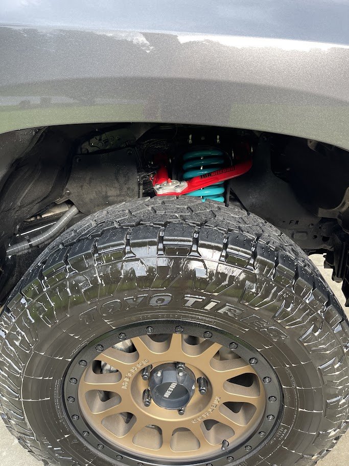

    Your setup looks great @brevard828 , finally some solid pics showing a finished setup...along with a useful review!

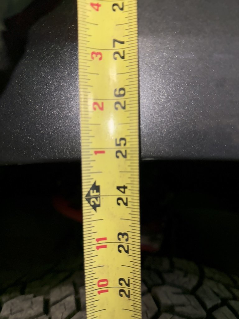

    I can get you a measurement when i go home for lunch. As far as the settlement there is almost none. I recently installed the RCI arapaho bumper (125 lbs) on the stock load springs, and have not noticed any additional settling.
    As far as the rear pack, I bought the greasable pins, and just re-used the rear stock shackles. Which in turn does not allow you to use the greasble pins but I greased the bushings and just slid them on. no issues so far. This is the rear measurement from hub center.

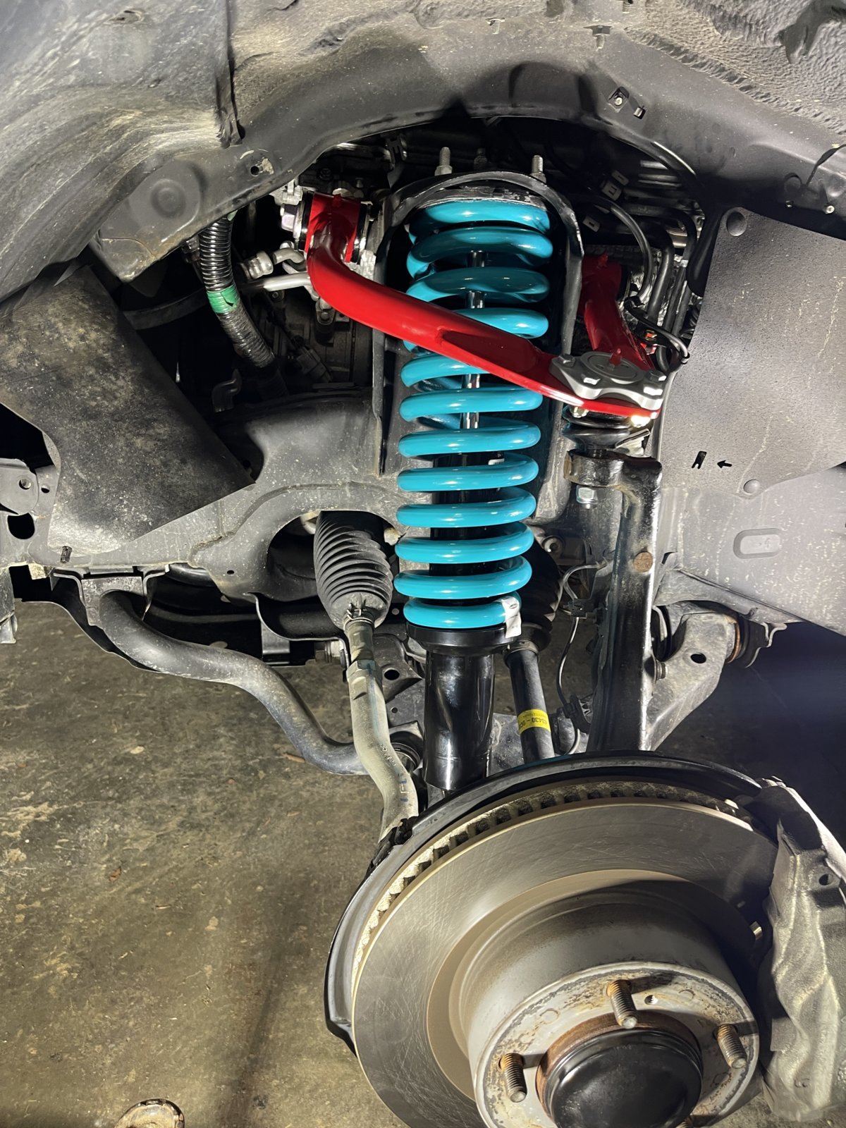

    Heres the driver front measurement. Hub Center to fender 24 3/4
