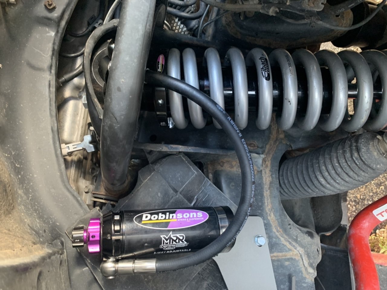

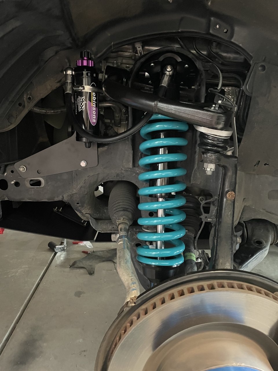

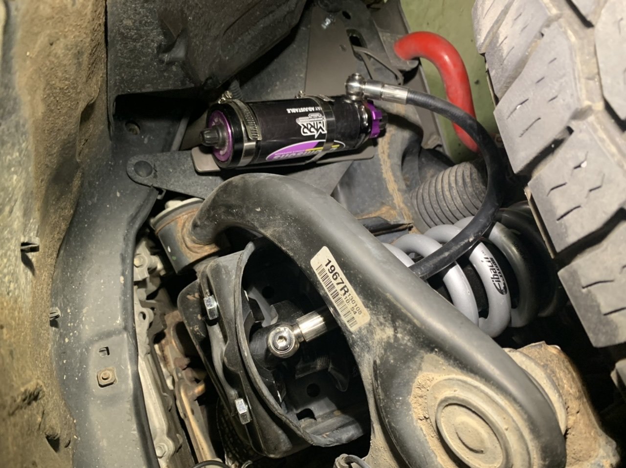

    I FINALLY had a minute to install the front’s. It was… umm… fun… ha. Had to sneak up on clearancing the lower control arm pocket on one side which meant I had to pop the shock foot in and out of the driver a few times, but the second side went pretty easy.
    I did have a question about the hose routing for the front remote reservoirs. I followed the example on the website but I feel like the front wheels may rub the hoses at lock. I haven’t even pulled it out of the shop for a test drive yet, but I’ll check later today. The hose also contacts the inside of the upper control arm on full droop. It doesn’t pint the hose, just hits in
    I also have a small gripe about the reservoir mounts: A coupe of riv nuts would be fantastic for the mounts. Secondly, the worm clamps feel and look a little chincy.
    Otherwise I’m excited to see how this thing rides!

    You're supposed to run aftermarket UCA's with more clearance, so that nothing hits that hose. Plus you won't get the extra travel the coilovers give without them.
    You'll have to turn the wheel and make sure the hose isn't hitting anything, then rotate the body of the resi to turn the hose further away if needed. You can loosen those clamps and raise it up as well to gain clearance.

    Hmm. I don't recall any of the literature requiring new UCA's - except in the case of more than 2.5" of lift as is standard fair for Tundra's. I'm aiming for about an inch of lift.
    From your website:
    • Note about lift heights – all vehicles can have some variance and desired lift height may need to be adjusted to suit your specific vehicle. Adding 2.5″ or more lift, new UCA’s should be added for proper articulation and correct wheel alignment

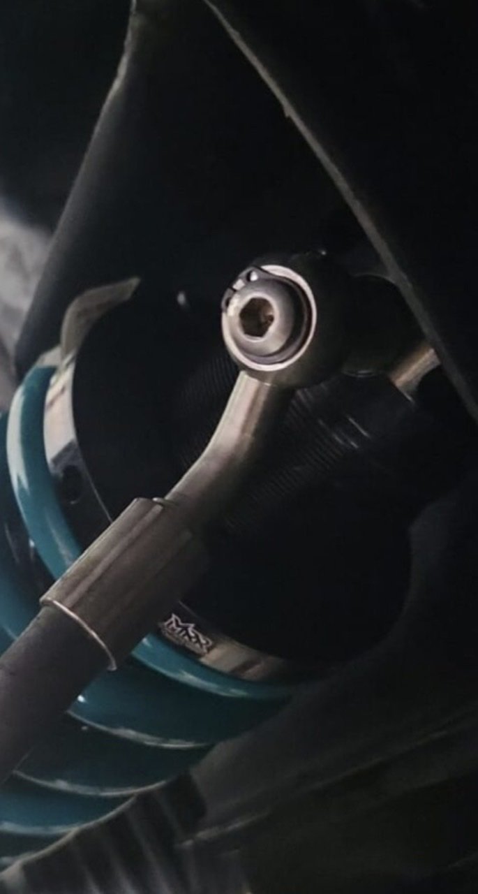

    On install, I rotated the reservoir more but it actually pushes the hose out further in to the path of travel. We'll see where it ends up, I guess.

    Adding 2.5″ or more lift, new UCA’s should beadded for proper articulation and correct wheel alignment”
    I read that to say, if you have less than 2.5” of lift, new UCA’s are not necessary - same as virtually all other lifts for the tundra in order to correct alignment issues that keep camber an castor from being in spec at higher ride heights. Most UCA’s have around 4 degrees built in to them; being at only an inch or so of lift, I wouldn’t need the camber/castor correction.
    RJVA likes this.

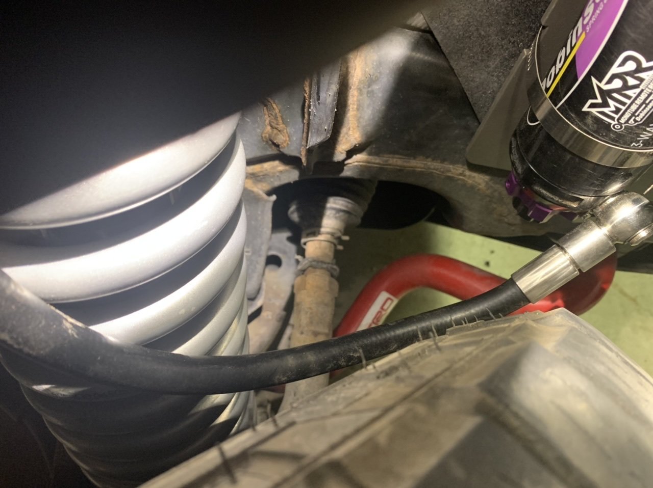

    Tires will definitely make contact with the hose and reservoir where they sit now.
    Also, I notice that the hoses on my set are straight where they mount to the shock body and don’t have a kink in them like the website example.
  15. Jul 25, 2023 at 1:48 PM

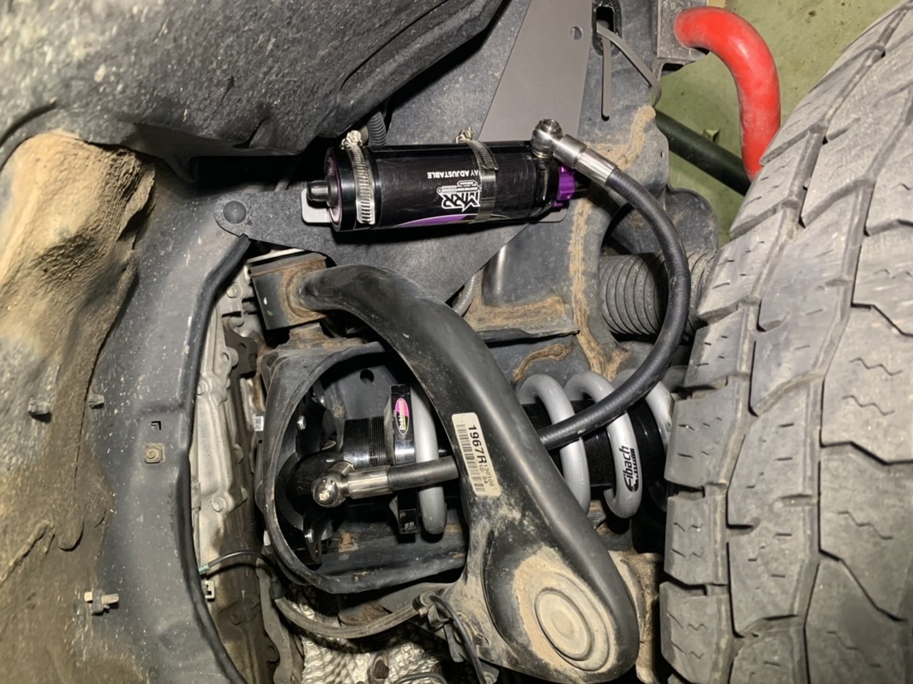

    I’m not seeing how to make this hose hide without rubbing something. Rotating the reservoir to the right pushes the hose in to the tire. Rotating it left pushes the fitting in to the tire. Rotating it 90 degrees to the left would kink the hose.
    Stock wheels, stock tire size.

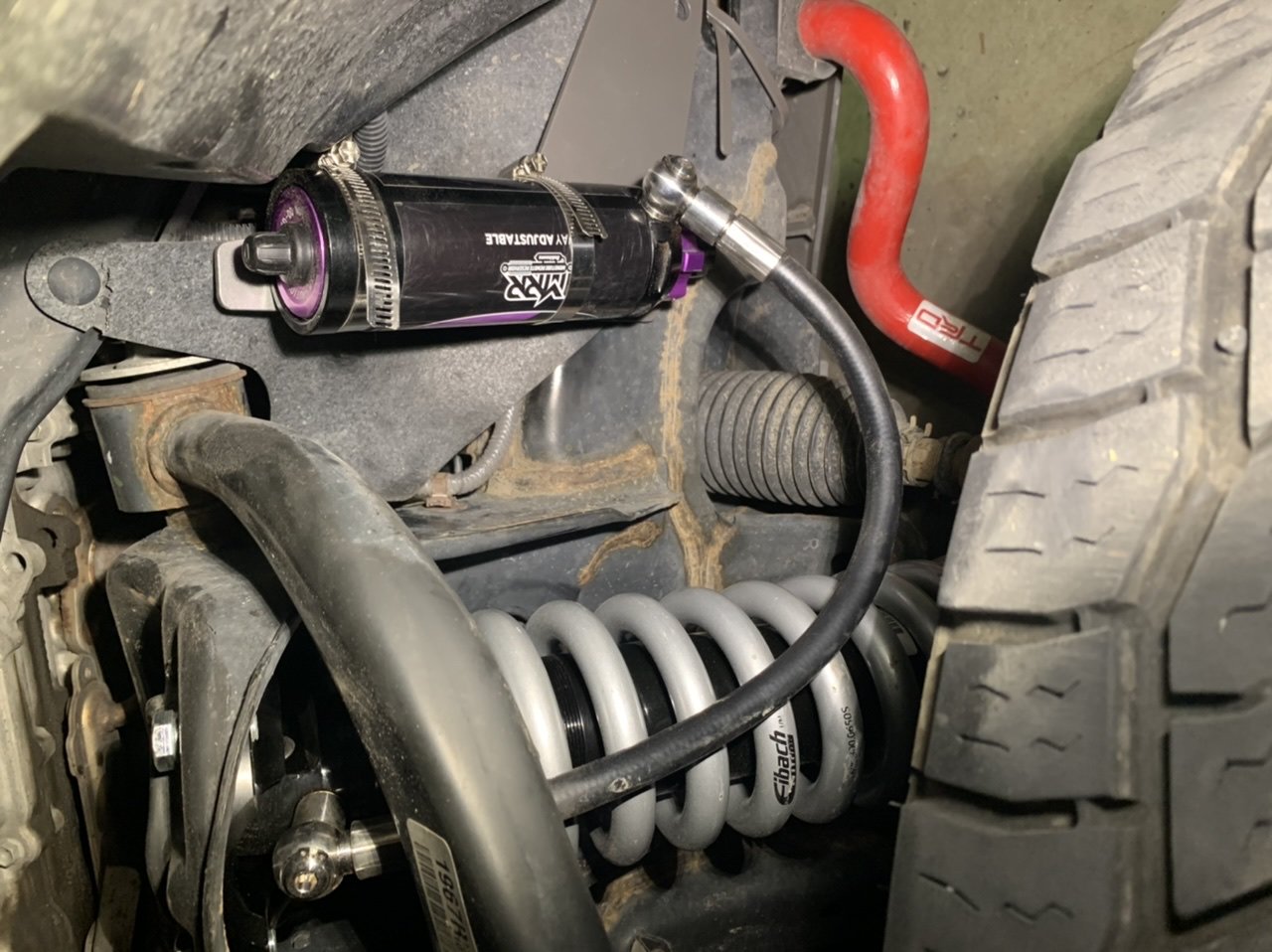

    Flip the resi like the other guy did. You don't have the extra droop from new UCA's, so you shouldn't have contact issues with the hose. You could also raise the resi up from its current position, but it doesn't look like that will be enough in your setup.
    The hose can rotate in every direction, the fittings on the resi can rotate 360 on the hose and 360 on the resi end. As shown in this video:

    Thanks. I Ended up coming up with the same solution before I checked back here.
    The top clamp interferes with the hose a bit so I’ll end up reworking something somewhere. I might pick up a few coilover top mount brackets and place it over top of the coilover but I do like the location of the adjusters much better as they sit now.
