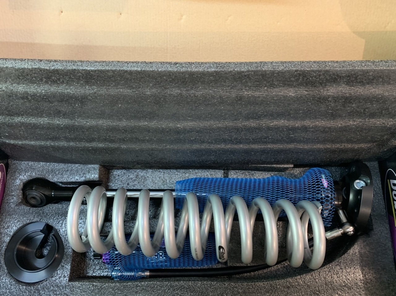

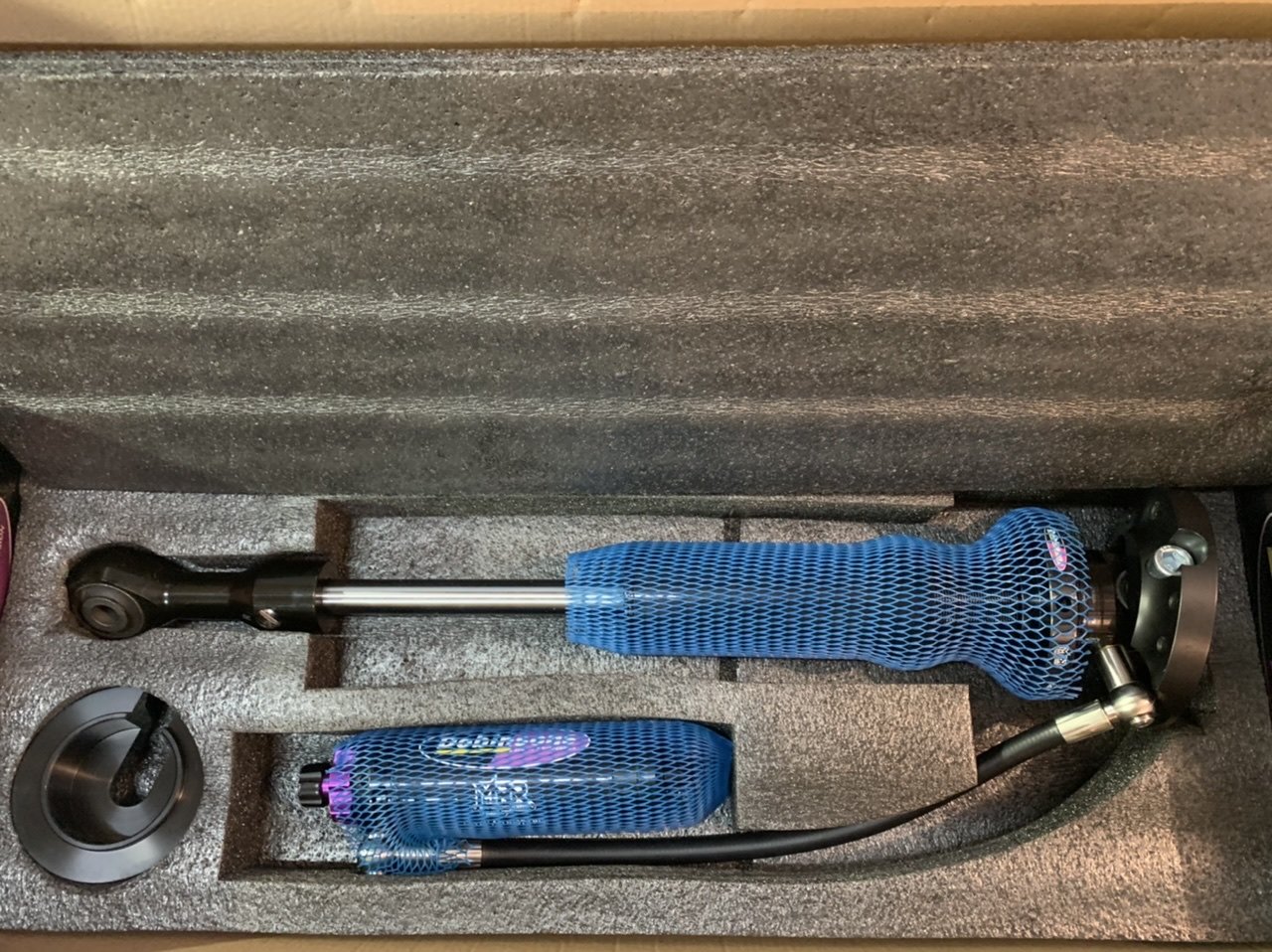

    I was working out of town last week but look what showed up!
    Decided to go with sleek silver instead of tenacious teal coils. Guess we’ll see how they look and ride.

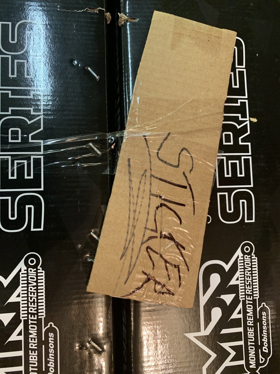

    And as an added bonus… STICKERS!!!
    And in the mail a few days later… MORE STICKERS!!!

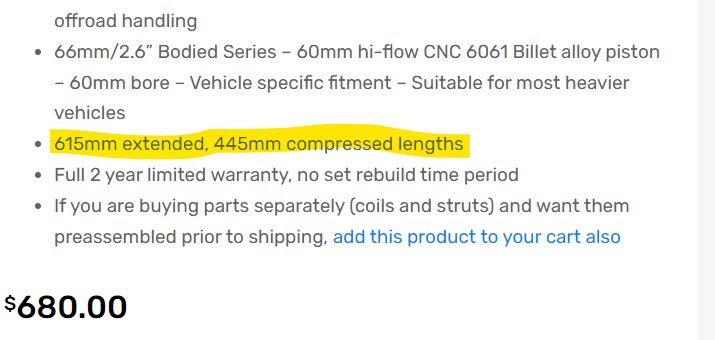

    I no looked on the page and I did not see anything regarding the compressed length

    For IMS, 2007-2021 Tundra:
    Rear: 642mm (25.3") extended, 401mm (15.8") compressed lengths
    Front: 615mm (24.2") extended, 445mm (17.5") compressed lengths

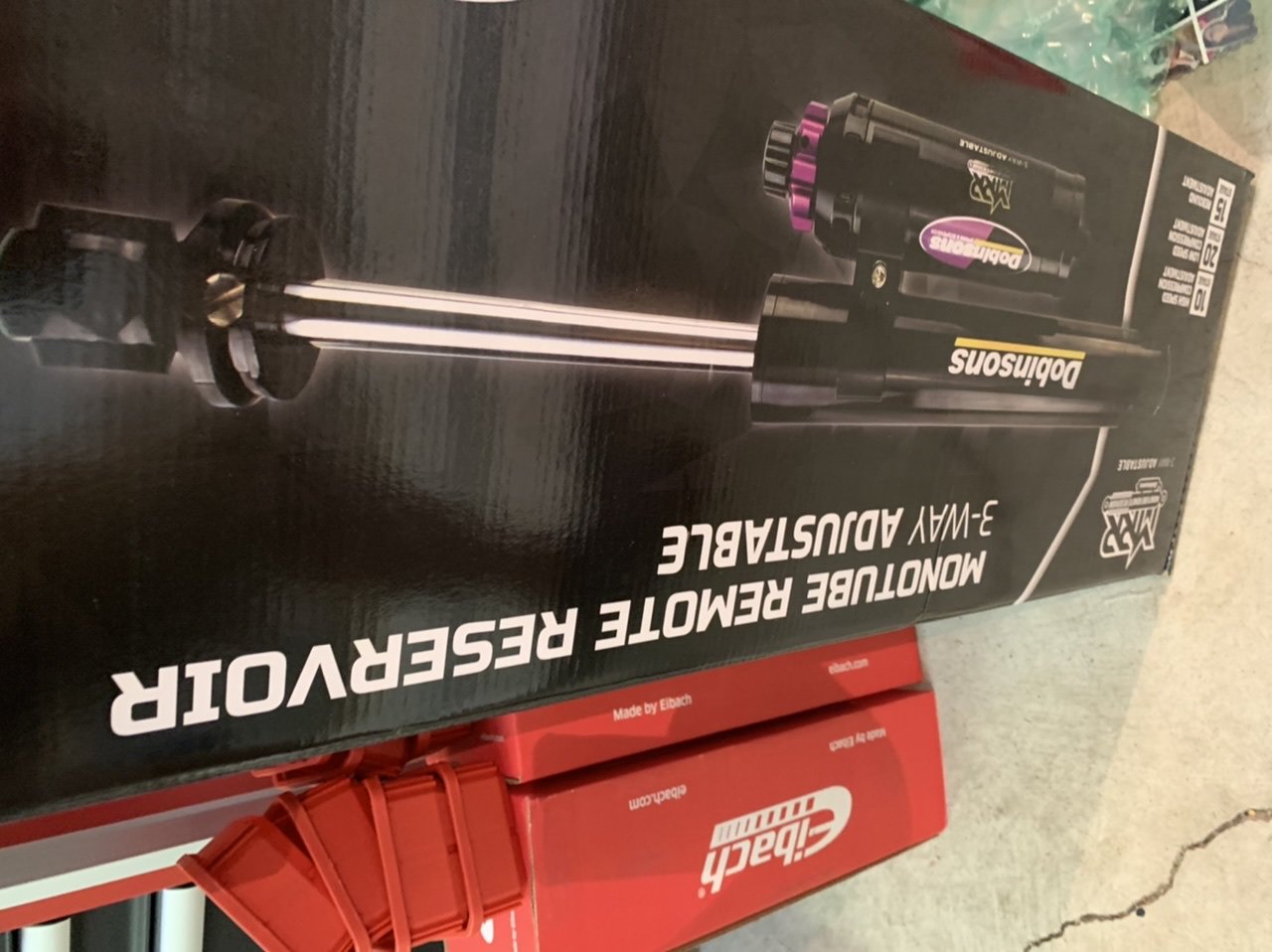

    Got the fronts on!
    crikeymike[OP], rruff and blenton like this.
