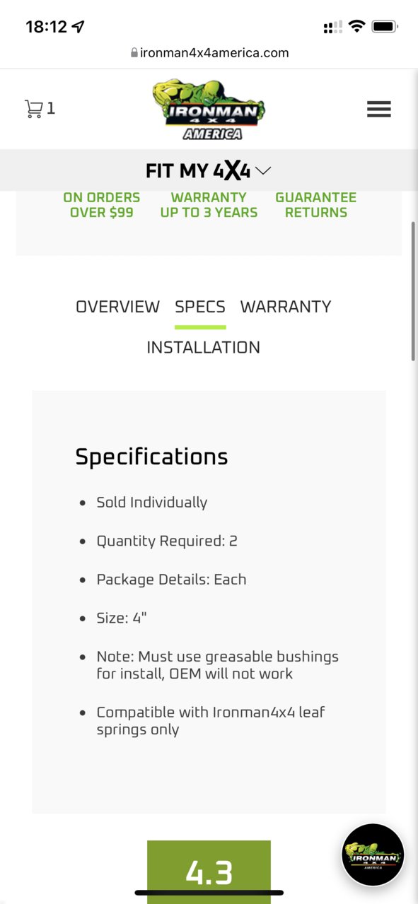

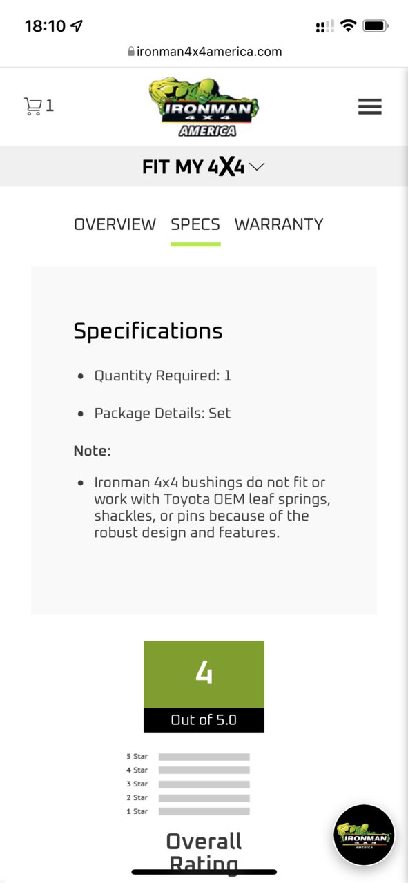

    Are you sure the Ironman bushings and shackles work with Dobinsons leafs? Dobinsons says their leafs use the same size bushings as Toyota OEM but then I saw this on the Ironman bushing product page: DA2CE0F1-88BD-4F59-8854-7941EE8B1267.jpg
    And this on the Ironman shackle product page:

    Dobinson's springs, IM bushings and shackles have been on my truck for about a year now, so yes I'm quite sure the combo will function as designed. Pretty sure IM is just trying to market their products in their favor a bit.
