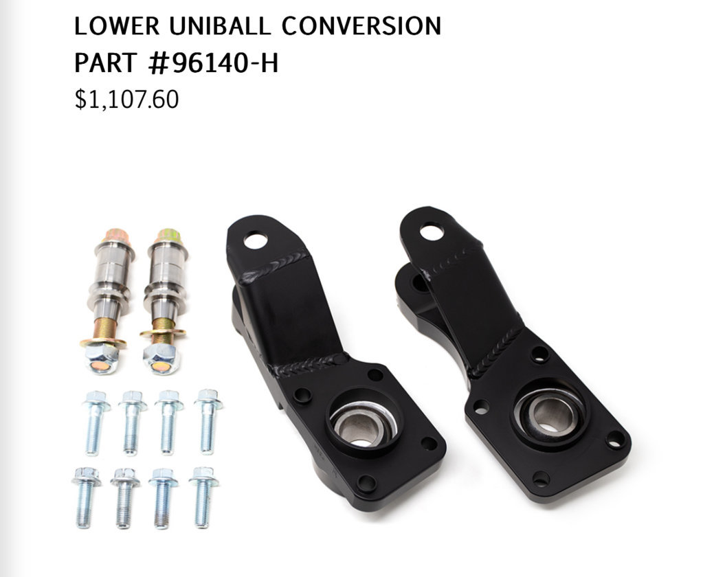

    Anybody have review for lower uniball set-up?

    I haven’t heard of anyone on here complain but that’s typically the long travel suspension crowd or group due to the cost.
