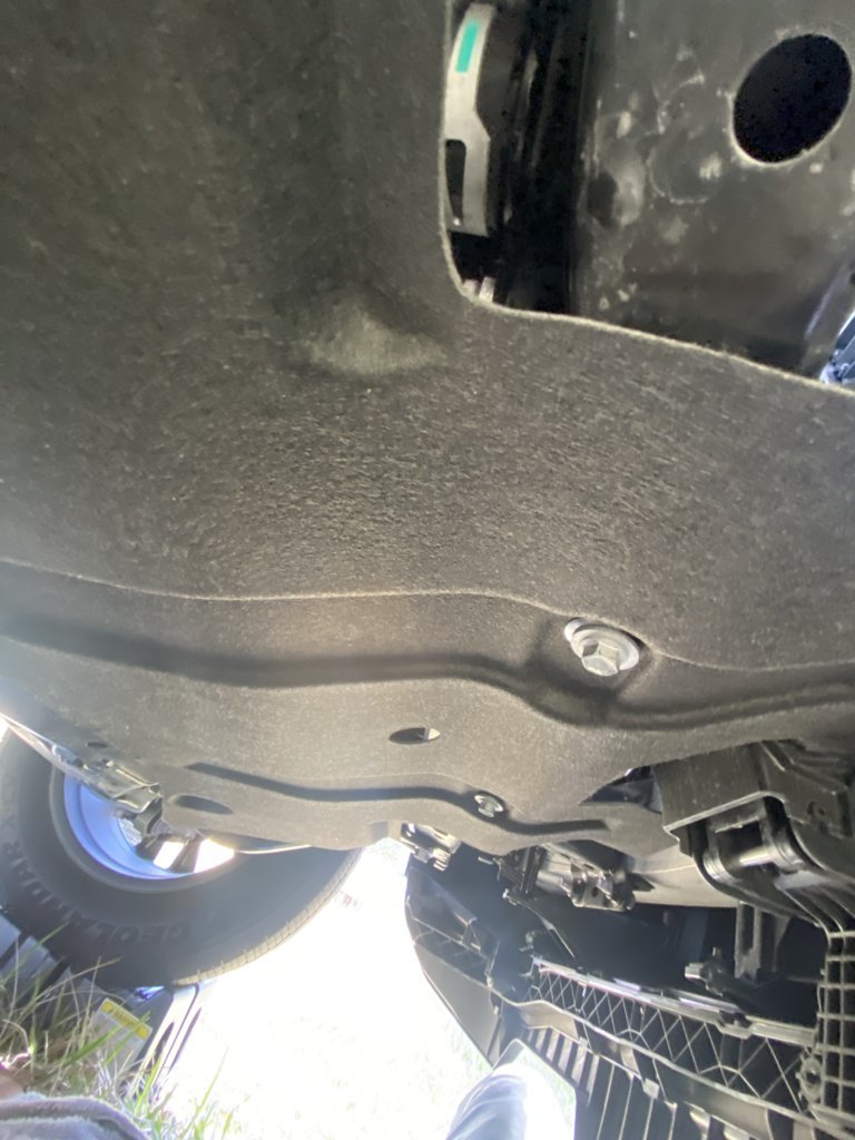

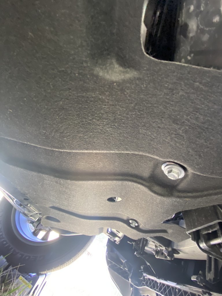

    2024 Silver Tundra TRD
    Well, changed my first oil yesterday. Here are some things I learned:
    -The oil drain plug (supposed to be tightened at 30 ft/lbs) which i expected to put some real elbow grease/torque to loosen, was barely lightened. I was surprised it was not leaking, changed oil at 5012 miles
    -The oil filter was just the opposite. I needed a pair of channel locks to remove it. I hand tightened until seal was really snug, then did 3/4 revolution more.
    -The box of 10 tundra OEM oil filters i bought from dealer DID NOT have the oil
    Pan bolt washers in it as they said. So, i used the old one and tightened to 32 ft/lbs instead of 30 ft/ lb spec.
    -I used my rhino ramps to raise and i Aldo needed a foot stool to comfortably reach engine oil cap (I'm 6'4")
    -QUESTION: The skid plate/guard is completely diff on my 2024 vs what I saw in the enclosed video. It's a very light, flimsy piece of what seems like cardboard & felt. What do you other owners of 2024 tundras have? (SEE PICS) Also, plz see the beginning of the video link for a much more robust skid plate. When did these change to the cardboard ones?
    much better skid plate seen in first part of video:
    https://www.youtube.com/watch?v=4a3SKCVD6Ek

    24 Limited, 21 Redeye
    Yeah, I wouldn't call that a skid plate. It's just a flimsy cover, probably more for aerodynamics than anything else. That's what most come with.
    It's prob due to cost; which the former is much more durable and tough, if this ever hit anything on the road, it would be destroyed.

    @tstex
    What you have is standard equipment. Consider it a splash shield, not a skid plate. Keeps the slop accumulation to a minimum.
    TRD skid plate (aluminum) is an extra cost option except on TRD Pro.

    2012 SR5 TRD OR (prev) 2025 SR5 TRD Rally (now)
    The one on my 25 is a composite plastic, not felt.
